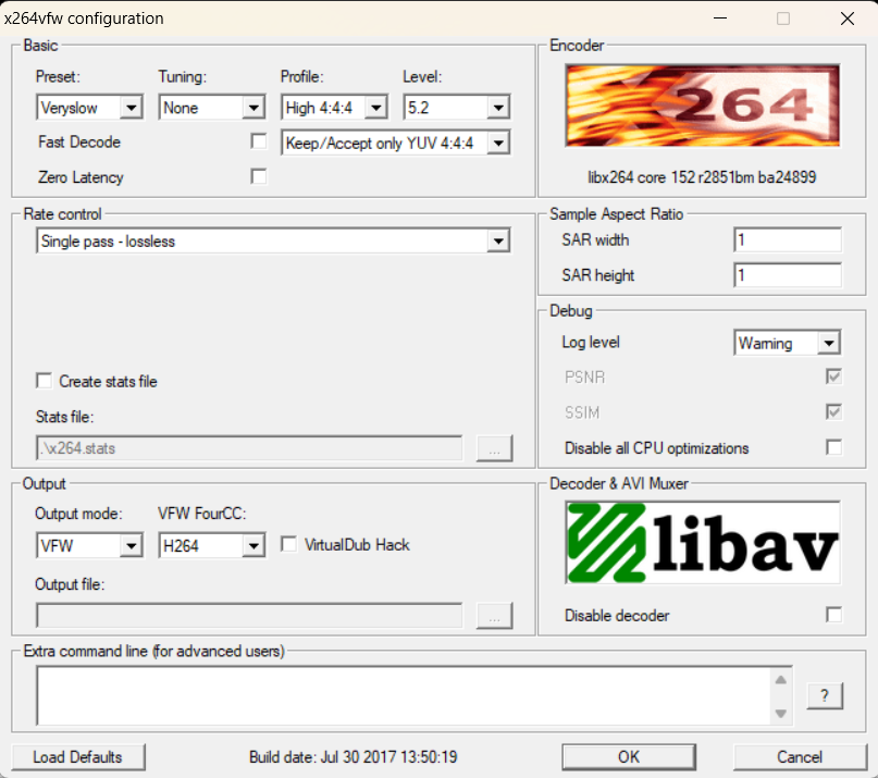

    I'm trying to use AmarecTV again, but I'm having issues with it. When I used x264vfw, the video never records at all and instead gets an error that says "
    x264vfw [error]: incompatible input/output frame format (encode)".
    Here are the settings I'm trying to use:
    [Attachment 74572 - Click to enlarge]
    And even when I try to use other codecs like Lagarith, I get super laggy video.
    Is there a way I can fix this? Or is there better software for me to use?

  3. x264 is lossless with --qp 0 or --crf 0. It is just sometimes discouraged to using it for archiving due to compatibility concerns.
    You can try as below with x264vfw configuration:
    - Set Profile and Level to 'Auto'
    - Output mode to File, FourCC select x264
    - Specify an output file
    - Single Pass - lossless will set --qp 0
    or better select another lossless codec (Huffyuv, ffv1, UTvideo, lagarith ...).
    .mp4 .mkv, or .avi are just containers and have nothing to do with lossy or lossless.
  4. I can capture to both x264vfw and Lagarith with my Hauppauge USB Live2. You don't say what device you're using to capture with or at what resolution? Plus, you might want to tick the 'Zero Latency' box and the 'Virtualdub Hack' box - I don't think this will solve your problem but I'd tick them anyway. Also, the 'VerySlow' preset is probably not a great option for capturing, especially when it's supposedly Lossless. Start simple, get it working THEN start turning up the settings until you find the point that it's no longer giving smooth video with in-sync sound.
    In the Lagarith settings, I seem to remember that there's a setting labelled something like 'Hardware encoding' or 'Multi-thread' . . . ? (I'm not sitting in front of a machine with AmarecTV installed) I ALWAYS had problems with this setting enabled.
    Final thing, you are using AmarecTV v3.10 or earlier, aren't you? Anything after v3.10 makes you use their bespoke codec.
    Yo, I tried your method, and YAY! It works! Deinterlacing with QTGMC looks so far, so good too. But there's one problem, why no sound??? I have it connected through S-Video, and it has audio options. I tried both of them, and even left the volume on my PC on while recording, but there's still no audio. Is there something I'm doing wrong?

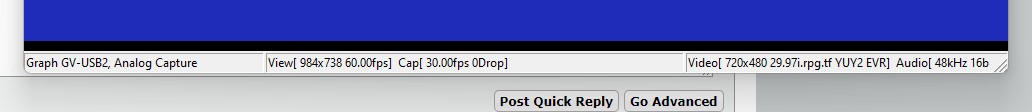

    When you have AmarecTV open and your GV plugged in (not capturing), what fps is shown at the bottom of the window? Mine is ~29.97 bouncing around a little eg 29.3 to 30):
    [Attachment 74648 - Click to enlarge]
    Try typing in 29.97 on the Recording tab.
    Try using another codec; you probably have YUY2 there, try that just for a few seconds. It's an uncompressed format so the file size will be huge but it might isolate the frame rate issue.
