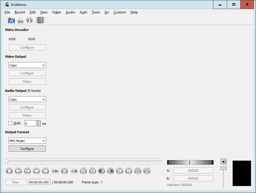

AviDemux shows you the frame type at the bottom of the window:
[Attachment 74558 - Click to enlarge]
It will show I, B, or P. -
