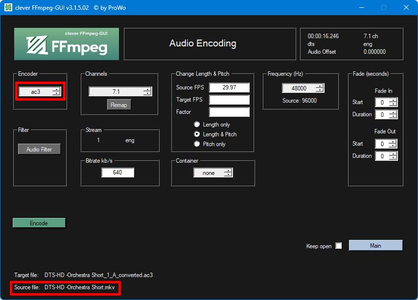

    OK I did some further testing and now I am getting the same file sizes out of several programs so I have no idea what happened earlier. ProWo, I really like Clever FFmpeg-GUI and I would like to use it but I am now experimenting with aac encoding instead of ac3 and I cannot seem to set a different bitrate. The box says 384 as the target average but I don''t see a selection box or if I manually change it to 448 or 620 nothing changes and it still comes out at 384. Am I missing something?
  11. Originally Posted by Ronstang View Post
    The minimum recommended bit rate for the selected configuration is displayed in the text box.
    If you enter a higher value here, this value will be used for encoding.
    You can easily check this in the output file with Mediainfo.
    No bitrate is displayed for aac, as aac is known to do variable encoding. However, you can see from the size of the file that the higher value has been used.
