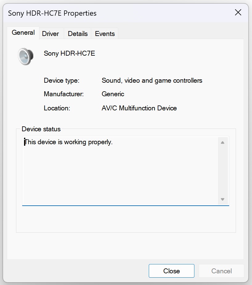

    I couldn't find that exact setting in Win11, but camera is enabled and also the option to allow desktop apps to access the camera.
    The camera appears in device manager and is shown as working properly.

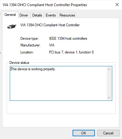

    Go to Device Manager and see if there is IEEE 1394 host controllers.
    Click > and > VIA 1394 OCHI Compliant Host Controller (I am a firewire card with VIA chip. It may look slightly different if you have a different card.)
    Right click on it and you will see this.
    [Attachment 74562 - Click to enlarge]
    If you don't see this then you need to install your firewire driver.

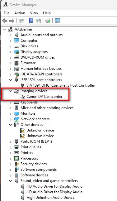

    @Piplyn,
    In Device Manager you should see this when your camera is plugged in and in DV mode (note my IEEE1394 entry is the native Win 11 Firewire setup with a VIA card; yours may be slightly different):
    [Attachment 74573 - Click to enlarge]
    If you don't see your camcorder, post a screenshot (or describe) what you see for the IEEE1394 entry.

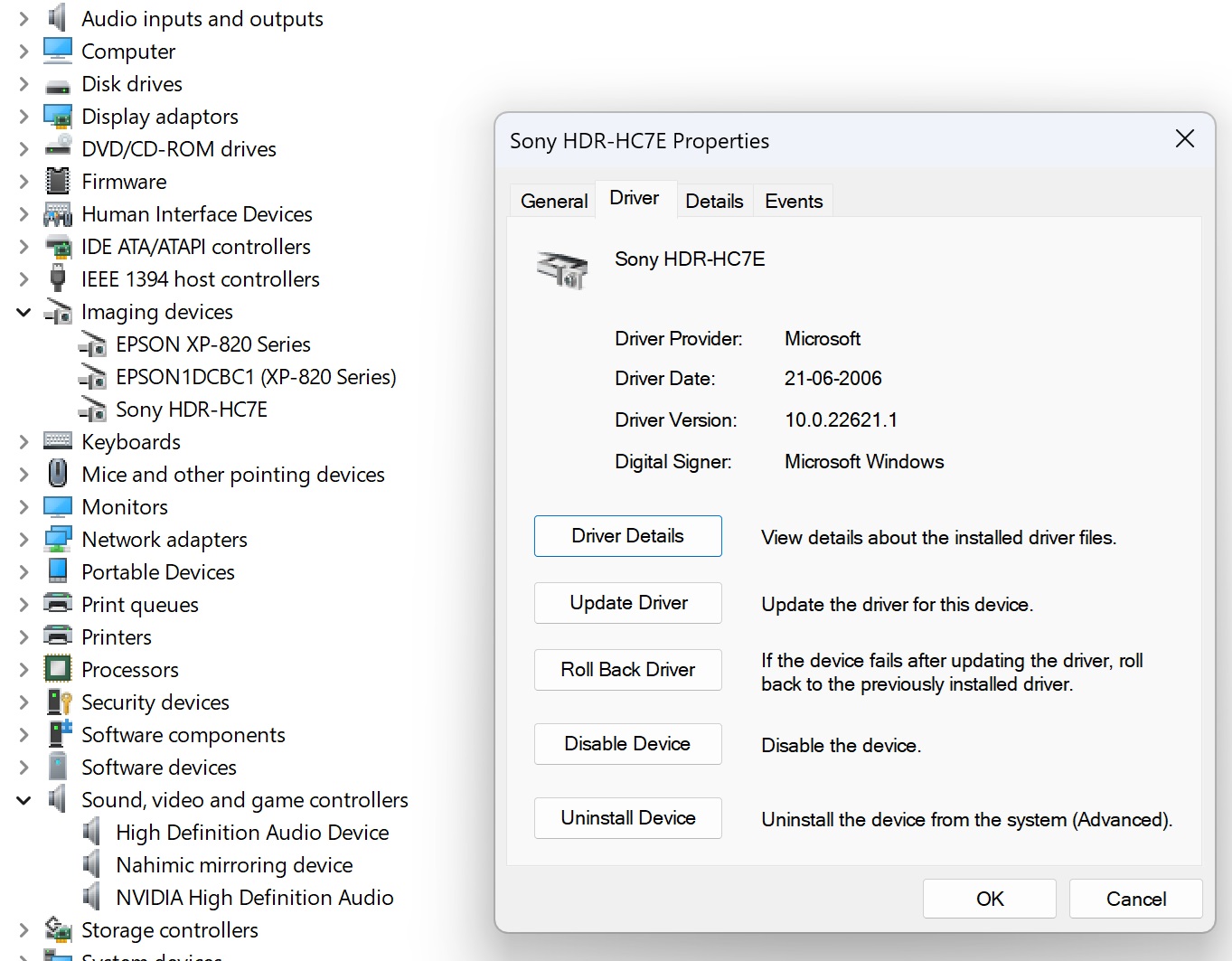

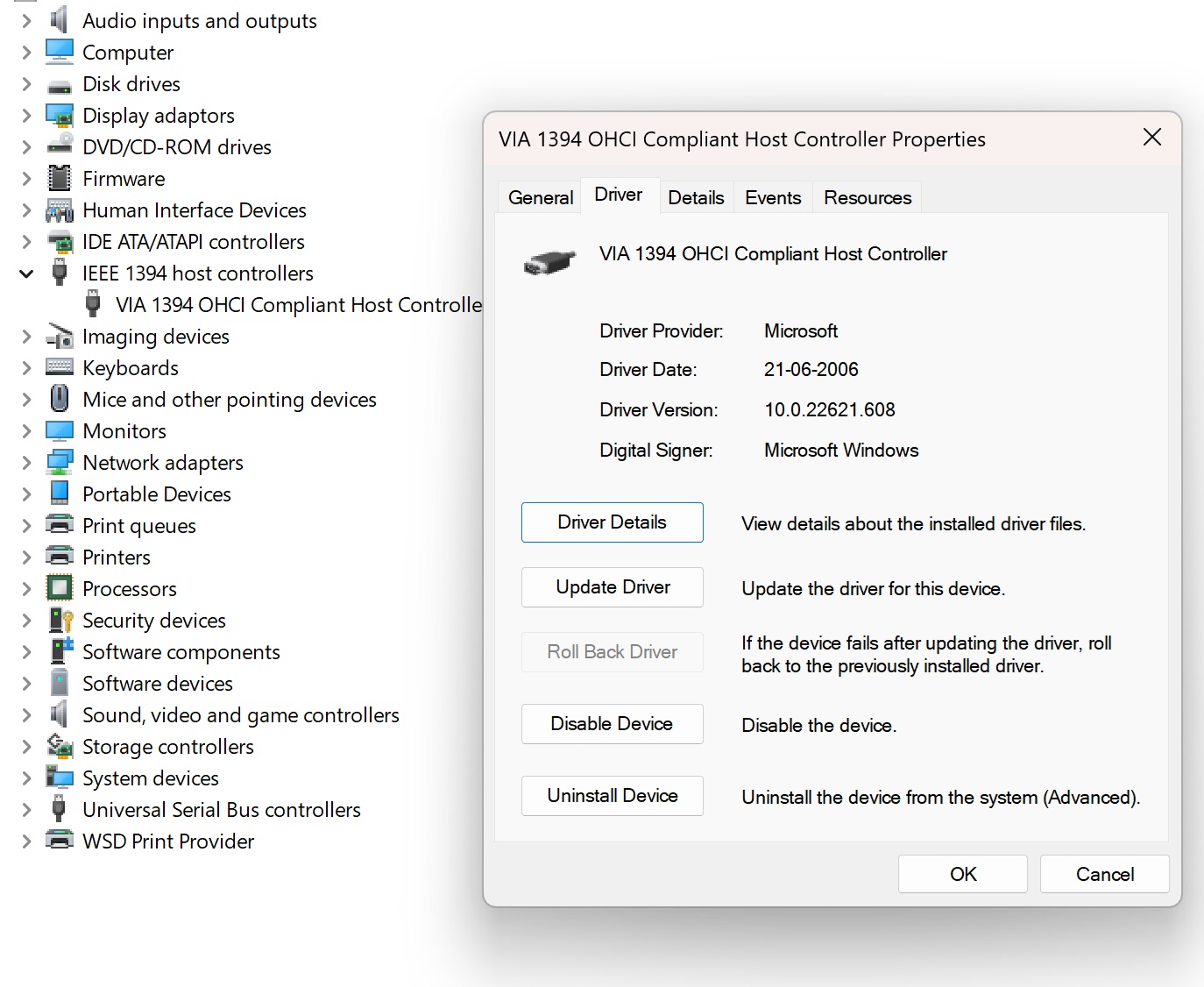

  25. Firstly, thank you for all your messages. I really appreciate them. So, here is the link to the firewire card I bought the other day:
    https://www.amazon.co.uk/dp/B07PHJKSF1?psc=1&ref=ppx_yo2ov_dt_b_product_details
    Using this card, this screenshot shows Device Manager when the camcorder is in play mode:
    [Attachment 74583 - Click to enlarge]
    The original card was bought in 2004 and I don't have the details now.
    Pchan, yes I do hear the audio tone when the cable is connected or disconnected and also when the camera is switched on and off. I got the same with the original card with 6 pin sockets too.
    This is Device Manager for the firewire card after I changed the driver to VIA (though I don't know if it has a VIA chipset):
    [Attachment 74584 - Click to enlarge]
    I didn't think the camera needed a driver, but I looked on the original Sony disc and I can only see a USB driver.
    Dellsam is correct that we don't have Wallmart as such in the UK. Also, I have about 50 tapes| We took a lot of video of the kids when they were growing up. I really need to watch them and make notes as the video is transferred.
    I hope this gives further clues?
    Thanks again.

    From what I can see, you are almost there.
    Here is the link to the manual.
    https://www.sony.com/electronics/support/res/manuals/2319/23198061M.pdf
    On page 77, perform step 6(to turn on playback mode), and launch WinDV.exe.
    Do you see a blue screen on WinVD?
  27. Member
    May 2005
    Australia-PAL Land
    It has a VIA chip (on the Amazon link).
    Both your driver properties are the same as mine.
