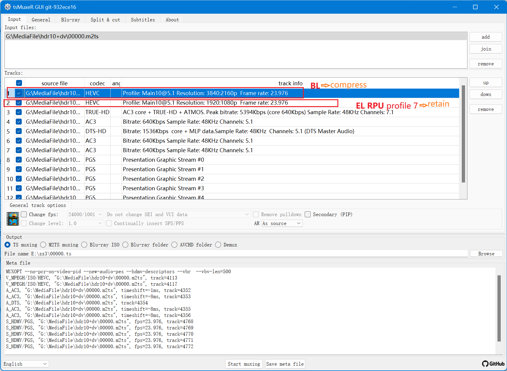

Because the m2ts file of the UHD disc already contains the double-layer Dolby Vision, I want to keep the EL+RPU layer without doing any processing, and then use handbreak to compress the BL stream, which is a 4K HEVC 10bit HDR video with a large amount of data (high bit rate), and then replace the original BL stream with the compressed video, and finally use TSMuxer to generate 4K UHD ISO.

I already understood your intention. But like I said
Do consider that should EL be MEL (Minimum Enhancement Layer; this only carries RPU), P8 is equivalent as it will contain all video- and DoVi metadata that is on disc. So in which case, as a valid intermediate to the link in my first post, you can recode BL and first create a P8 file.
Your tsMuxer's screenshot doesn't show whether EL is FEL or MEL. -
M2ts of UHD discs are double-layer DV, so they are FEL, not MEL. they are profile 7

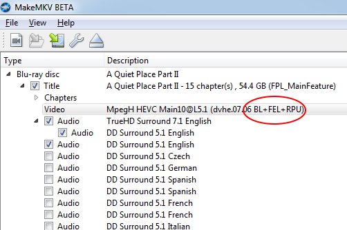

You're welcome. You can check for yourself whether a Dovi disc has MEL or FEL by importing it in MakeMKV. When you go to the videosection's properties, it will show either MEL or FEL.

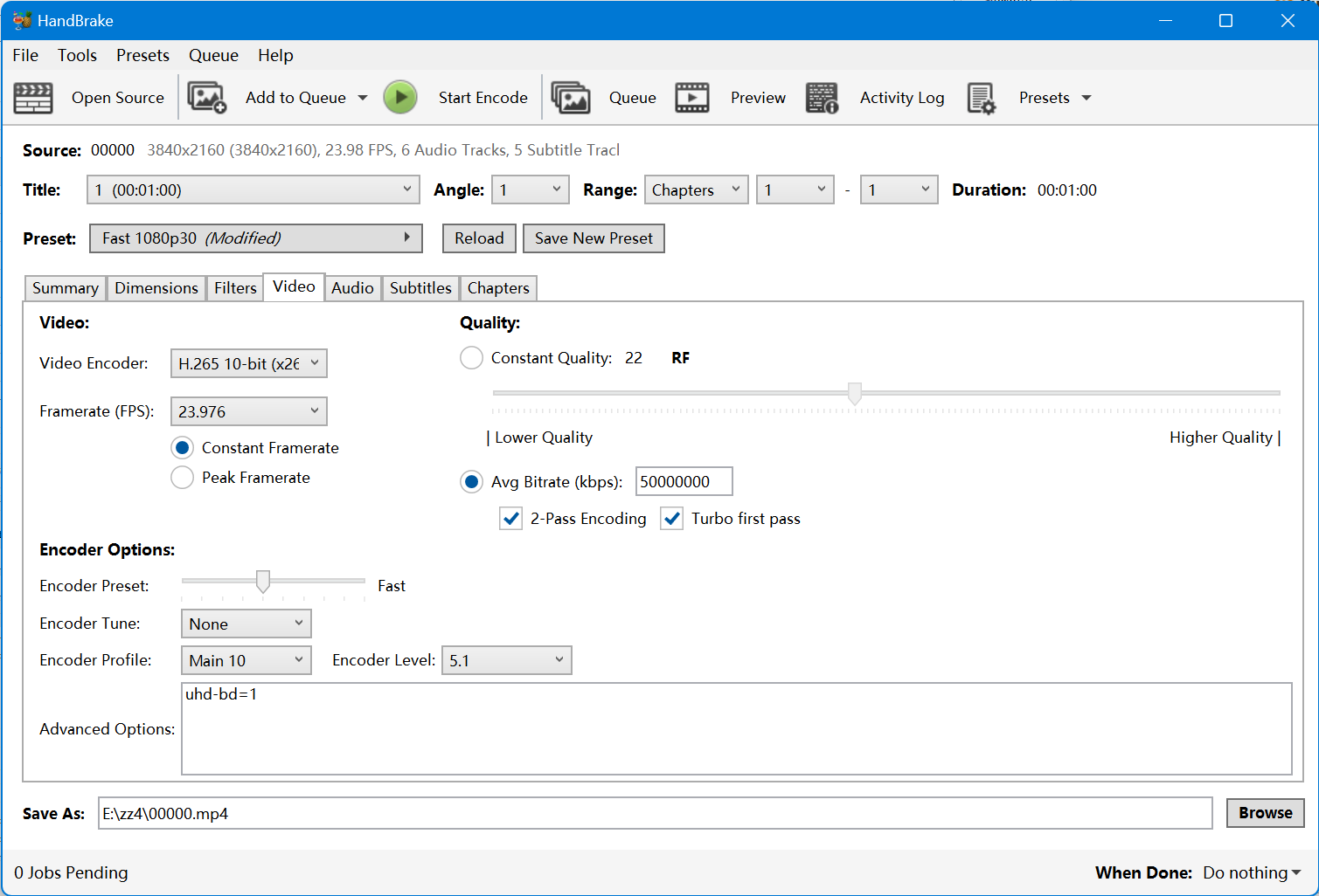

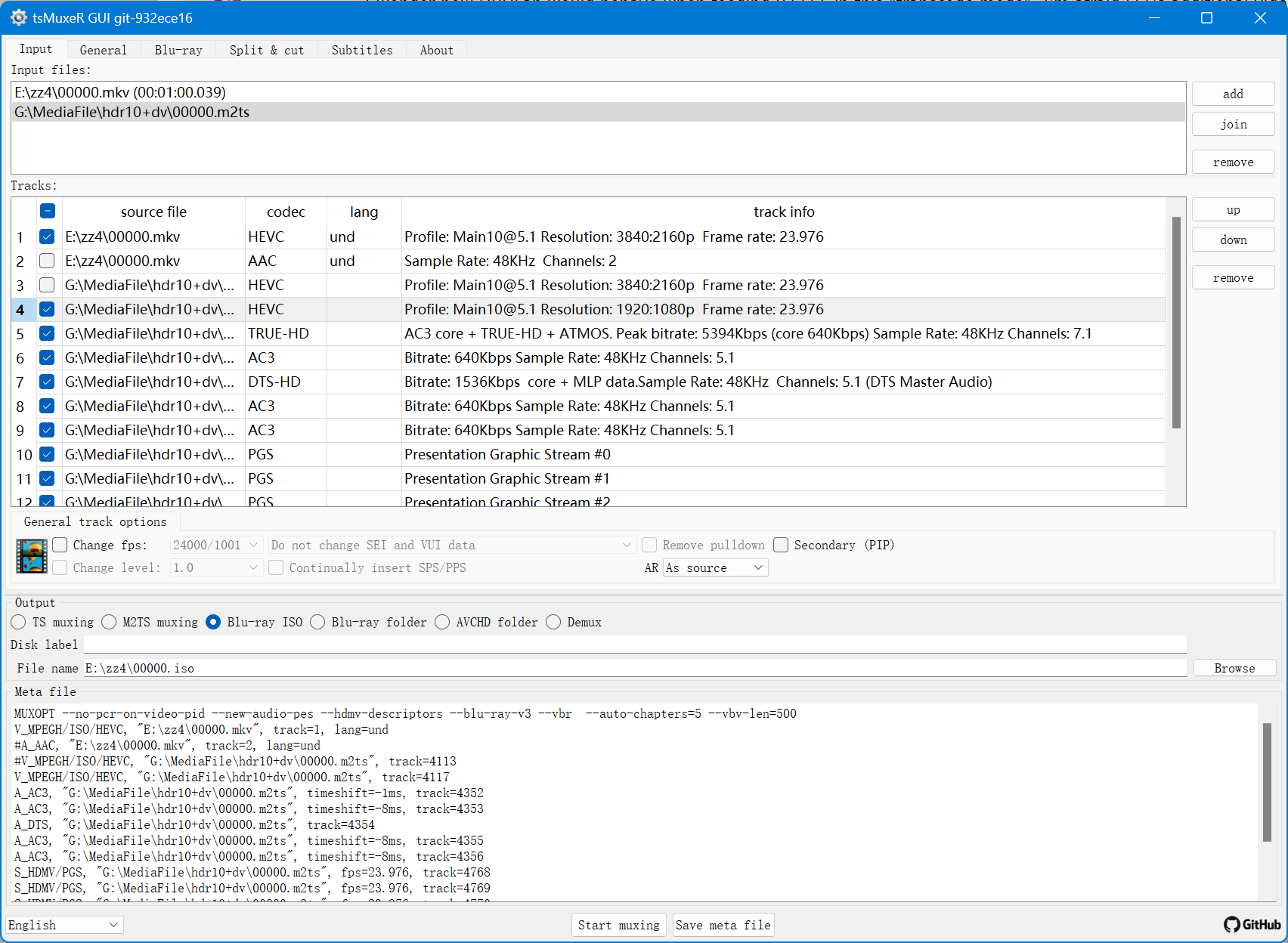

This method is possible, I have succeeded, it works on Panasonic DP-UB820, I encode the BL stream directly, and then composite it with the original M2TS, below is my handbreak setting.
[Attachment 74740 - Click to enlarge]
[Attachment 74739 - Click to enlarge] -

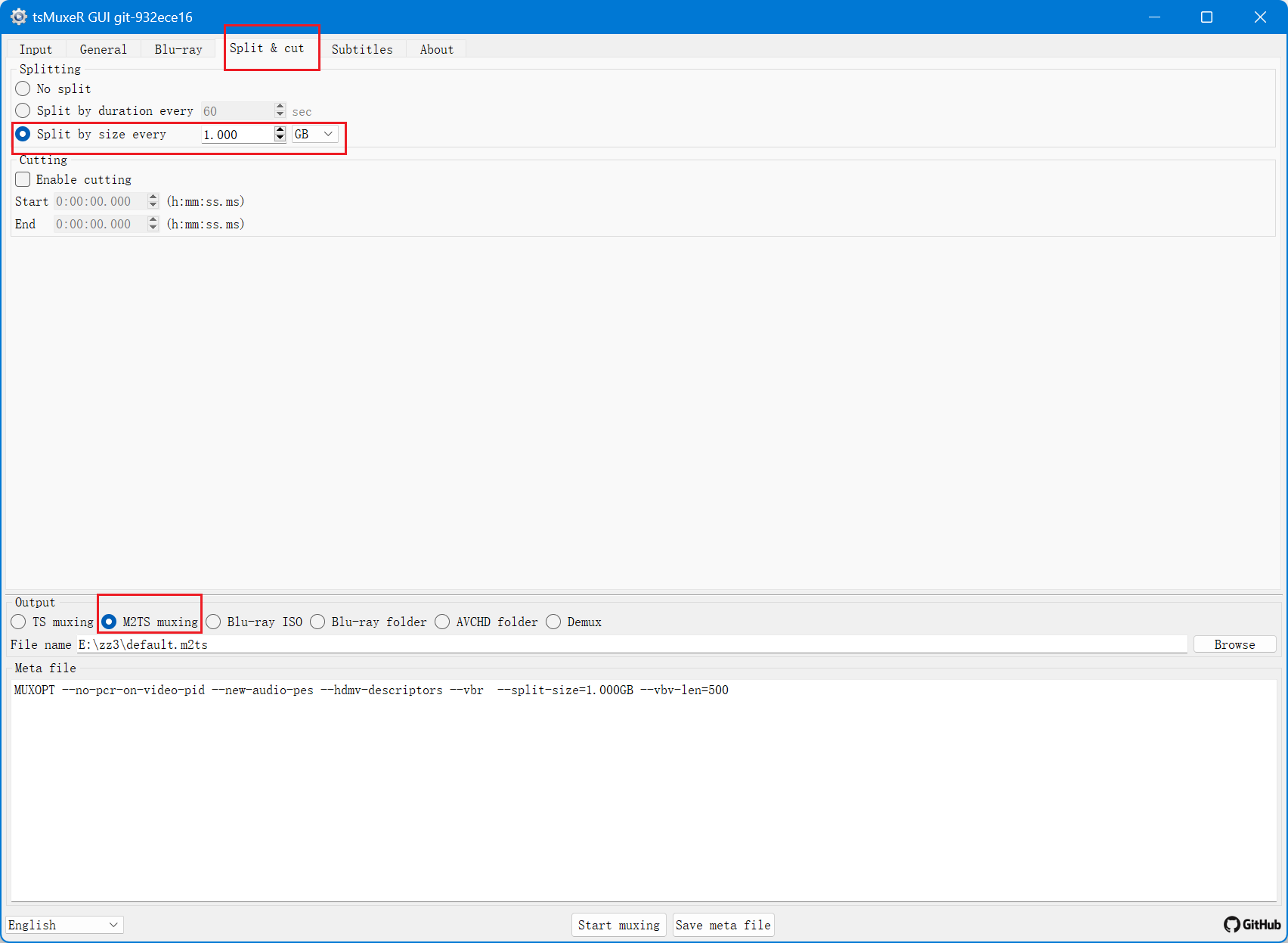

If you don't compress, but just split it into two parts, why not use TsMuxer? You can use the Split function to split an M2TS file into two, and then use the two M2TS to create ISOs respectively.
[Attachment 75466 - Click to enlarge] -
