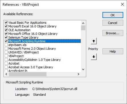

    This VBA code with translate English .srt subtitle to Hebrew using Google translate.
    User to create Sheet1(cell A1-input file name, cell A2-output file name), Sheet2(original subtitle) and Sheet3(translated subtitle).
    Input file must be in the same folder as the Excel macro file.
    Under the Microsoft Excel VBA editor -> Tool -> Reference (must have Selenium Type Library, Microsoft Script Runtime)
