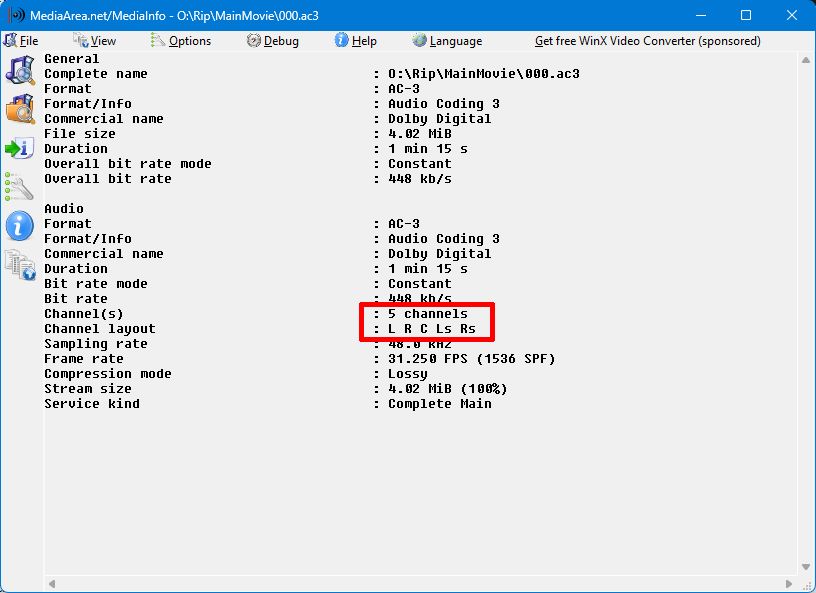

This commandline gives a 5 channel ac3.
ffmpeg -i input.mkv -map 0:x -af "pan=5.0|c0=c0|c1=c1|c2=c2|c3=c3|c4=c4" -c:a ac3 output.ac3
[Attachment 74461 - Click to enlarge]
No problem at all for muxing this ac3 to m4 or mkv. -
