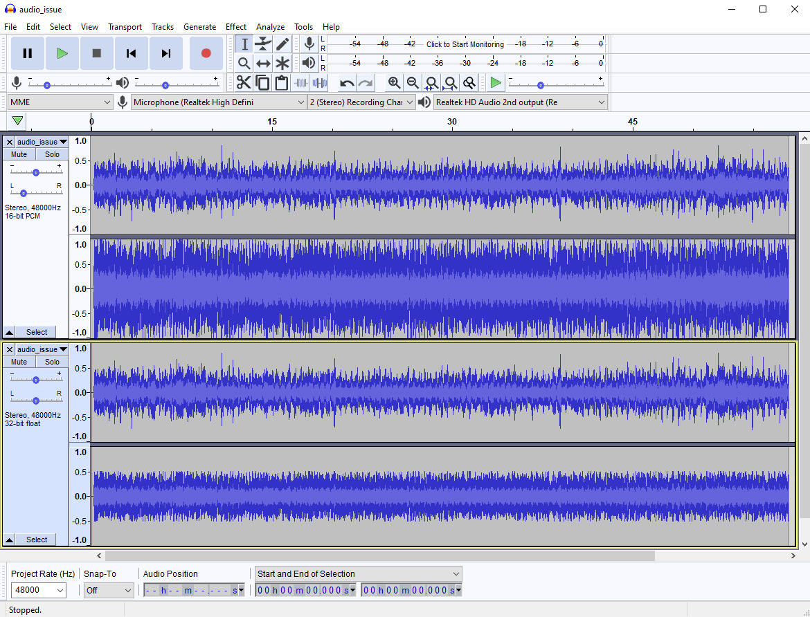

  1. I was checking some Mini DV tape captures (digital, with Firewire), and on all them the volume levels are not the same for left and right channel (left too low? or right too high?)
    All the tapes were recorded by the same camcorder, so I'm not sure if it could be a hardware defect of the microphone, or if something went wrong with the encoding. In particular, I think the tapes were recorded with 12 bit audio, while with mediainfo I see the audio is 16 bit.
    Do you have any ideas on how to solve this problem?
    I attach a piece of video with the issue.

    [Attachment 74502 - Click to enlarge]

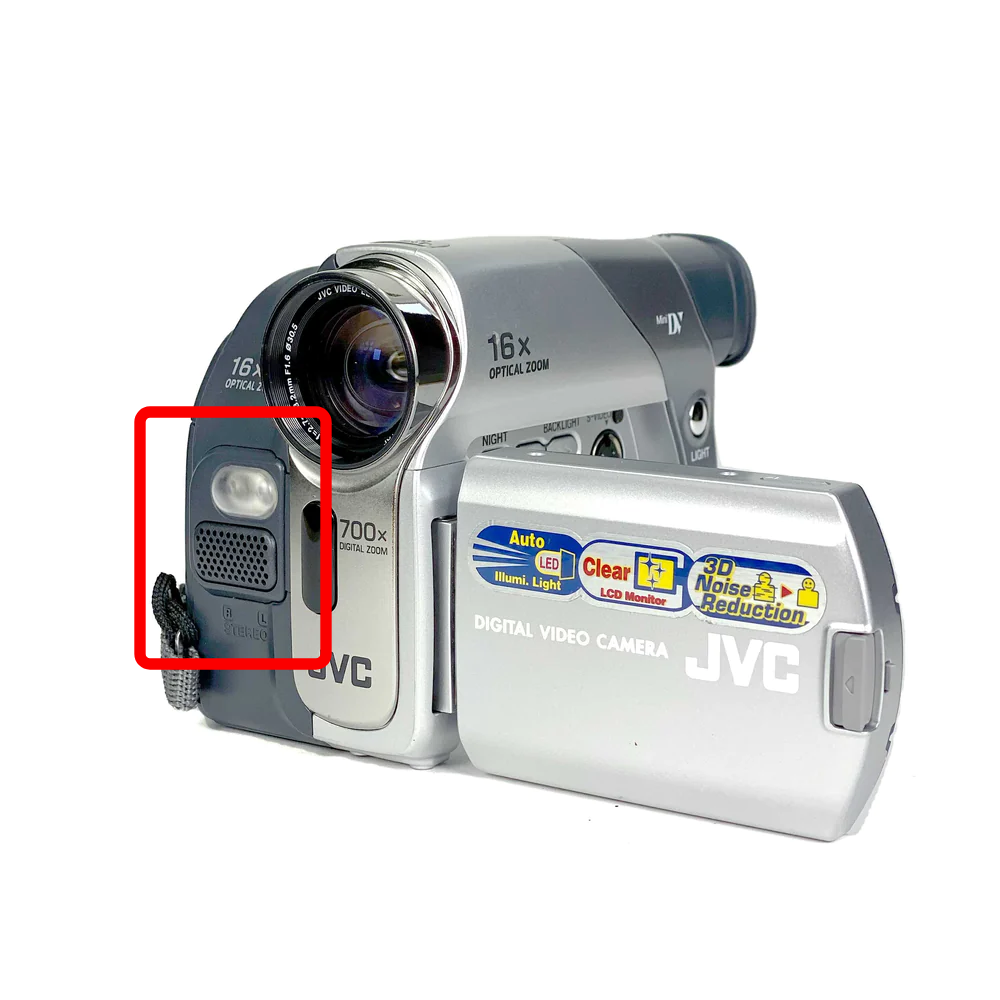

  9. The microphone used is the internal stereo. As far I can tell, it's front stereo, I see on the front of the camcorder a grid labeled "R L STEREO".
    On the manual (and on the settings menu) the only setting I found about audio is 12bit/16 bit, I cannot find any level regulation.
    [Attachment 74519 - Click to enlarge]

  16. Member pchan's Avatar
    Mar 2003
    Singapore
    This camcorder is quite old so the electronics might have deteriorated.
    Back to Audacity again. If you want it to be like this...

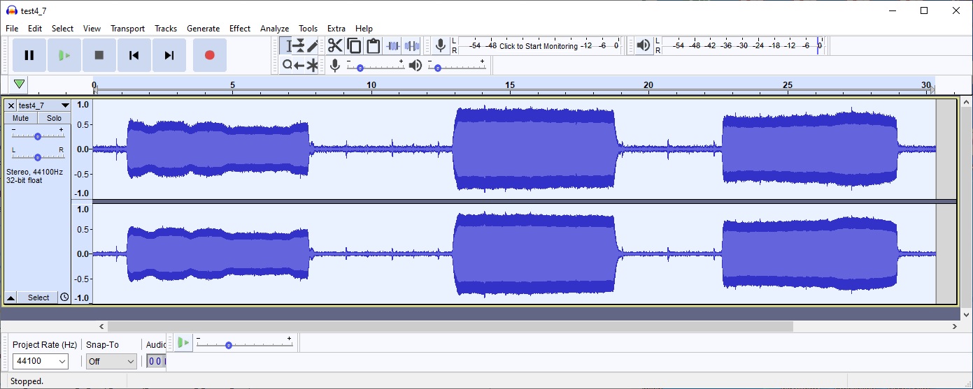

    [Attachment 74539 - Click to enlarge]
    Here are the steps...
    1. Drag and drop the AVI file into Audacity.
    2. At the top of the track, click dropdown menu(Shift + M) and select Split Audio Track
    3. Now that the left and right channels are split into 2, at the bottom of each track, click select and go to Effect and select Normalize...
    4. Repeat step 3 for the other track.
    5. Repeat step 2 but now, select Make Stereo Track
    6. File -> Export to your format that you want
  17. So the file you uploaded is the original? And the three tone bursts are audio source on the left, audio source in the middle, then audio source on the right? If that's the case I think there's just something wrong with the camera. All three positions have the same phase shift between the two channels. But if they were front/side channels the three tests should have different phase shifts. In fact the left and right tests should have the opposite phase on the side channel.
    How about trying one with all four directions: left, front, right, back.
