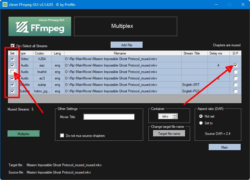

	Use clever FFmpeg-GUI.
 Load your file, click main, click multiplex, select your streams like in the picture, click multiplex.
 Done.
 [Attachment 74448 - Click to enlarge]
