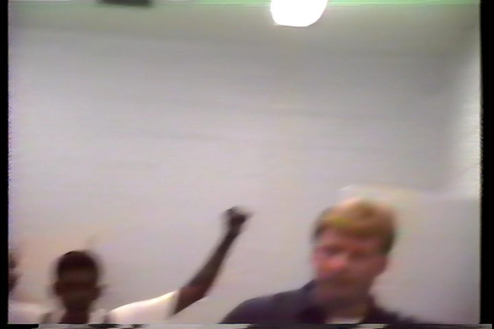

    I've been following a tutorial on how to use QTGMC to deinterlace video, which I've gotten to work, but I'm stuck on what to do in terms of cropping and resizing.
    The tutorial is telling me to resize from 720x480 to 720x540 using Spline64Resize(720,540) after deinterlacing, but the sample video in the tutorial doesn't require any cropping/masking because it doesn't have any black borders or head noise at the bottom.
    What should I do to properly resize my video while getting rid of the black borders and head noise at the bottom using avisynth?
    Also, what would be a second option to add black borders after the video is properly trimmed for DVD conversion in the future?
    I've tried to figure this out on my own but after reading more and more I'm just getting more confused.
    Attached is a still shot of a capture of mine in question. All my video seems to have the same issue.
    Thanks!

    The 704x480 portion has 4:3 proportions. It is up to you how you want to crop the image and present it. If you want to have the whole thing as 4:3, then yes, crop it to 704x480. If you want to crop the head-switching noise, then for every two horizontal lines you need to crop three vertical ones to keep the same aspect ratio.

    I can remove the border and noise by using Crop(12, 0, -18, -8) which leaves me with 690x472. The tutorial I was using stretches to 720x480 to 720x520, which is stretching the image vertically by 1.125.
    If I use that to stretch my trimmed video the return would be 690,531 (472*1.125=531). 531 isn't valid for h.264 encoding so I have to increase my trim to -16 to get an even Y-axis dimension.
    So my trimming and resizing commands would be:
    Crop(12, 0, -18, -16)
    Spline64Resize(690,522)
    I haven't seen those dimensions used before, but I believe the result would give the same "stretching" of the deinterlaced video. Does that sound correct?
  4. Assuming your source is a 4:3 NTSC tape capture (please confirm) its PAR (Pixel Aspect Ratio) is in very good approximation 10:11.
    So you can crop as you initially suggested crop(12,0,-18-8) but resize to 720x540 which gives pretty exact square pixels and a DAR (Display Aspect Ratio) of 4:3.
    Your second proposal would give a ~2% aspect ratio error which one would usually hardly notice.

    The video is NTSC. Does this look right? The only thing that's throwing me off is that I'm removing the noise at the bottom, which changes the "stretching" a little bit for me since my video is slightly shorter after the crop. Also, is there really any point to upscaling here? If not, what should I change? My last step is encoding the video to H.264 when saving.

  8. The script looks basically ok to me. For subsequent x264 4:2:0 encoding I would add ConvertToYV12() before the Prefetch() line.
    Is there any point in upscaling?
    I would have to leave this to your eyes. Either you upscale it, or when you resize it to say 720x540 your TV will upscale it.....
    Neither is prepared for DVD compliance though, as you have been asking for as a future option.
    The other option would be masking, like
    AVISource("basketball.avi", audio=true)
    AssumeTFF()
    QTGMC(preset="Slower", EdiThreads=12)
    Addborders(6,4,8,4) #padding to 704x480
    ConvertToYV12()
    Prefetch(10)
    and encode x264 using --SAR 10:11
