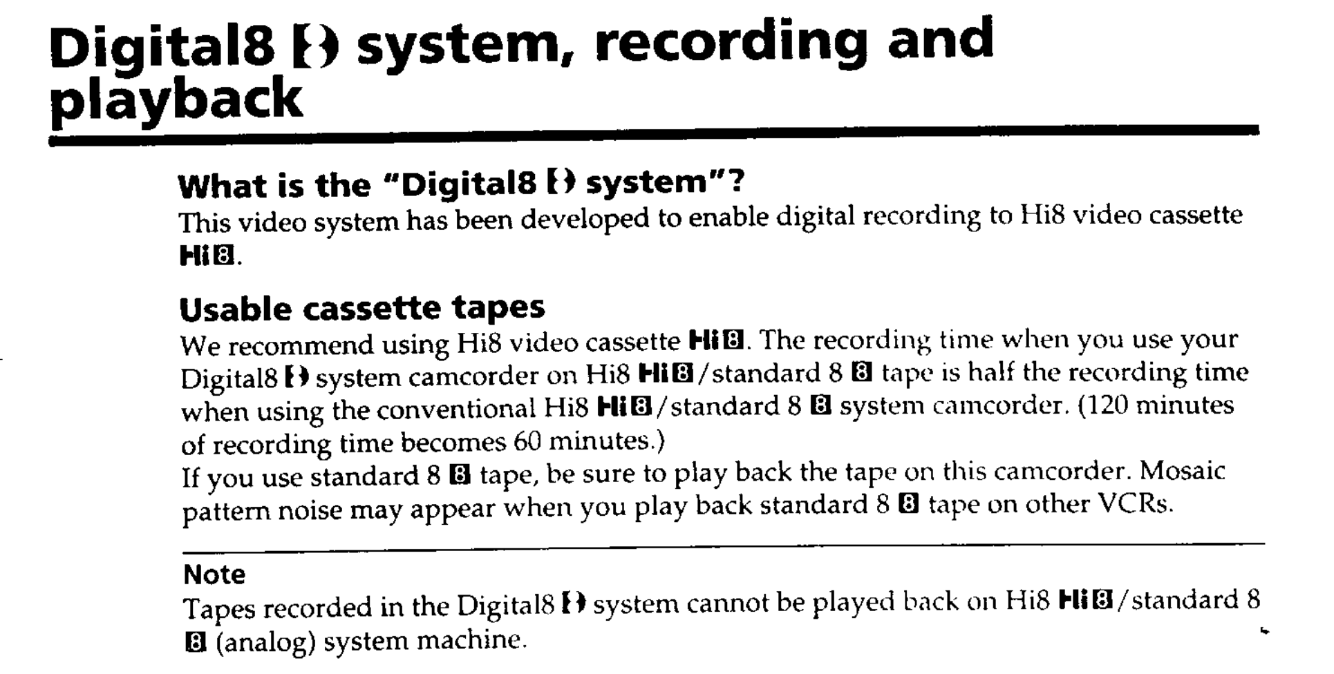

    Had to dust off my memory, Yes you can without holes for D8 but Sony gave a warning about incompatibility problems with other players:
    [Attachment 74366 - Click to enlarge]

    Had to dust off my memory, Yes you can without holes for D8 but Sony gave a warning about incompatibility problems with other players.
    Yes, I am aware of the warning. Many early 2000s Hi8 cassettes were branded as Hi8/Digital8. I don't know how serious the issue is. I used standard 8 tape on just one Digital8 camcorder, it displayed no warnings and worked fine, without visible image defects.
