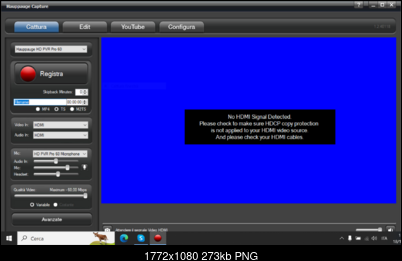

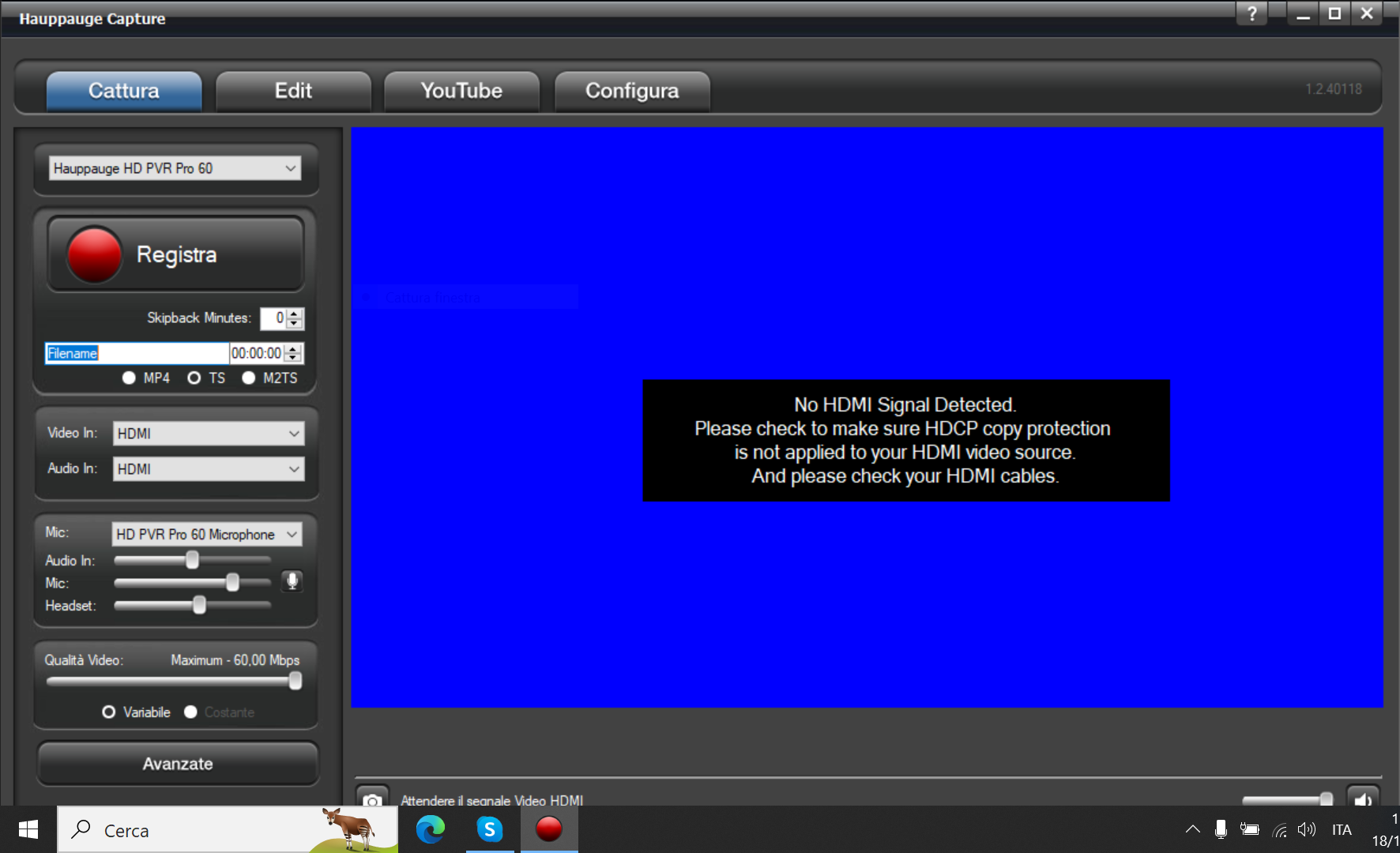

  23. Captures & Restoration lollo's Avatar
    Jul 2018
    Italy
    Well, 50 Mbits/sec should be more than enough for 1080p.
    Although I read in the "Hauppauge capture" manual that this model can only do VBR.
    You can go up tp 60Mbps. Only VBR for any bitrate.
