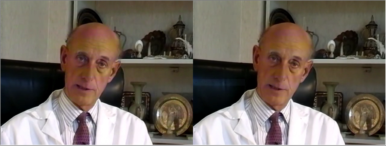

    I have noticed that the original video where the sample clip was taken from does not appear to be successfully processed in removing the color banding!
    I'll try to upload another sample clip from the original video, and maybe it can then be seen why the original video is not apparently being processed properly.
    Screenshot from original video showing that color banding is not being removed (completely).
    Original video on the left, processed video on the right of the screenshot.
    [Attachment 74373 - Click to enlarge]
    This is the script I'm using -

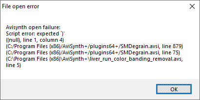

    Now, tried to test using SMDegrain, but got error message -
    [Attachment 74387 - Click to enlarge]
    Using this script -

    What is wrong with the SMDegrain command here?
  15. It's probably a version problem. Either of SMDegrain or one of its support filters. I've tried SMDegrain 4.5.0d and 3.1.2d. Both worked. What version are you using?
  16. According to the text header of SMDegrain.avsi, it is version 3.1.2d.
  17. line 879 of SMDegrain 3.1.2d reads:
        IsAvsNeo ? eval(MidStr(VersionString(),20,4)) : IsAvsPlus ? eval(MidStr(VersionString(),17,4)) : 0
    Are you using AviSynth+? Or an older AviSynth?

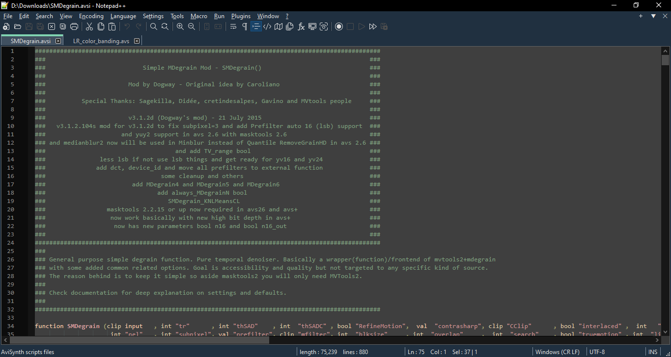

  19. Back to this slightly older topic. Still can't get SMDegrain to run without error.
    Line 879 of the script SMDegrain.avsi reads -
    and line 75 of the script SMDegrain.avsi reads -
    sisphbd = AvsPlusVersionNumber > 2294
    Screenshot of SMDegrain script header -
    [Attachment 77081 - Click to enlarge]
    Running AviSynth+ version 3.7.3
    Any further ideas on how to get SMDegrain to run?
    EDIT: please refer to post #14 for the error message when trying to run this script.
