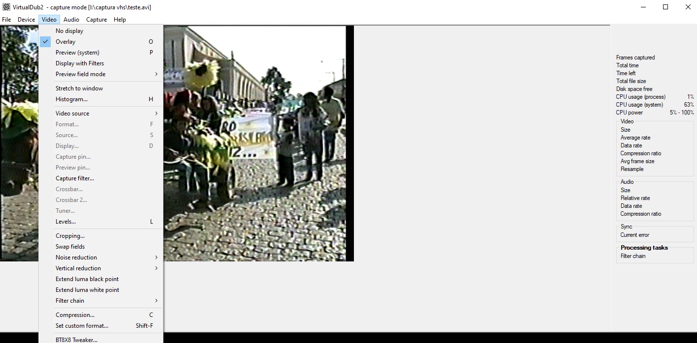

    I'm facing issues on capturing video on virtualdub. I see the picture running with no sound. Someone here showed me this tutorial, but it didn't help.
    the "format" option on video section on Virtualdub is disabled.
    Also, when setting custom format, whenever option I choose, it says "the capture device does not support the selected video format"
    When I try to capture video, another error message says: "video compressor error: the source image format is not acceptable (error code-2)"
    It's odd that some settings are not avaiable for me. Why?ImageImage

    What is your setting under Compression?
    1. You need to install the codec e.g. HuffYUV
    2. Set the compression setting after installing the codec
    What frame rate are you capturing?
    Press F9 and key in your frame rate. (Brazil is PAL = 25 frame/sec)
    VirtualDub guides.
    https://www.virtualdub.org/docs_capture.html
    https://www.digitalfaq.com/guides/video/capture-avi-virtualdub.htm

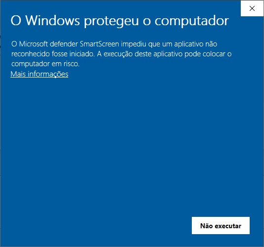

    [Attachment 74642 - Click to enlarge]
    it gives me this message error when trying to install the UT codec (installing as an administrator)

    https://supertutoriais.com.br/pc/como-executar-programas-bloqueados-smartscreen-windows-10/
    Before you do the above, please tell us how you connect your video source to your PC.

    Ignore that message, click on More Information and click "Run anyway". You'll then get another warning-type screen; click "install anyway".
    Windows thinks that the UT EXE file is dodgy. Since it's from VideoHelp, it's OK (I hope!). I just (re) installed it and haven't had any problems now or in the last two months (when I first installed it).
