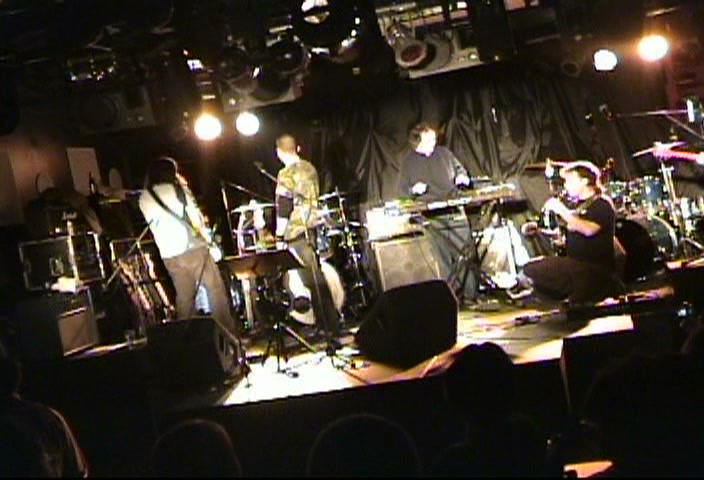

    here is a source clip (.mpg) and a second one (.avi) with separatefields and smoothlevels for level adjustment
    the uppêr field has a little better horizontal resolution ( i think)
    and one is a little more purplish and the other a little more reddis
    if you zoom in a little you can better see the letters on the keyboard , on the other they look scrambled
    reduceflicker() may help and maybe mosquitoNR() too .. i want to know if a can cure this and not just throw away one field

  3. So you're looking to convert that MPG file into something more watchable? Something like this...

    i was more thinking of a "edit friendly" version ( for Vegas movie studio)
    the fields look to me like the colors are bleeding differently (top and bottom)
    greenish on the top field and purplish all over
    i guess that don't help deinterlacing

    i want both options , interlaced (for backup) and progressive (for upload and processing)
    i have a few hours of those jams
    if i can stay in YV12 all the way through , that would be a great thing
    color stabilization is a good thing .. i usually monitor colors (hue) with colortools in VD ( i know it's in RGB)
    but some of the JPSDR plugins work in YV12 and i do my script with Hybrid most of the time
    and i don't know what other clean up you did ..bot looks like a good start
    i want to try the mosquitoNR and for that i need a progressive source
    if a deinterlace to double frame rate that would be easier to reinterlace after
