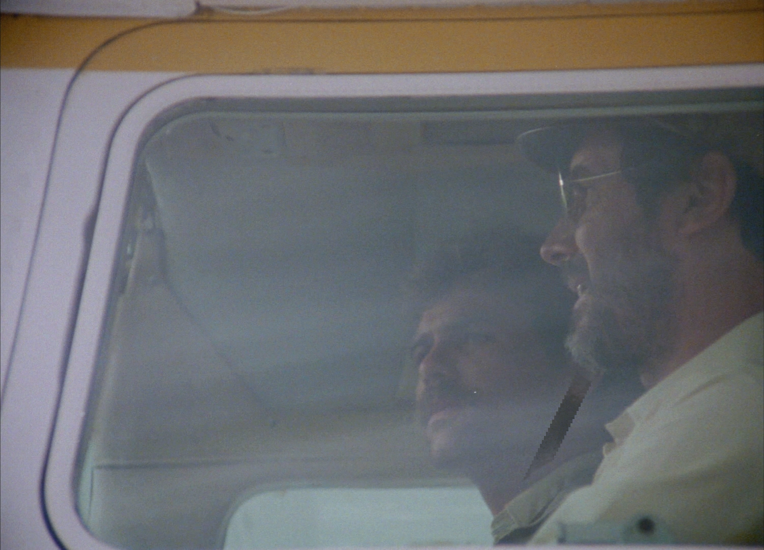

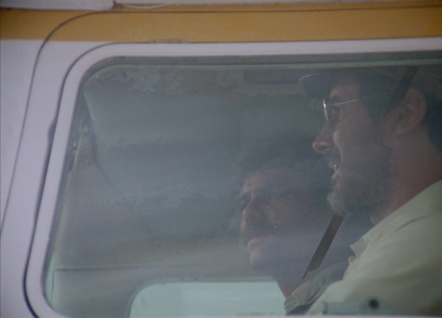

    I'm having problems dirt filtering specific scenes. It seems that RemoveDirtMC is somewhat confused by faster movements in the style of flickering but not flickering as a deffective video more like the wind is blowing or the light is flashing.
    I also tried Despot and spotless but they worked far worse than the various variants of Removedirt.
    Maybe some of the experts here who are very good in understanding special configurations of functions could help. I would be very grateful.
    here is a sample: https://www.transfernow.net/dl/20231014rCKBNzmE
    and here are 2 screenshots of the issues which are caused
    [Attachment 74335 - Click to enlarge]
    [Attachment 74336 - Click to enlarge]
    thank you very much

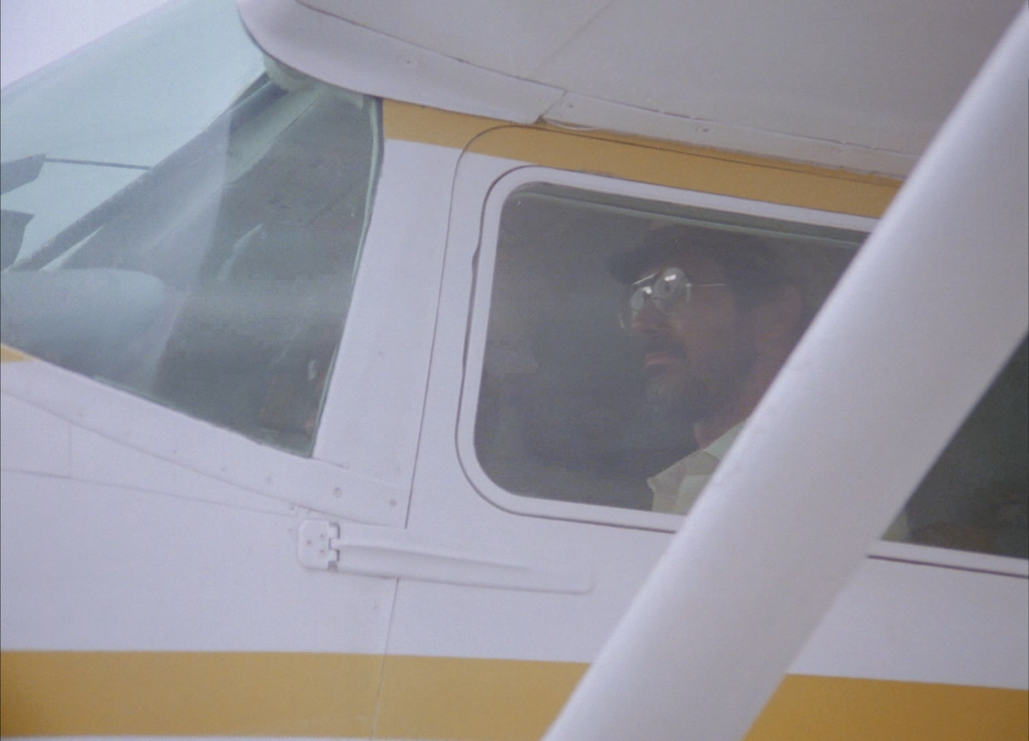

  4. ok I tested it and it seems that I'm still having the issues.
    Frame 273 still shows weirdness.
    [Attachment 74341 - Click to enlarge]
    I used
     RestoreMotionBlocks(clensed,input,alternative=alt,pthreshold=30,cthreshold=8, gmthreshold=40,dist=3,dmode=2,debug=false,noise=limit,noisy=4, grey=_grey)
    and also tried the Alternative settings which looked worse.

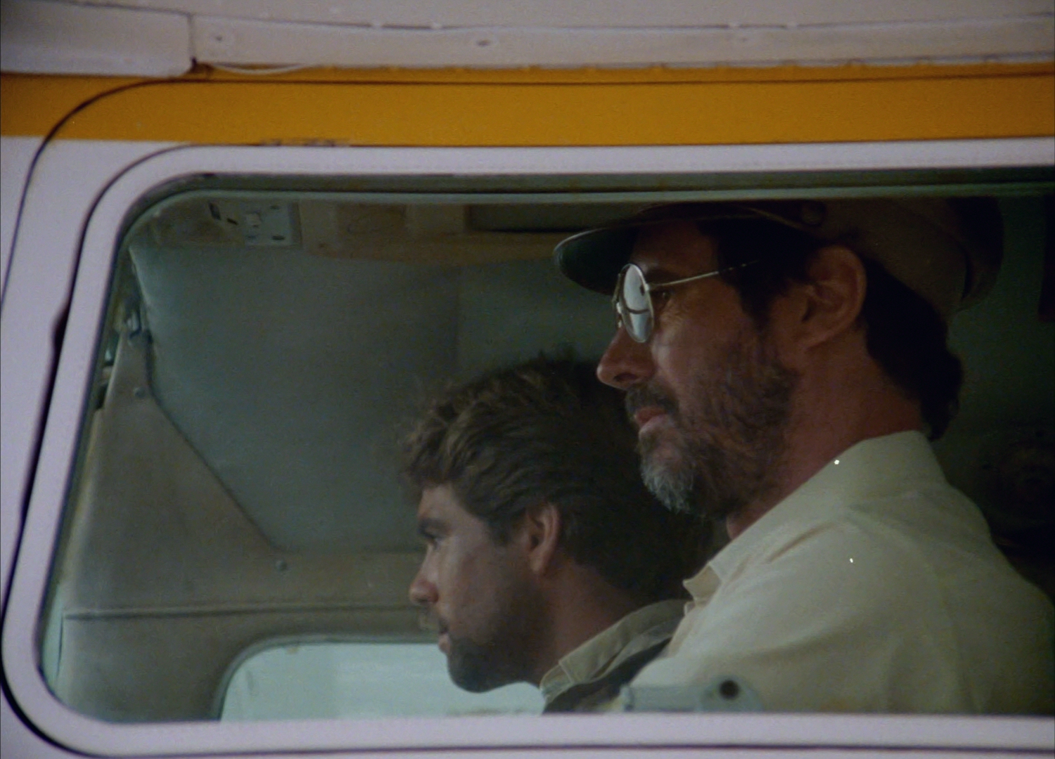

    The stuff I want to remove is the majority of the white dust spots. For example in this frame 166 it worked fine
    before
    [Attachment 74342 - Click to enlarge]
    after
    [Attachment 74343 - Click to enlarge]
    But as said in other frames it was generating theese ugly things shown on the first screen shot.
    thanks a lot for your help

    I hadn't noticed that earlier. It's definitely a problem with the motion estimation. I'll see if I can find an automated workaround...
  6. I figured out the problem. RemoveDirtMC() doesn't like the mod4 frame width. Try this:
    LWLibavVideoSource("RemoveDirtConfusion.avi")
    AddBorders(0,0,4,0)
    RemoveDirtMC(15, false)
    Crop(0,0,-4,-0)
    Add the diffmask and overlay lines if you still want to protect other parts of the picture.
  7. thanks a lot man that is nice to know. So the removedirt bugs didn't occure because of the flickering they were somethings else. I tend to always crop everything away I don't need so from now on I will just leave it in standard resolution and crop after remove dirt.
    The weirdness shown on the 2nd picture in my main post remain but I will definetley play around with the diffmask. thanks a lot for your help
