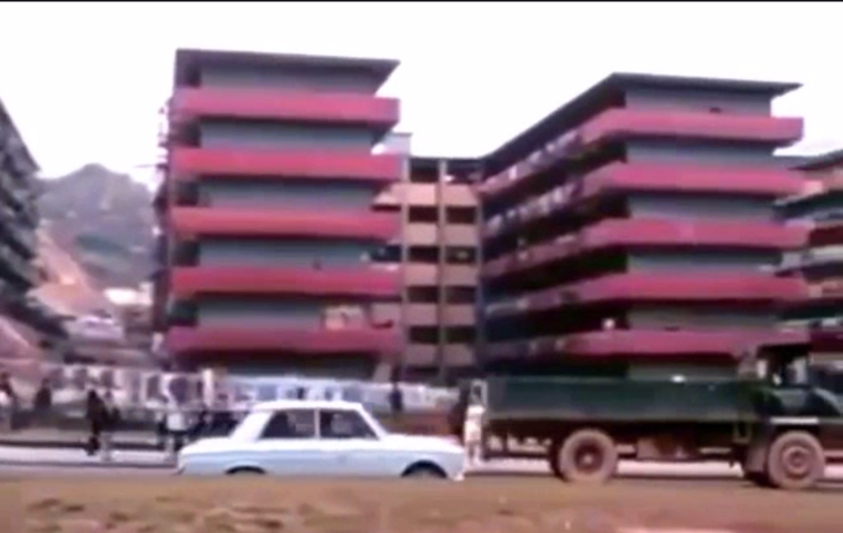

    Hi,
    Thanks for your advice. After upgrade the movie is blurry, not clear. Please see the screenshot attached here.
    Regards

  8. Originally Posted by satimis View Post
    Yet another reason to not bother upscaling. Your TV set will do it and not make it worse. However, if you do it, and then do it incorrectly, the result will be worse ("blurry") rather than better, and in addition you will have wasted all that time that you could have used to do something else.

    I have tried following Video Enhancer online;
    https://clideo.com/
    It has done a good job. Please refer to the screenshot attached. I'll try AI Video Enhancer later to compare their result.
    What I'm trying to achieve is to enhance the sharpness of the video.
    Regards

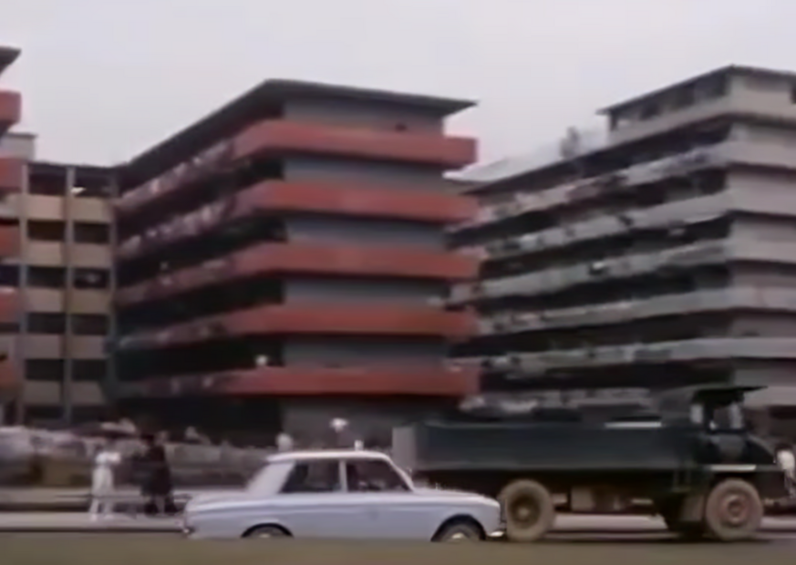

    Just tried following AI Video Enhancer online
    https://www.cutout.pro/ai-video-enhancer
    The result is worser. Please see screenshot attached

  17. Snake oil, as I said. But if you like it, why not.
    The Clideo VideoEnhancer (first attached picture) may look better to you, but it clipped the whites badly. Means the sky is just plain flat white for example, loosing any gradation and details. A natural sky is never just plain white. Clipping/crushing of the brights may even be more annoying in other scenes.
    The AI Video Enhancer (second attached picture) tried to preserve the gradation at least.
    Both still blurry of course. But VHS is VHS. No miracles to be expected.
