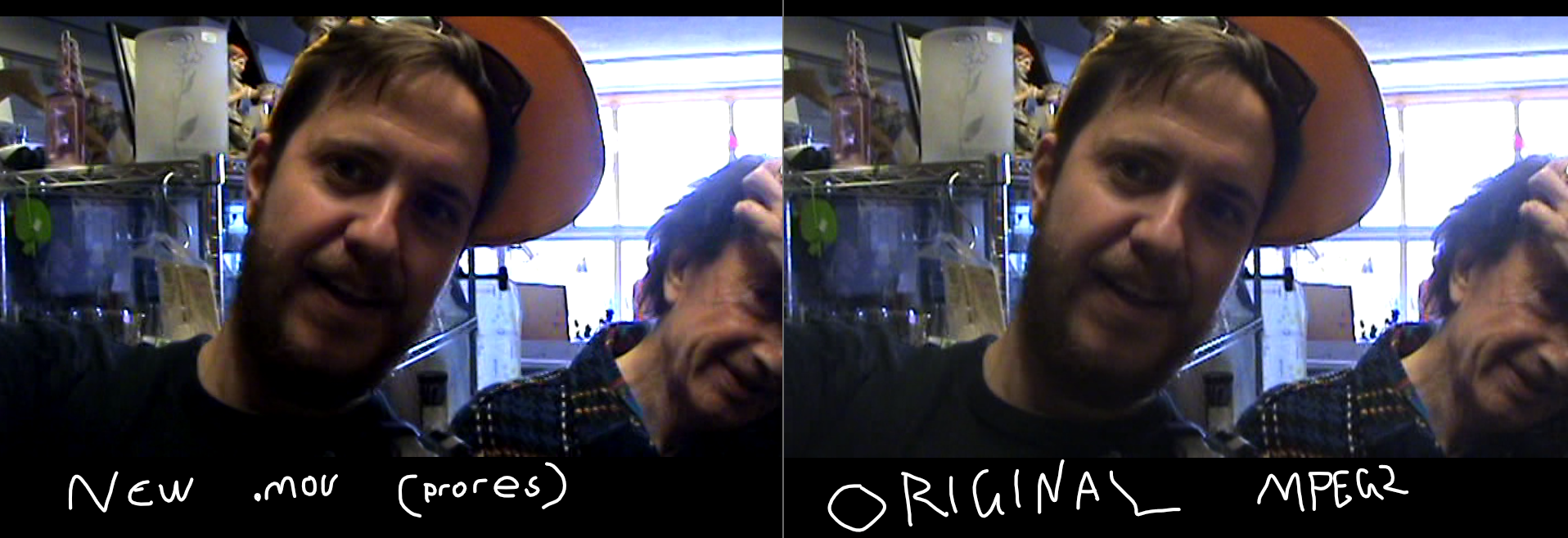

    Hi folks.
    First off I am a total noob at this, I am doing the best I can with alot of reading and using chatGPT but I'm out of my depth by a lot.
    I'm trying to convert files from my sony handycam from MPEG2 to something that I can bring into davinci resolve. However whatever I try to convert them into, they look worse!
    The MPEG2 files from the camera (it has an HD, so there's no ingest process other than copying the files, this one is not miniDV, it's all digital)
    I've tried a bunch of file formats, but they all look the same. Hopefully it will come out in the pic, but basically the converted files look too contrasty, and have artifacts that look a bit like an interlaced image - but the original file is not interlaced! It's progressive!
    Here's a pic, I opened the .mov file and the original mpeg2 in vlc and media player, put them side by side and used the windows capture tool to grab a screenshot.
    [Attachment 74291 - Click to enlarge]

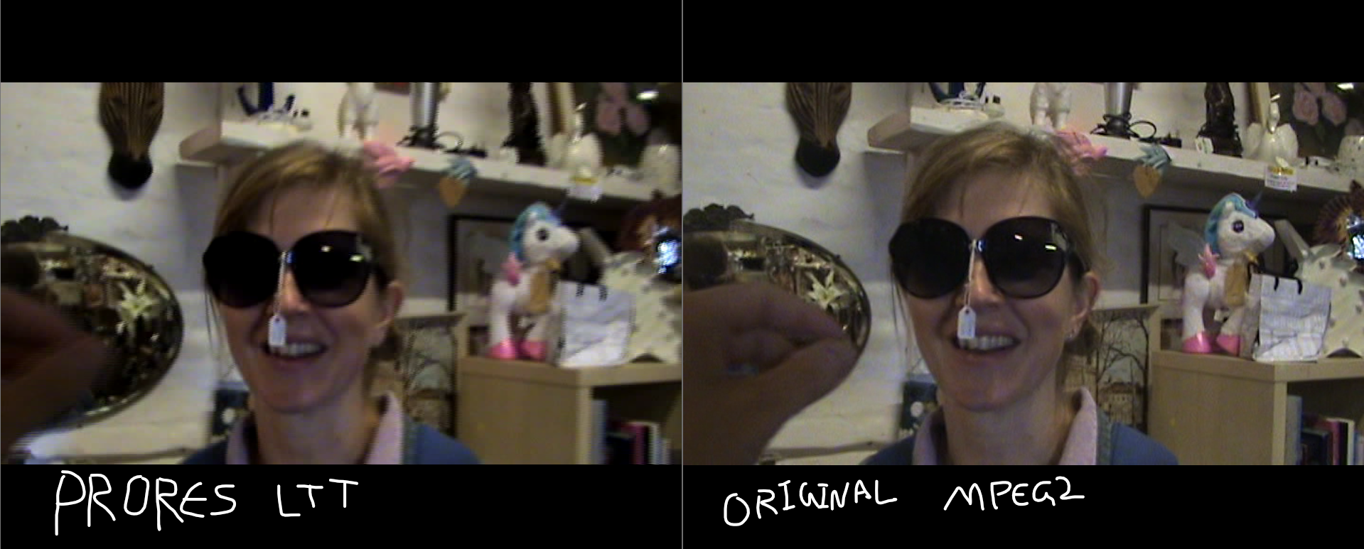

    QUICK UPDATE:
    Ok, I'm an idiot, the original files ARE interlaced - I've changed the script to take care of that using QTGMC - Here's my new script:
    @echo off
    setlocal enabledelayedexpansion
    rem Set the path to the FFmpeg executable
    set FFmpegPath="C:\ffmpeg\bin\ffmpeg.exe"
    rem Loop through all .mpg files in the current directory
    for %%F in (*.mpg) do (
        set input_file=%%~nF.mpg
        set output_file=%%~nF.mov
        rem Run FFmpeg to convert to a high-quality format with QTGMC deinterlacing
        %FFmpegPath% -probesize 32M -i "!input_file!" -vf "yadif=0:-1:0,format=yuv420p" -c:v prores -profile:v 3 -c:a pcm_s16le "!output_file!"
    rem End of script
    But the new files still lose a LOT of detail in the dark areas of the image.
    Here's a new example:
    [Attachment 74292 - Click to enlarge]
  3. 709 vs 601 color matrix? Limited vs full range?

  6. It's a limited range vs. full range problem. What does your AVS script look like? Try flagging the prores encoding as full range with "-color_range pc" or limited range with "-color_range tv".
    QTGMC is not implemented in ffmpeg. Just AviSynth and VapourSynth. Try using bwdif in ffmpeg (better than yadif, not as good as QTGMC).
    Oct 2023
    England
    At the moment there is no Avs script - the batch file generates one and deletes it when it’s done I think.
    I haven’t much experience with code so I don’t know how to implement those changes without just feeding your answer into chat gpt
    That said, are you saying I need to make the ProRes full range? Or limited range?
  8. There are too many places where things could go wrong so I can't say for sure where your problem is. Your DVD MPG source is certainly limited range rec.601. And should probably be encoded as limited range rec.601. But I suspect somewhere in your processing it is being converted to full range rec.601 without being flagged as such. That is causing the prores decoder to perform a second limited range to full range conversion, crushing blacks and blowing out brights.
    You might be able to fix this by flagging the prores mov as full range. Where you encode with ffmpeg to prores mov add "-color_range pc" to the command line after specifying the video codec.

  10. Originally Posted by Skeptjk View Post
    The files are not from a dvd though, they are from a Sony handycam camcorder - not sure if that is relevant tho
    The MPG source is almost certainly limited range 601 even though it's not indicated by MediaInfo.
