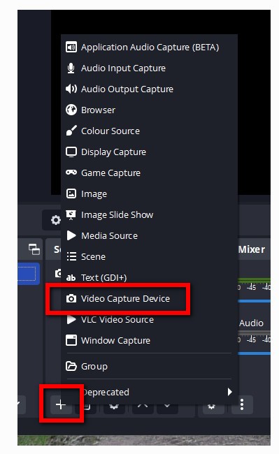

    Alas.. VidBox did not show up.. although I’m not sure I was looking in the right place. The audio came through, but I couldn’t find a spot to enable, or look for, video. I’ll poke around again. It just might be hiding in there someplace.

    In the Sources section, click the + sign at the bottom, then on Video Capture Device. It should be in there.
    [Attachment 74284 - Click to enlarge]

    Success.. Thanks! I had to figure out why it was displaying the image from the built in camera, (me), but eventually found that there was a pull down menu that listed the VidBox.
    It’s running now, without sound. Hopefully the sound is recorded, which I’ll discover when this is finished recording the video. If not… I’ll be back!
