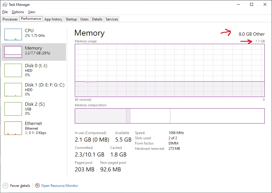

    Check the task manager for the memory available.
    Are you running a 32 bit version of x264 or your web browser?
    Did you set prefetch to (2) ?

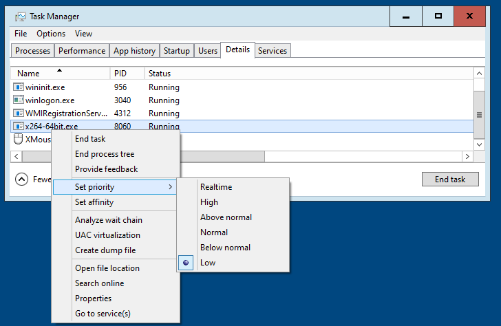

    But I was also searching for a way to set AviSynth+ to start with low process priority. I can start x264 with low process priority, but I can't start AviSynth+ with low process priority because I don't know how or if it's possible.
    You can do so with Task Manager. Find the encoding process and set the Priority to low. Here I'm encoding with x264 CLI:
    [Attachment 74377 - Click to enlarge]
    You can start a process with low priority via a drag-and-drop batch file. Here I'm using x264 CLI:
    start /b /low "x264" "g:\program files\x264\x264-64bit.exe" --preset=slow --crf 18 --sar=1:1 --output "%~1.mkv" "%~1"

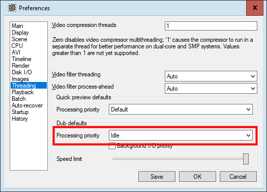

    Some GUI programs have an explicit setting for this. For example VirtualDub2's preferences:
    [Attachment 74378 - Click to enlarge]
