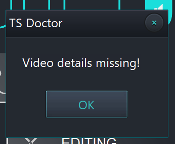

    So in the past I've had some decent results with TS Doctor. I load that program up, it pulls all the recording chunks together and does some repairs on the file, enabling me to export them all to one .ts file. This is good! I am also able to successfully demux the resulting video into a .264 file and a .aac file using the streams I want, which is also good. However, when I attempt to remux them back into one file, I get this error:
    This is the file YOU demuxed, TS Doctor! Sheesh!
