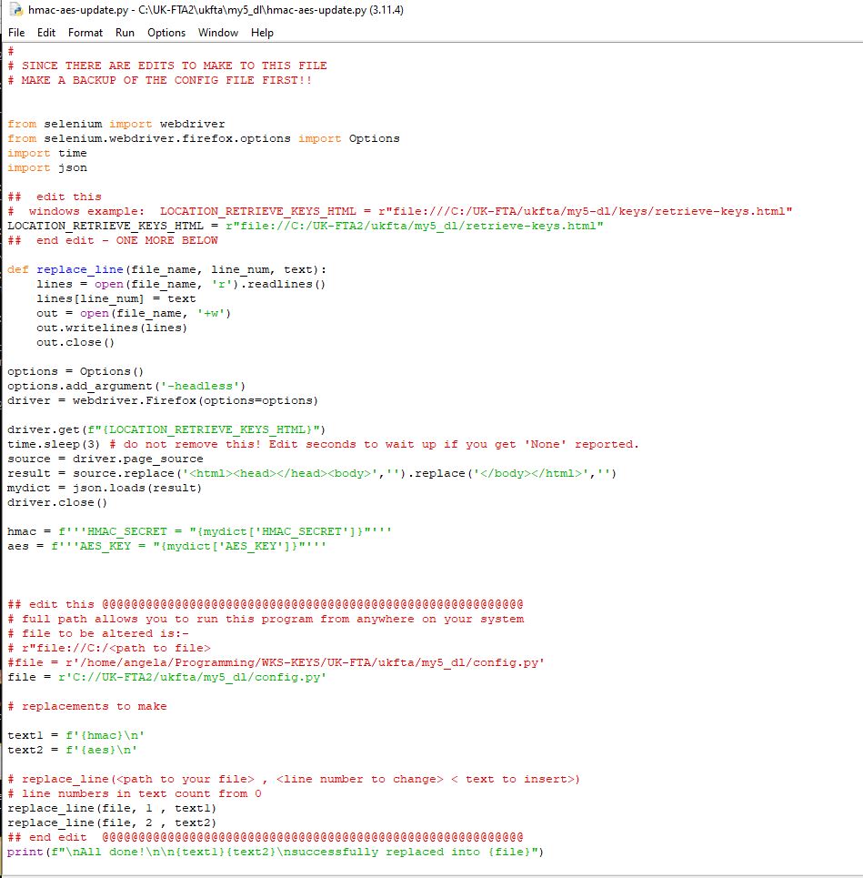

    I've sorted this one now I had a bit of a typo with my /
  12. Hi Angela,
    More of a safety advice question for you if you don't mind helping with. I've been updating a few items to keep your ukfta up to date,.. First was to update beaupy to the latest version. 2nd was the update of menu and itv 2.2.
    I've read the info about ch5 but before I could use "update my5" I encountered a request for an updated version of geckodriver.exe.
    My exact output was the following:
    The geckodriver version (0.33.0) detected in PATH at C:\UK-FTA2\geckodriver.exe might not be compatible with the detected firefox version (125.0.3); currently, geckodriver 0.34.0 is recommended for firefox 125.*, so it is advised to delete the driver in PATH and retry
    I Just wanted to ask where I could get a "safe" version of said geckodriver from please.
    Did a bit of scouring.... and came across the 32bit version here.. https://github.com/mozilla/geckodriver/releases
    all good to go except for a damned error...
    I've placed the 32bit version into my fta folder.... but as mentioned i get an error when trying to only update ch5.
    C:\UK-FTA2>menu.py
    ←[32m __ ____ __ _____________
    / / / / //_/___/ __/_ __/ _ |
    / /_/ / ,< /___/ _/ / / / __ |
    \____/_/|_| /_/ /_/ /_/ |_|
    ←[0m
    ←[31mChoose Your Search, Selector and Downloader.
    ←[0m
    ←[32mWhich Channel?←[0m
    File "C:\UK-FTA2\ukfta\my5_dl\hmac-aes-update.py", line 34, in <module>
    driver = webdriver.Firefox(options=options)
    File "C:\Users\Westhamboy\AppData\Local\Programs\Python \Python311\Lib\site-packages\selenium\webdriver\firefox\webdriver.py", line 67, in __init__
    super().__init__(command_executor=executor, options=options)
    File "C:\Users\Westhamboy\AppData\Local\Programs\Python \Python311\Lib\site-packages\selenium\webdriver\remote\webdriver.py", line 208, in __init__
    self.start_session(capabilities)
    File "C:\Users\Westhamboy\AppData\Local\Programs\Python \Python311\Lib\site-packages\selenium\webdriver\remote\webdriver.py", line 292, in start_session
    response = self.execute(Command.NEW_SESSION, caps)["value"]
    File "C:\Users\Westhamboy\AppData\Local\Programs\Python \Python311\Lib\site-packages\selenium\webdriver\remote\webdriver.py", line 347, in execute
    self.error_handler.check_response(response)
    File "C:\Users\Westhamboy\AppData\Local\Programs\Python \Python311\Lib\site-packages\selenium\webdriver\remote\errorhandler.py ", line 229, in check_response
    raise exception_class(message, screen, stacktrace)
    selenium.common.exceptions.SessionNotCreatedExcept ion: Message: Expected browser binary location, but unable to find binary in default location, no 'moz:firefoxOptions.binary' capability provided, and no binary flag set on the command line
    (I'm wondering if the bit right at the end has something to do with firefox being v 125.0.3

    Originally Posted by LastResort View Post
    Hi Angela,
    Tried a Google search? Please make that your first call.
    Mine turned up this from 7 years ago https://stackoverflow.com/questions/43660195/why-firefox-requires-geckodriver but there was nothing returned for a search limited to the past year.
    As I suggested I believe Selenium takes care of everything in new installs.
    I did a clean install of my OS early in the New Year and have never knowingly installed a Geckodriver. But I do use Firefox as my daily browser.
    I would do what the error message suggests and remove the old driver from Path. My selenium version is 4.20.0. And I also configured selenium to use a Chrome driver in one script and never needed to find a driver for that either. 'pip install selenium --upgrade'

  14. Sorry Angela.... Left the page open way too long whilst reading and didn't get to see your post..... my apologies.
    ahhh okay... my selenium is v 4.15.2
    i'll get it done.

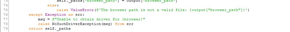

  16. Originally Posted by LastResort View Post
    i'll get it done.
    All updated...
    Tried to get "5" to update AES and HMAC but returned the following error..
    C:\UK-FTA2>menu.py
    ←[0m
    ←[0m
    File "C:\Users\Westhamboy\AppData\Local\Programs\Python \Python311\Lib\site-packages\selenium\webdriver\common\driver_finder.p y", line 75, in _binary_paths
    raise ValueError(f'The browser path is not a valid file: {output["browser_path"]}')
    ValueError: The browser path is not a valid file:
    The above exception was the direct cause of the following exception:

  20. Hi all,
    After what seems like hours scouring the net searching for sections of code that may be relevant to the error that gets thrown up,.. I was hoping that someone could point to where this code may be wrong....
    [Attachment 79010 - Click to enlarge]
    I have tried running the update from the menu, and I get the same error message, So I tried running it on it's own, and i get exactly the same error message. I have tried various methods of forward slash, double forward slash, backward slash, (only in the areas that required manually editing,... I found my old post but the code has changed since then,.... I do wish their was a way of watching the code run and seeing where it goes wrong,... I have come to the conclusion that wherever I look many people have their own way of writing the same piece of code.
    Selenium is uptodate,... and if i run geckodriver.exe that shows an cmd prompt with 1715392960691 geckodriver INFO Listening on 127.0.0.1:4444 So I'm assuming that's working correctly. Advice, pointers, or any general help would be very helpful. (Yes I can manually update the keys, but I am desperate to see how this actually works and why I receive the error. Many thanks chaps.

    is your config definitely set right in hmac-aes-update, example of mine.
    LOCATION_RETRIEVE_KEYS_HTML = r"D:/Web-DL-Stuff/uk-fta_13.4/UK-FTA/ukfta/my5_dl/keys/retrieve-keys.html"
    file = r'D:/Web-DL-Stuff/uk-fta_13.4/UK-FTA/ukfta/my5_dl/config.py'
    I got errors before I set these correctly, hope this can be of some help to you.

  22. Hi Kev043,
    My original hmac before the main menu was updated began like this LOCATION_RETRIEVE_KEYS_HTML = r"file://C:/UK-FTA2/ukfta/my5_dl/retrieve-keys.html"
    and file = r'C://UK-FTA2/ukfta/my5_dl/config.py'
    Are you Linux or Win??
    I've checked to make sure all Modules that are required are uptodate.... (incidentally it's only ch5 that I have a problem with).. Yes can update manually but I've now become like a dog with a bone..... trying to understand what the problem could be.
    First things first I shall mimic you hmac but with my location and give it a test.... Thanks for the help Kev043..
    Tried it your way Kev043... Exactly the same error as before.
    Reading the error I'm guessing that this is the cause or the error:
    I'm now wondering if this is due to upgrading Selenium... (although this is simply guesswork).
    Line 75 from driver_finder.py from selenium
    [Attachment 79019 - Click to enlarge]
    The more I read the error the more confused I get... How can a Path be a file?? it doesn't make any sense.
