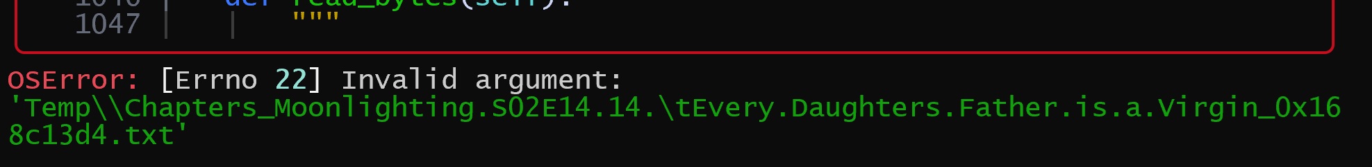

    I have started using your TwinVine program. Very good indeed, but I don't seem to be able to download anything from TPTV. I keep getting these errors. Wondering what I am doing wrong

    Originally Posted by QuantumLeap1989 View Post
    Hi Angela,
    Who knows. What were you doing before the issue started. The error message says a file is still in use - ?
    Try deleting the Temp folder and trying again.
    Or maybe aria2c (the downloader) is having issues with that service, (not unknown), then change the downloader in envied.yaml to something else.... n_m3u8dl_re is recommended. But be be prepared to switch these around. The fall-back that always works is 'requests', but it is s l o w .

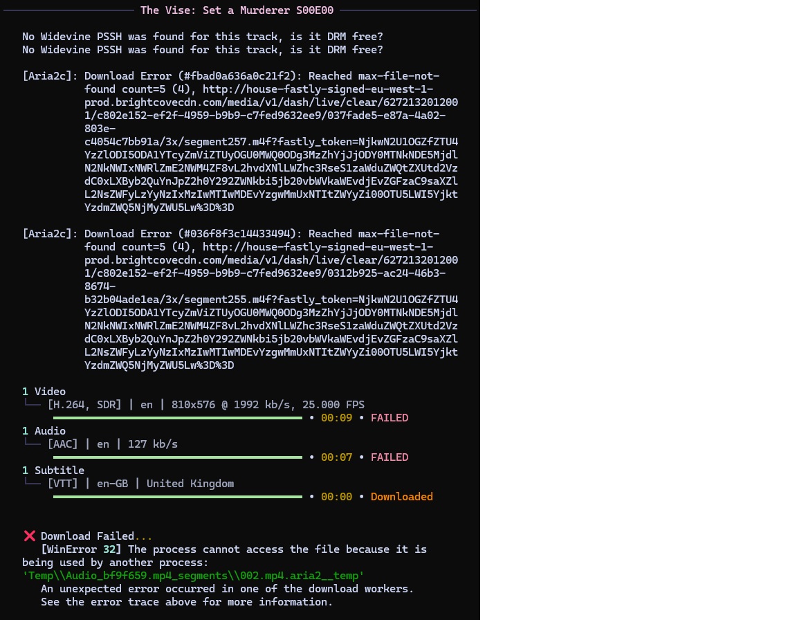

    Re above.
    Further investigation shows that unshackle/envied/TwinVine are requesting an extra segment for (Audio) streams and getting a 404 error. This is happening on Windows only possible because of how the arithmetic is performed calculating the number of segments to download.
    I use this 96 second video as an example https://tptvencore.co.uk/product/tpmov05255-6383511857112
    <?xml version="1.0" encoding="UTF-8"?>
    <MPD xmlns="urn:mpeg:dash:schema:mpd:2011" profiles="urn:mpeg:dash:profile:isoff-live:2011" type="static" mediaPresentationDuration="PT1M36.720S" minBufferTime="PT2.000S">
      <BaseURL>http://house-fastly-signed-eu-west-1-prod.brightcovecdn.com/media/v1/dash/live/clear/6272132012001/abc82a92-8430-4113-b7f9-2d63f9dc2ad9/</BaseURL>
      <Period>
        <AdaptationSet mimeType="audio/mp4" startWithSAP="1" segmentAlignment="true" lang="en">
          <Role schemeIdUri="urn:mpeg:dash:role:2011" value="main"></Role>
          <SegmentTemplate duration="285696" initialization="$RepresentationID$/init.m4f?fastly_token=NjkwYjhiM2JfY2FjNzhjYThlMWI0N2RmN2MxY2VmZWVlNGRkYTdiZTI3YzRkN2I4MmFlOGM3ZGMxZTJhY2Q1MGY4NzM5YWNlZV8vL2hvdXNlLWZhc3RseS1zaWduZWQtZXUtd2VzdC0xLXByb2QuYnJpZ2h0Y292ZWNkbi5jb20vbWVkaWEvdjEvZGFzaC9saXZlL2NsZWFyLzYyNzIxMzIwMTIwMDEvYWJjODJhOTItODQzMC00MTEzLWI3ZjktMmQ2M2Y5ZGMyYWQ5Lw%3D%3D" media="$RepresentationID$/3x/segment$Number$.m4f?fastly_token=NjkwYjhiM2JfY2FjNzhjYThlMWI0N2RmN2MxY2VmZWVlNGRkYTdiZTI3YzRkN2I4MmFlOGM3ZGMxZTJhY2Q1MGY4NzM5YWNlZV8vL2hvdXNlLWZhc3RseS1zaWduZWQtZXUtd2VzdC0xLXByb2QuYnJpZ2h0Y292ZWNkbi5jb20vbWVkaWEvdjEvZGFzaC9saXZlL2NsZWFyLzYyNzIxMzIwMTIwMDEvYWJjODJhOTItODQzMC00MTEzLWI3ZjktMmQ2M2Y5ZGMyYWQ5Lw%3D%3D" startNumber="0" timescale="48000"></SegmentTemplate>
          <Representation audioSamplingRate="48000" bandwidth="63000" codecs="mp4a.40.2" id="40b79809-8499-4742-90f0-fab571885baf"></Representation>
          <Representation audioSamplingRate="48000" bandwidth="96000" codecs="mp4a.40.2" id="f32be94e-3f82-4289-af02-648095ad0401"></Representation>
          <Representation audioSamplingRate="48000" bandwidth="127000" codecs="mp4a.40.2" id="7f00e12c-873a-415c-bb60-b0e7bc1f187f"></Representation>
        </AdaptationSet>
        <AdaptationSet mimeType="video/mp4" startWithSAP="1" scanType="progressive" segmentAlignment="true">
          <SegmentTemplate duration="150" initialization="$RepresentationID$/init.m4f?fastly_token=NjkwYjhiM2JfY2FjNzhjYThlMWI0N2RmN2MxY2VmZWVlNGRkYTdiZTI3YzRkN2I4MmFlOGM3ZGMxZTJhY2Q1MGY4NzM5YWNlZV8vL2hvdXNlLWZhc3RseS1zaWduZWQtZXUtd2VzdC0xLXByb2QuYnJpZ2h0Y292ZWNkbi5jb20vbWVkaWEvdjEvZGFzaC9saXZlL2NsZWFyLzYyNzIxMzIwMTIwMDEvYWJjODJhOTItODQzMC00MTEzLWI3ZjktMmQ2M2Y5ZGMyYWQ5Lw%3D%3D" media="$RepresentationID$/3x/segment$Number$.m4f?fastly_token=NjkwYjhiM2JfY2FjNzhjYThlMWI0N2RmN2MxY2VmZWVlNGRkYTdiZTI3YzRkN2I4MmFlOGM3ZGMxZTJhY2Q1MGY4NzM5YWNlZV8vL2hvdXNlLWZhc3RseS1zaWduZWQtZXUtd2VzdC0xLXByb2QuYnJpZ2h0Y292ZWNkbi5jb20vbWVkaWEvdjEvZGFzaC9saXZlL2NsZWFyLzYyNzIxMzIwMTIwMDEvYWJjODJhOTItODQzMC00MTEzLWI3ZjktMmQ2M2Y5ZGMyYWQ5Lw%3D%3D" startNumber="0" timescale="25"></SegmentTemplate>
          <Representation bandwidth="444000" codecs="avc1.420015" frameRate="25/1" height="270" id="b48ee666-5ea9-4704-8b70-a82dac708eb8" width="506"></Representation>
          <Representation bandwidth="689000" codecs="avc1.42001e" frameRate="25/1" height="360" id="2496d247-be7c-4252-8990-2b94cf99fb08" width="674"></Representation>
          <Representation bandwidth="886000" codecs="avc1.4d001e" frameRate="25/1" height="360" id="93e4c1e6-f615-436d-b594-8eb52a16beff" width="674"></Representation>
          <Representation bandwidth="1185000" codecs="avc1.4d001f" frameRate="25/1" height="540" id="0e80452c-f5bf-4d97-8fa4-1c0dab0dcca7" width="1012"></Representation>
          <Representation bandwidth="1679000" codecs="avc1.4d001f" frameRate="25/1" height="540" id="34d3cbc0-74c0-4e6e-aaf7-89fbec4c2a90" width="1012"></Representation>
          <Representation bandwidth="1978000" codecs="avc1.4d001f" frameRate="25/1" height="576" id="657359f7-a8cc-41e4-bf79-1eaad8951d8b" width="1080"></Representation>
        </AdaptationSet>
      </Period>
    </MPD>
    The calculation using data from above is
    mediaPresentationDuration = PT1M36.720S = 96.720 s total
    Video SegmentTemplate: timescale=25, duration=150. so 150/25 = 6.000 s per segment
    And 96.720 / 6.000 = 16.12
    ceil = 17 segments [indices 0..16 (since start number="0")] so if fails requesting sement17 - which is correct as it does not exist.
    Now why this should only happen with TPTV I am at a loss to even guess. All of the segment downloading is happening in the backend of unshackle/envied/etc
    Noob Starter Pack. Just download every Widevine mpd! Not kidding!.
    Feb 2022
    Search the forum first!
    TPTV should now work in Windows. The algorithm for counting media segments was over-counting by 1 for TPTV. Fix now up on https://github.com/vinefeeder/TwinVine#

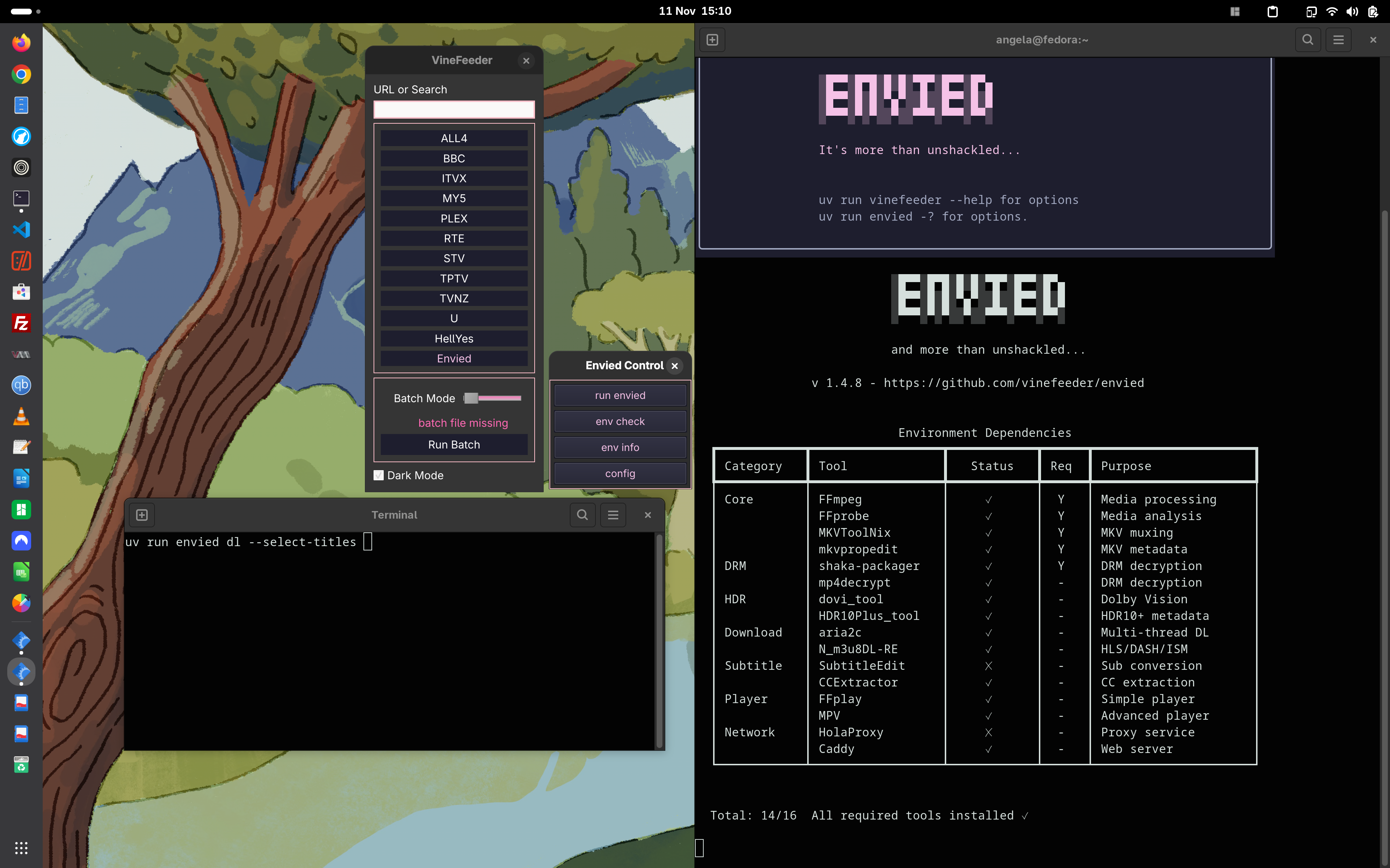

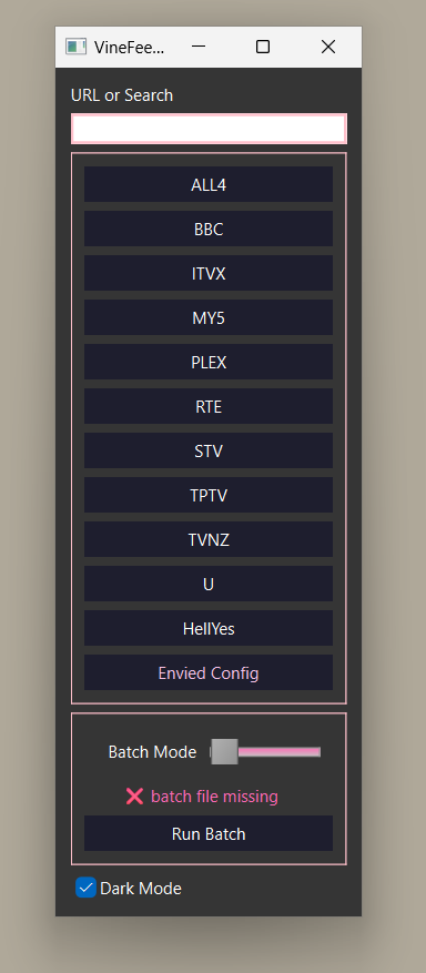

    TwinVine has had an update to the GUI. I needed to branch the gui for Linux vs Windows unfortunately. Linux users get a slightly better deal.
    An extra button has been added. Depending on OS, Linux will show a button called Envied - which when clicked will open another smaller gui to provide envied helpers. One button pre-populates a terminal window with "uv run envied dl --select-titles" and waits for completion with service and url. Two others run an env check and env info - for fast access to data. Config opens envied.yaml in your system's text editor.
    Windows - the button is called 'Envied Config' and clicking opens the envied.yaml in notpad.
    [Attachment 89678 - Click to enlarge]
    The windows vinefeeder gui
    [Attachment 89679 - Click to enlarge]
    Also this opportunity has been taken to update those services in TwinVine that SBB has recently posted.
    Twinvine is also receiving some help from a couple of users who are developing docker images for TwinVine - https://github.com/vinefeeder/TwinVine/issues/1
    TwinVine is at https://github.com/vinefeeder/TwinVine

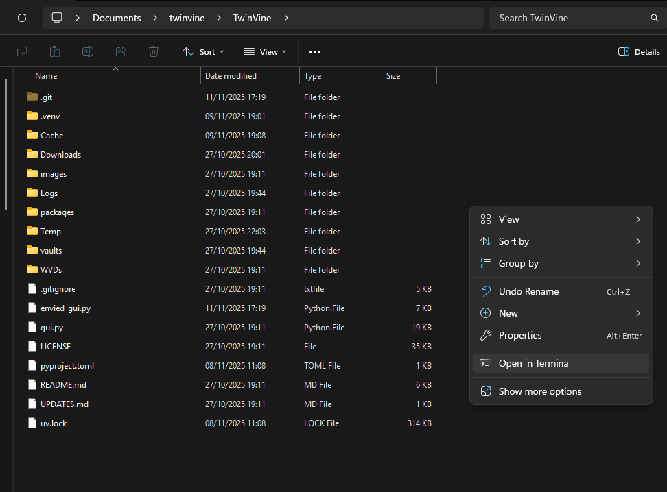

  19. Just installed this but how do I run his line ?
    cp packages/envied/src/envied/envied-working-example.yaml packages/envied/src/envied/envied.yaml
  20. Originally Posted by tvdownloaderfan View Post
    open terminal window in TwinVine folder
    [Attachment 89702 - Click to enlarge]
  21. Originally Posted by DsP27 View Post
    Yes and then what ?
  22. Originally Posted by tvdownloaderfan View Post
    Yes and then what ?
    then paste that line in terminal
  23. Originally Posted by DsP27 View Post
    Yes and then what ?
    Then ?

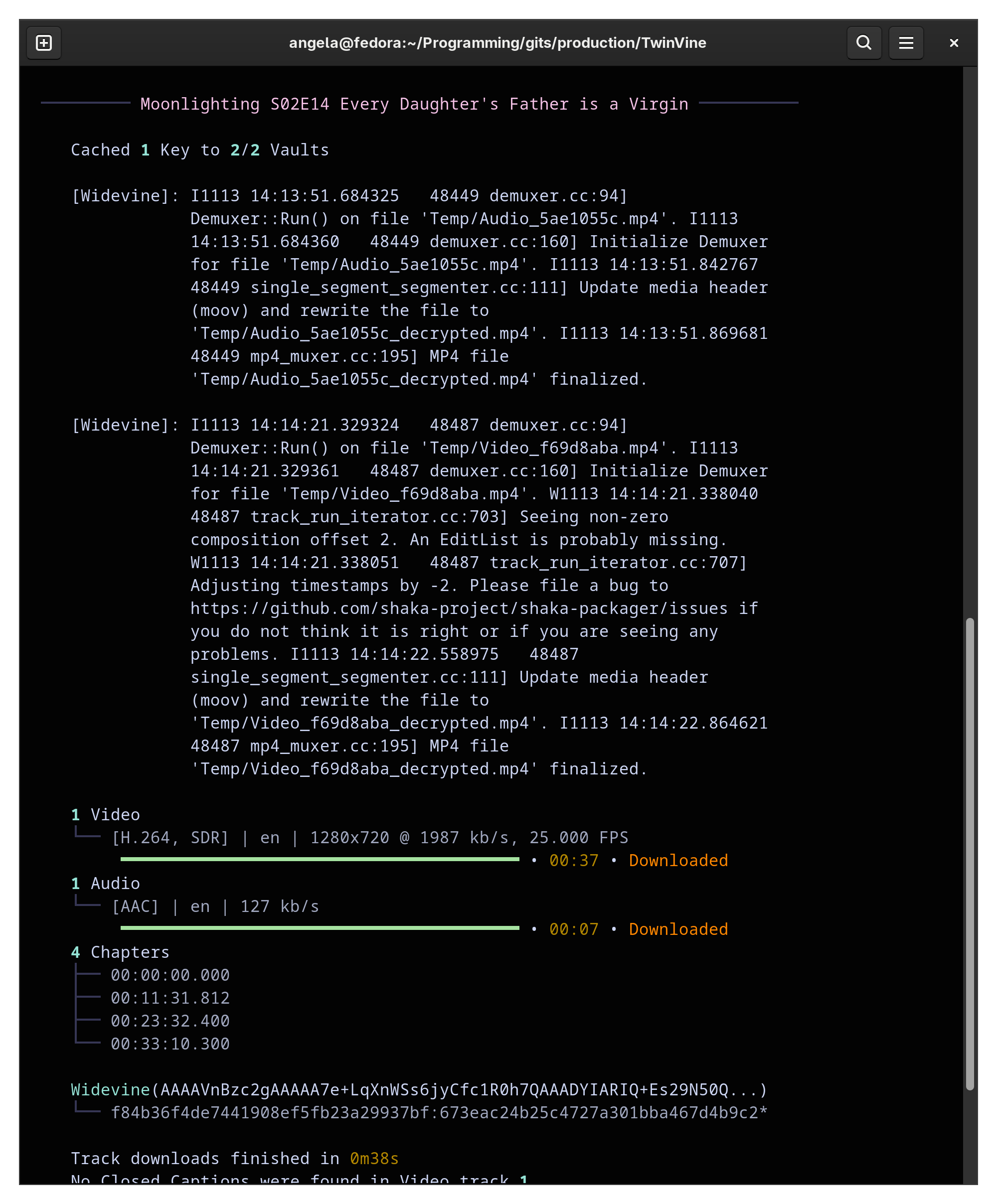

    But TwinVine gets it.
    [Attachment 89703 - Click to enlarge]

    strange... I get error because of / cant add on file name like... name,year,s02e14\tEvery.Daughters.Father.is.a.Virgin.web-dl.h264.aac2.0.
    [Attachment 89704 - Click to enlarge]
  30. Member
    Feb 2022
    Its probably vinefeeder being the pre-fetch agent that is helping. Vinefeeder gets the title urls for download and then only feeds envied/unshackle with a title-url at at time for direct download.
    I assume - but haven't checked - there is difference in the generated title-URL between vinefeeder and envied/unshackle. Happily vinefeeder gets the correct URL. The title has a ' (single-quote), unshackle is likely tripping over that.
