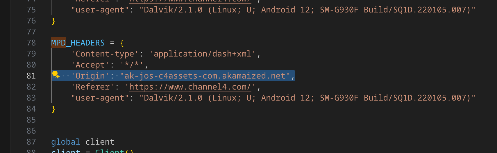

That was easy fix just needed this line adding to C4.py at UK-FTA/ukfta/c4_dl/
exactly like in the image below.Code:'Origin': "ak-jos-c4assets-com.akamaized.net",
[Attachment 88351 - Click to enlarge]
I'm in the process of pushing the fix to github https://github.com/vinefeeder/UK-FTA but you might not want the hassle of downloading everything. A quick in-place edit may do it for you.

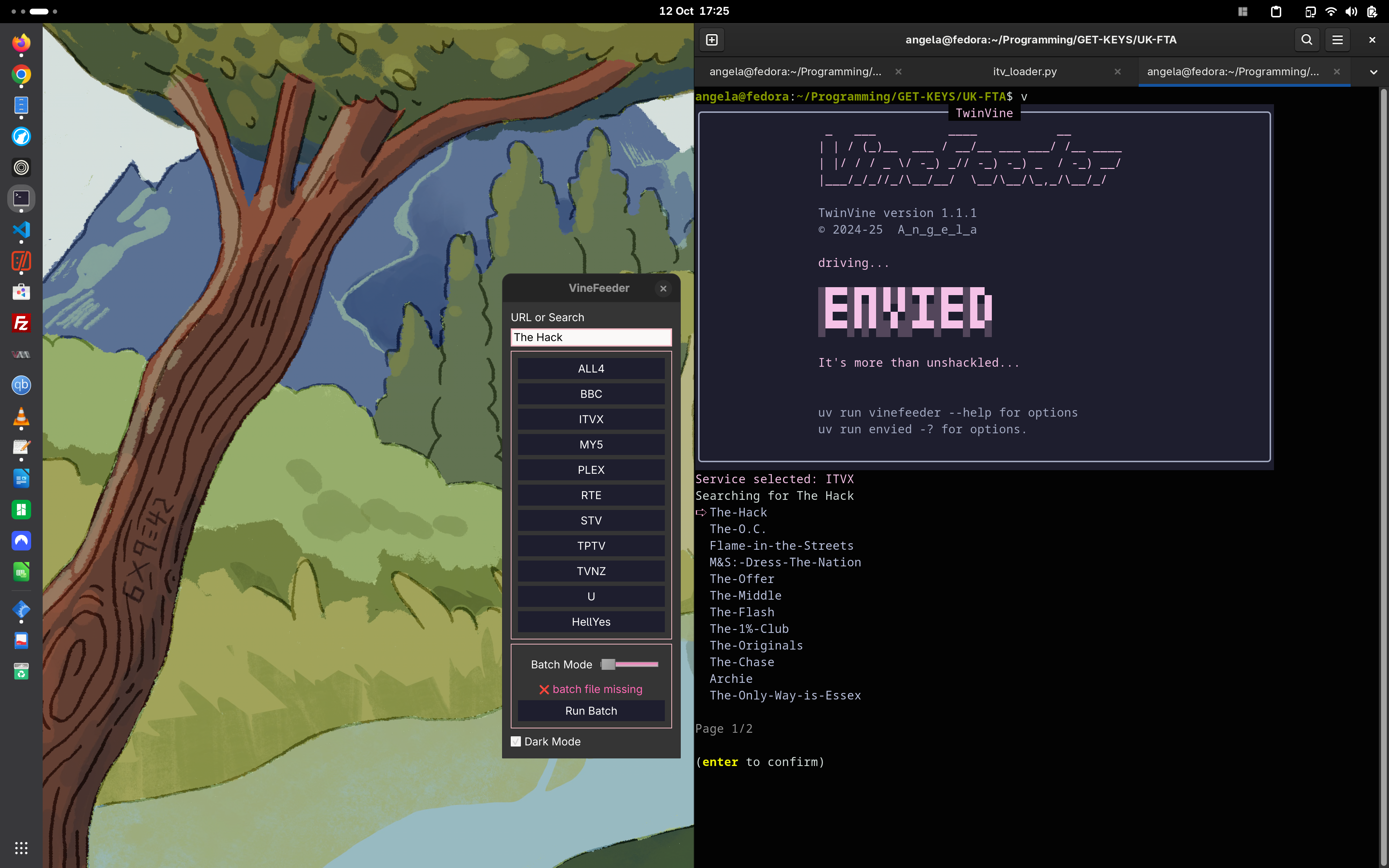

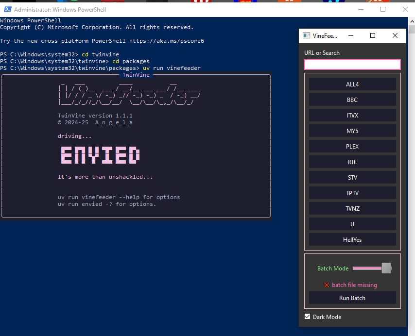

For those whom have grown to like, and even expect, a GUI interface I prepared VineFeeder. It needs a separate install and it could call Devine for all the UK-FTA channels from a GUI. That is still a good solution - as VineFeeder on its own can be set to call Devine or Unshackle or Envied. But it needs a system wide install - a uv tool install for unshackle and envied. That presents a barrier for some users.
A natural progression has been to create TwinVine: an all-in-one uv package install for VineFeeder and Envied -> TwinVine. Complete; runs out of the box except for one file rename.
If you regularly use ALL4 BBC ITVX MY5 STV TPTV TVNZ U Then VineFeeder is your start tool.

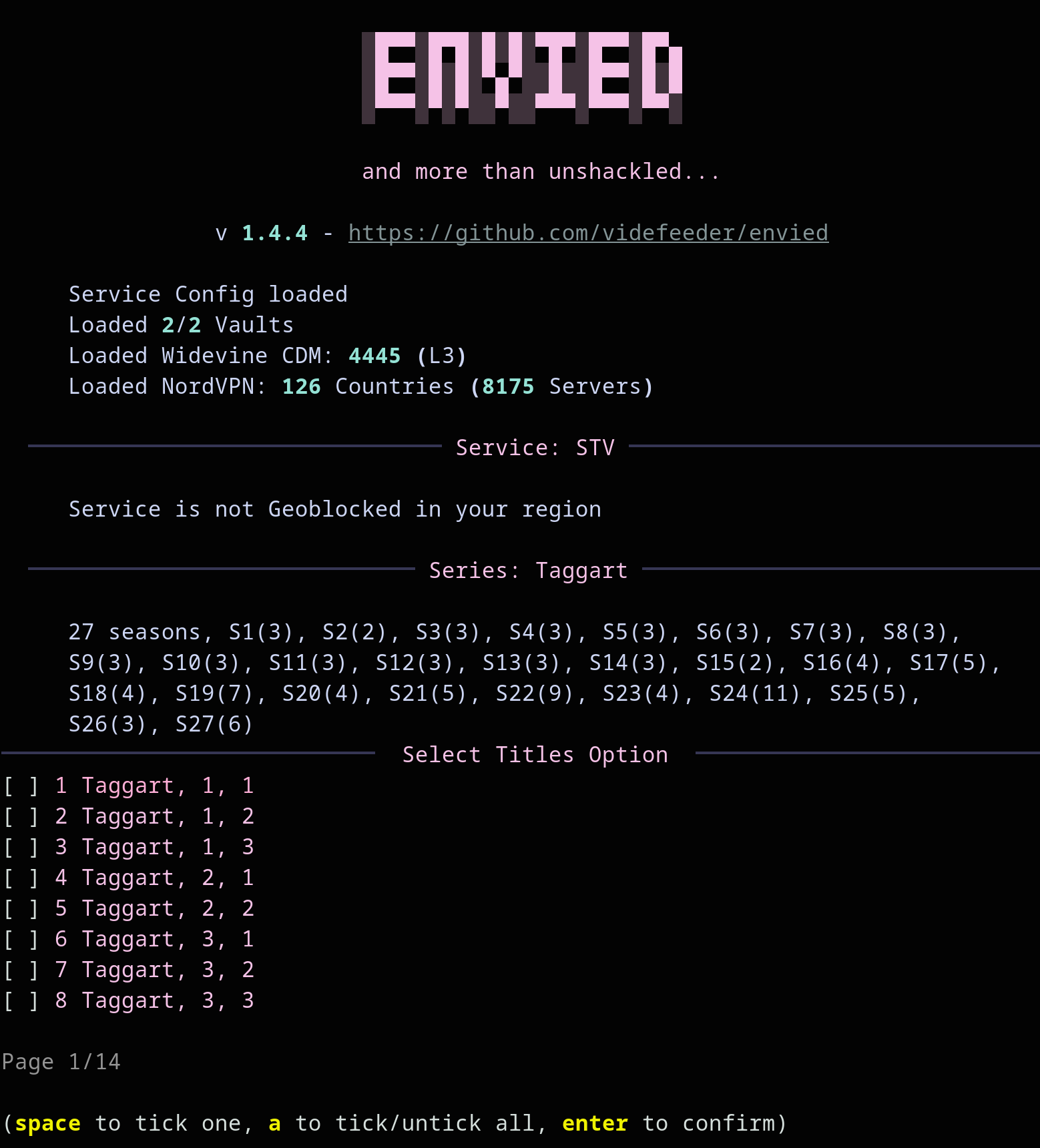

If you want to direct download from the command line but maybe select-titles too for any of:
ALL4 AUBC CBS DSCP iP MAX MY5 NF PCOK ROKU SPOT TPTV TVNZ YTBE
ARD CBC CTV DSNP ITV MTSP NBLA NRK PLUTO RTE STV TUBI UKTV ZDF
Then envied will be your choice.
[Attachment 88601 - Click to enlarge]
The option --select-titles does away with the need for -w S03E11 to get the latest offering in the series you are following. Is it up to 11 or is 12 now? Select-titles brings the convenience of a selecting from a list. Giving you an interface easier for the user - rather than the developer.
Twinvine may be installed byA working envied yaml is at Twinvine/packages/envied/src/envied/envied-working-example.yaml - change its name to envied.yaml and you are now ready to go!Code:git clone https://github.com/vinefeeder/TwinVine.git cd TwinVine uv clean uv lock uv sync
orCode:uv run vinefeeder
Code:uv code run envied env info

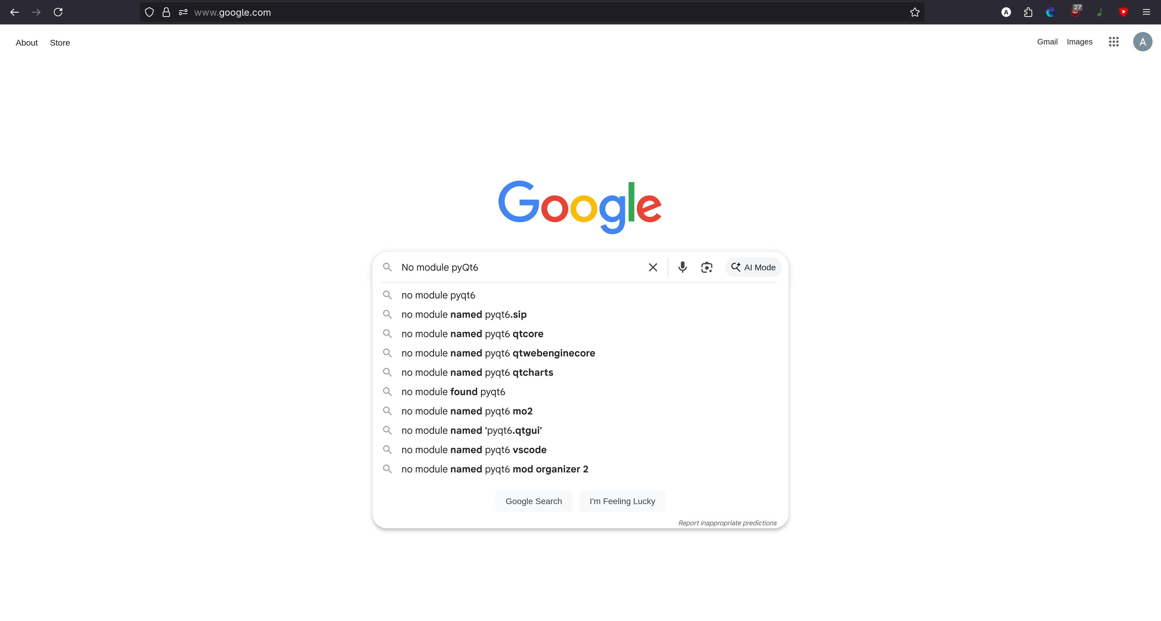

My UK-FTA has stopped working. I am getting the following error:
File "C:\Users\*****\Downloads\uk-fta_16_1\UK-FTA\gui.py", line 4, in <module>
from PyQt6.QtWidgets import QApplication, QWidget, QPushButton, QVBoxLayout, QLabel, QHBoxLayout, QCheckBox
ModuleNotFoundError: No module named 'PyQt6'
Any help with this will be greatly appreciated. -

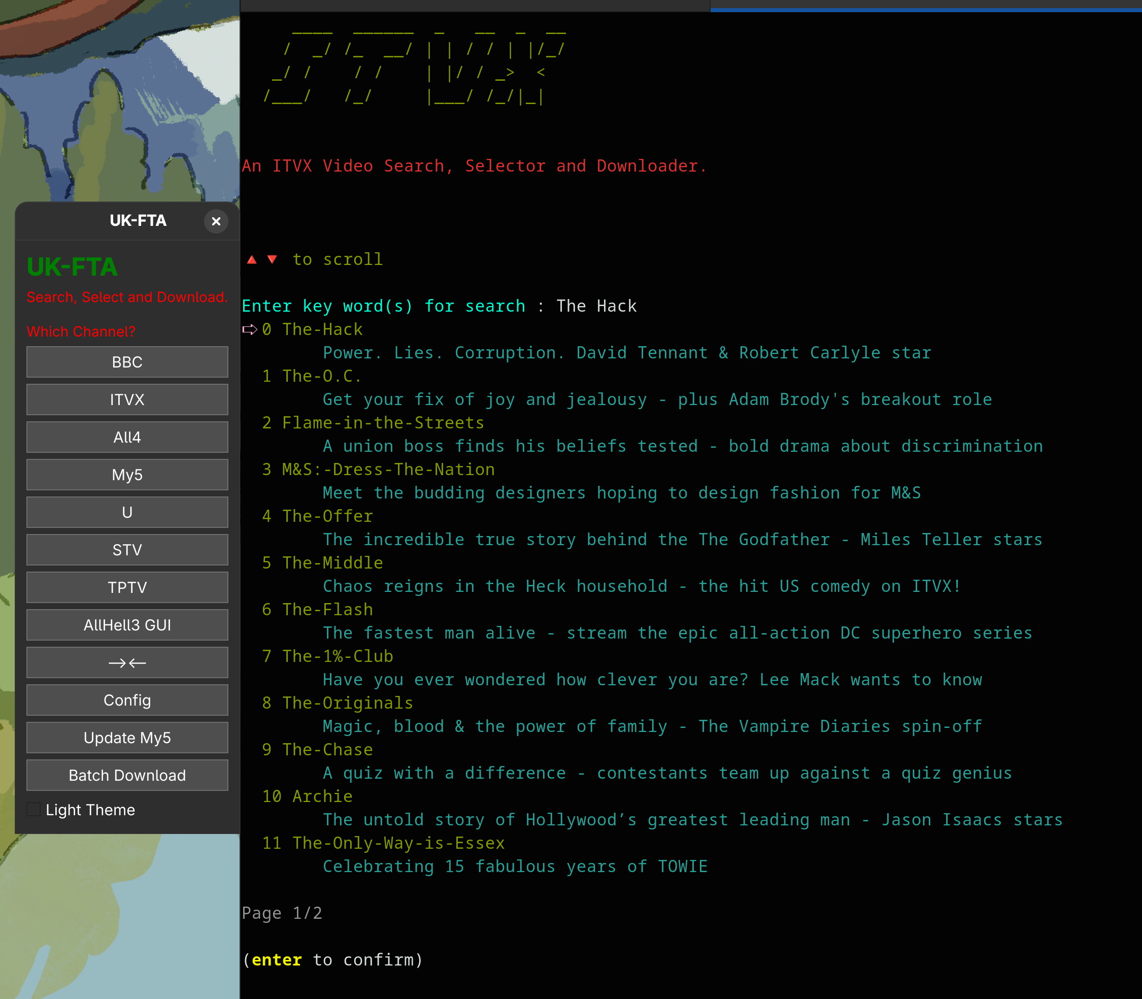

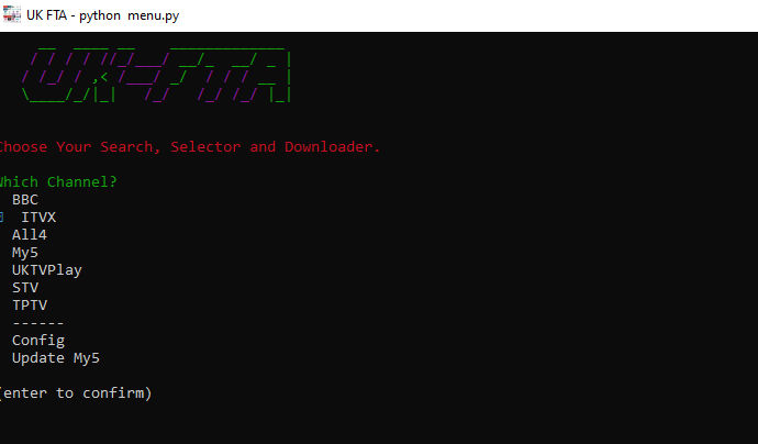

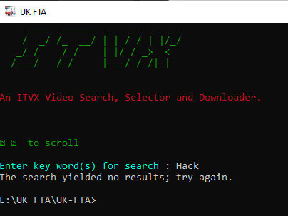

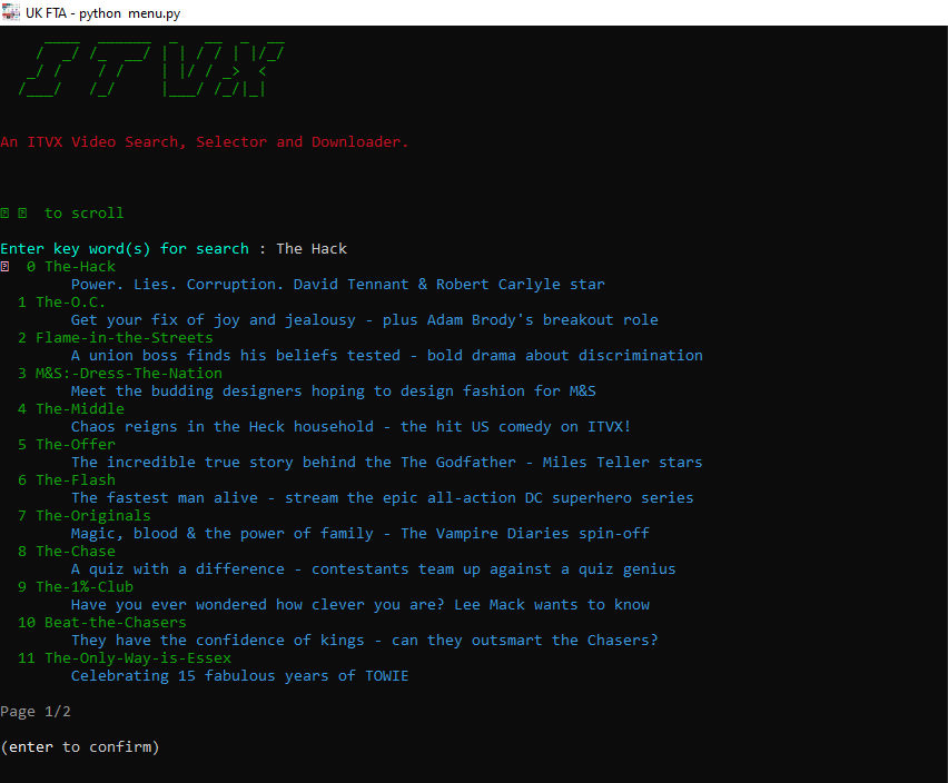

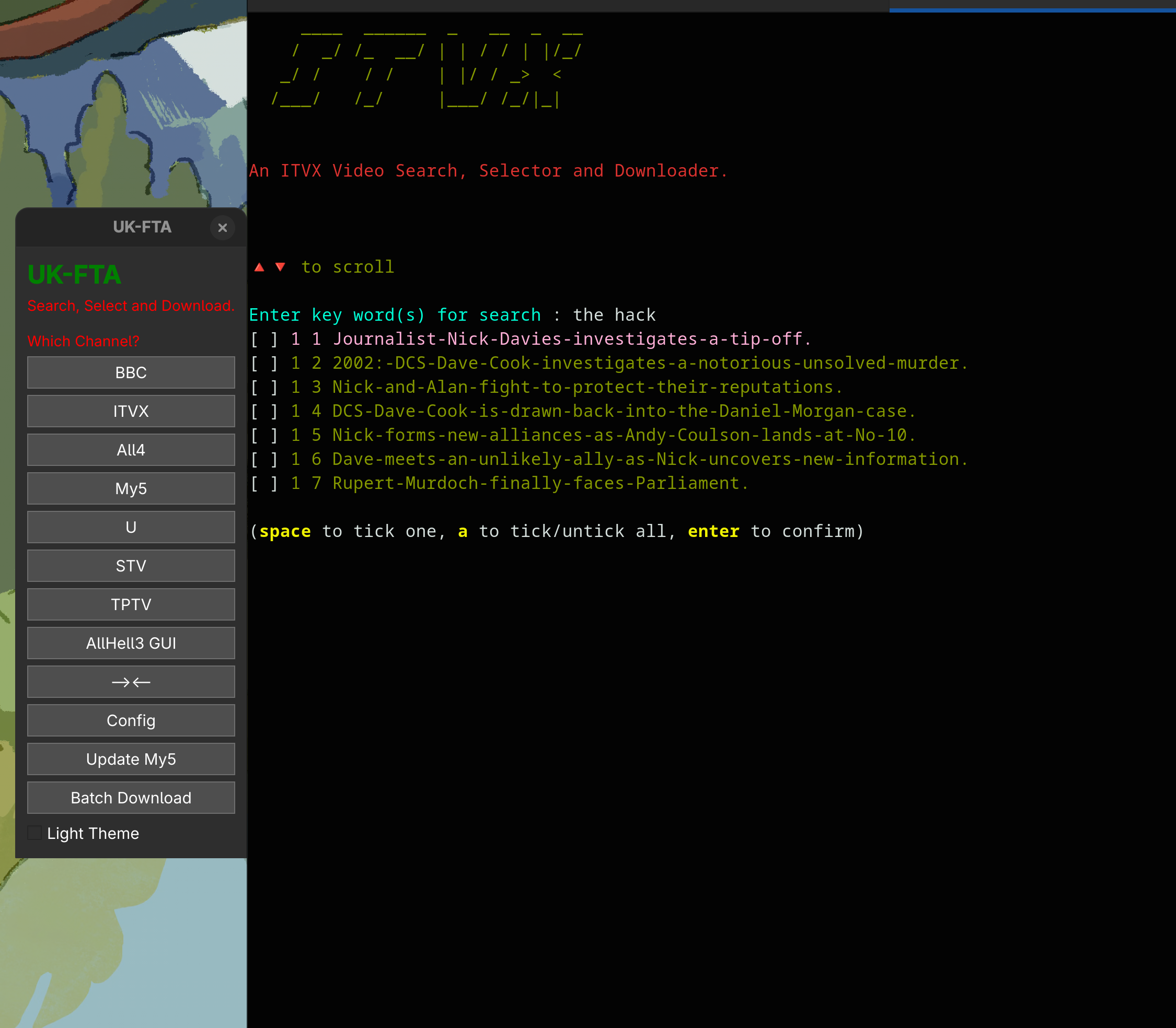

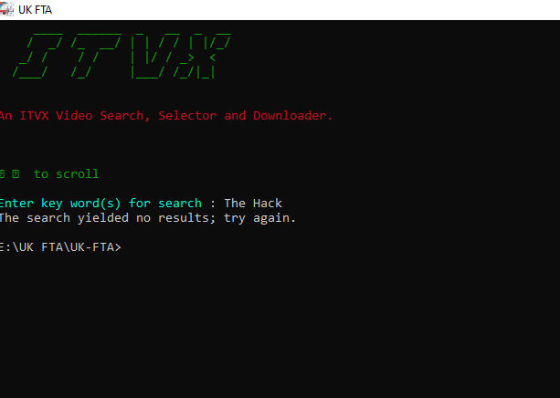

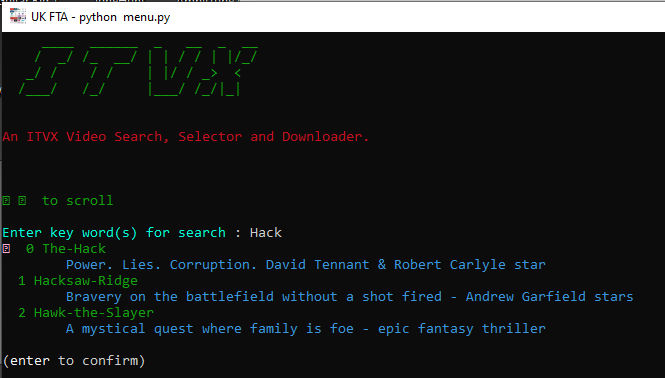

I am in need of some help to get up and running again. I thought I would give the Twinvine thing a go and followed the instructions in the post to download and install. However, I am presently unable to get this to work. In the meantime, this also seems to have broken my UK-FTA as well. The problems with both seems similar so I am sure they are related. Basically here is what I have going on:
1. UK-FTA
Ok, so let’s say I want to find The Hack on ITVX: Search by keyword produces the following:
[Attachment 89143 - Click to enlarge]
As you can see it correctly finds The Hack as the first listed result. However it now does not give me the “spacebar to select” option, and instead only has the “enter to confirm" option. On pressing enter I get “The search yielded no results; try again”.
I get the same result regardless of what I search for.
[Attachment 89144 - Click to enlarge]

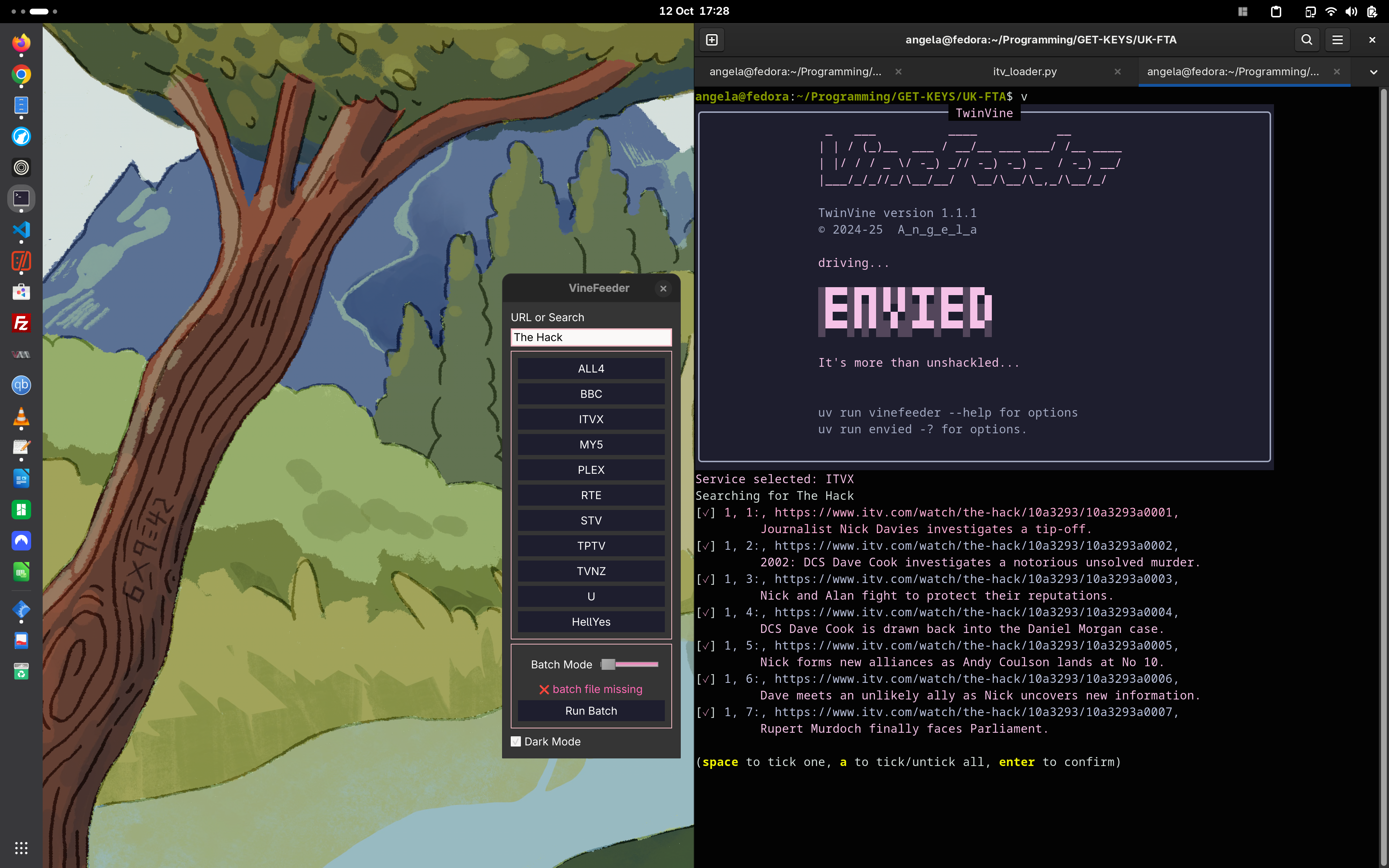

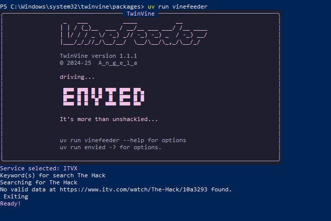

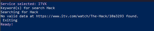

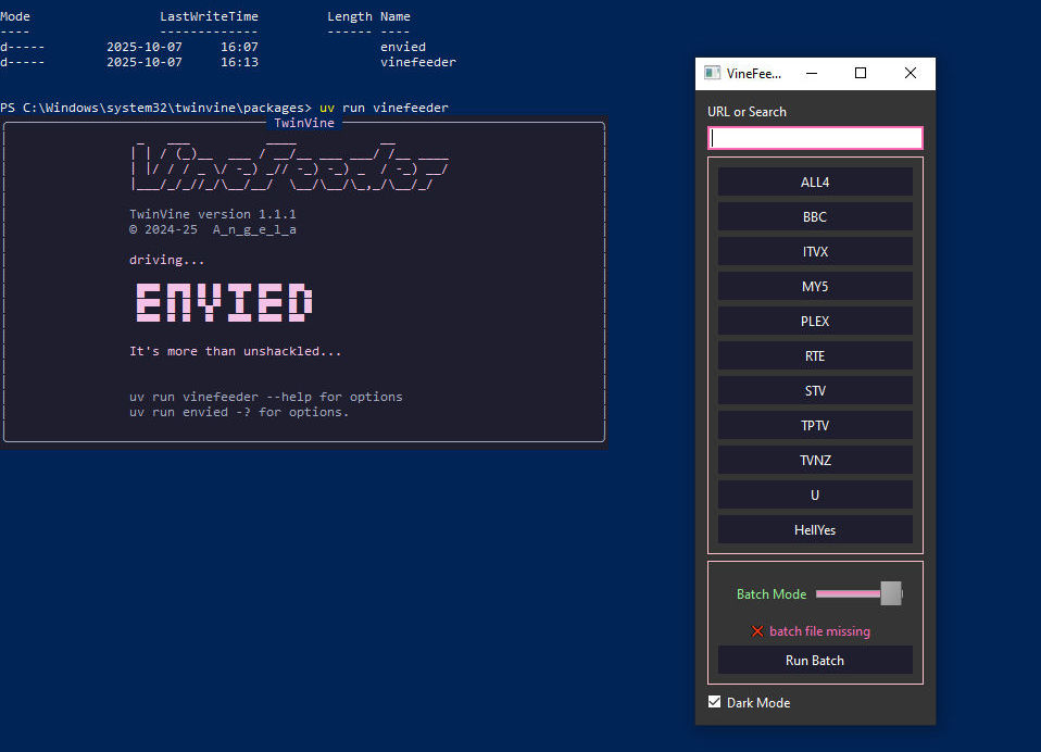

2. Twinvine
Trying to find The Hack on TwinVine:
[Attachment 89145 - Click to enlarge]

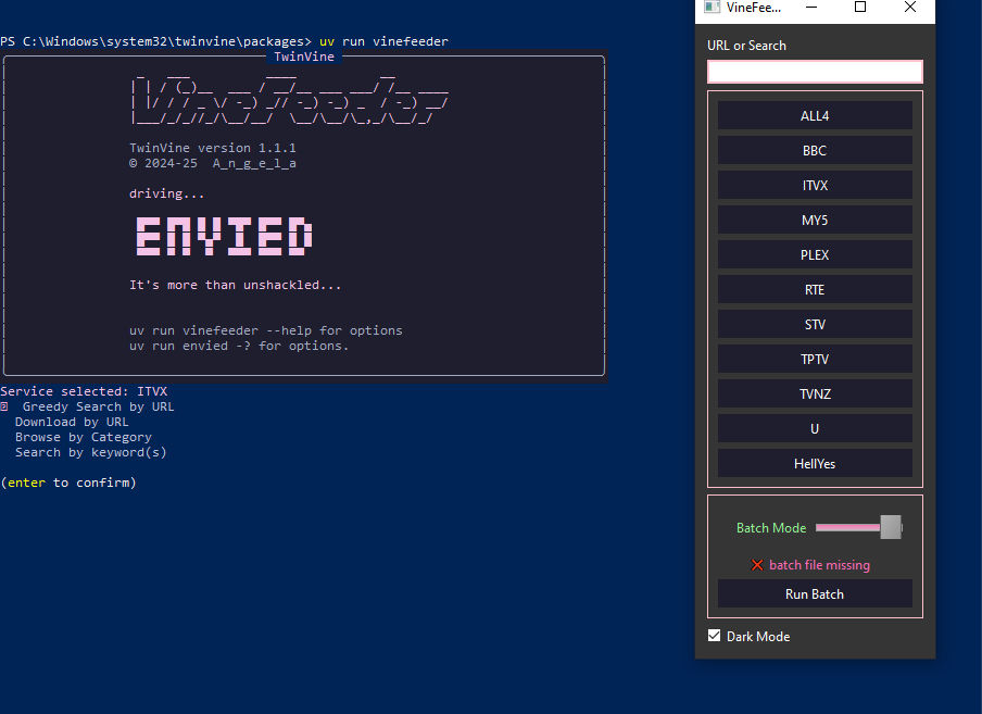

Click on ITVX from the GUI
In the PowerShell window using the arrow keys select the option “Search by keyword”
Enter “Hack”
Again the correct search results are returned:

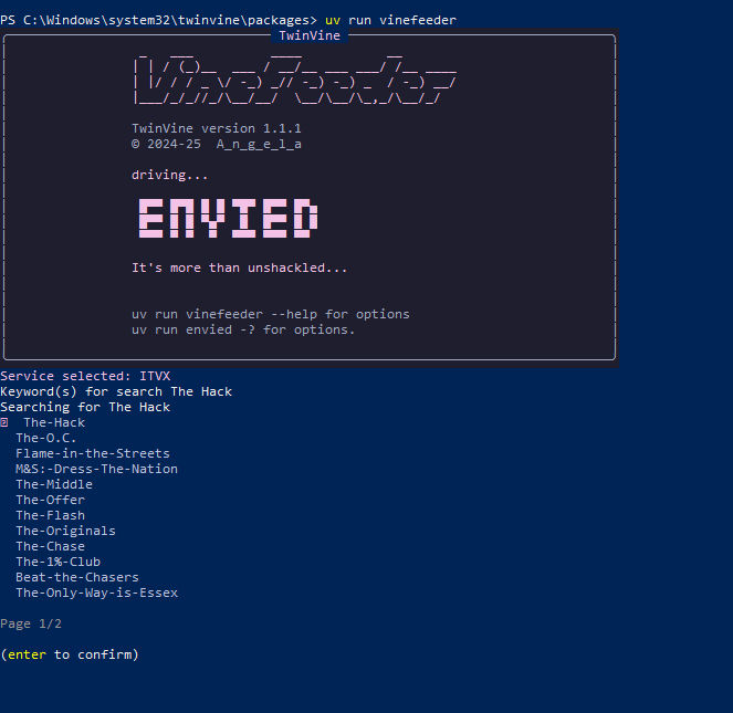

Again the only option is “enter to confirm”
[Attachment 89146 - Click to enlarge]

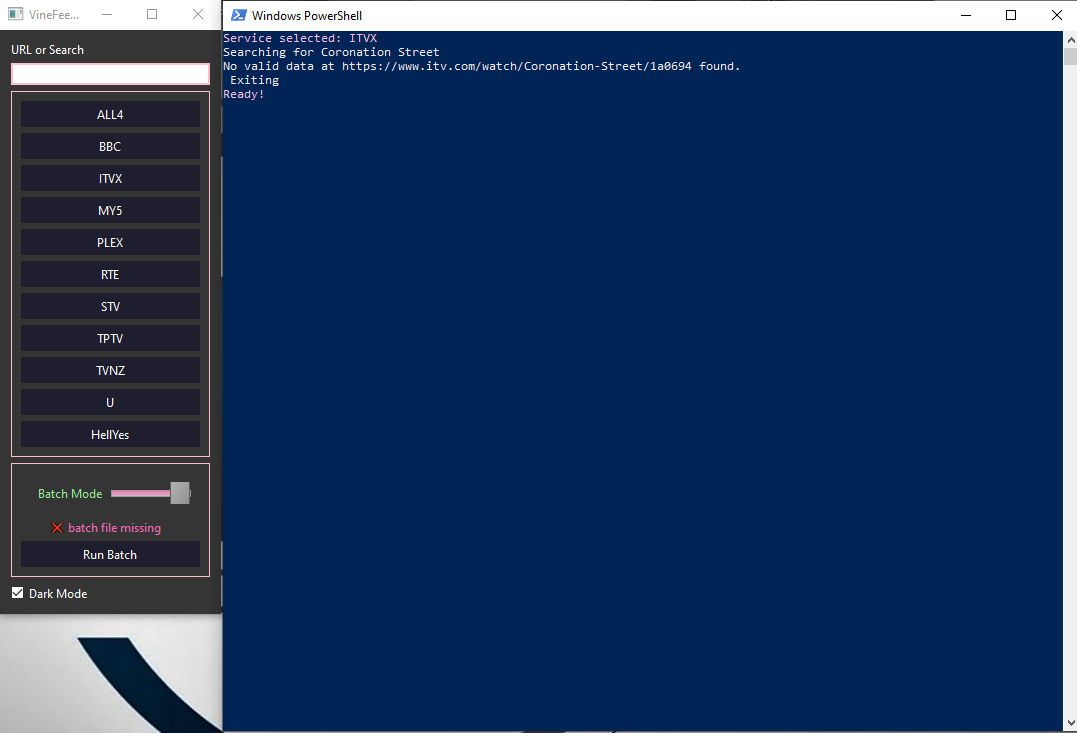

After pressing “enter” nothing happens for around 10 secs then get the message “No valid data at https://www.itv.com/watch/The-Hack/10a3293 found.”
Exiting
[Attachment 89147 - Click to enlarge]
The url is correct for the programme in question:
I am getting the same results for anything I search for. I would really appreciate some pointers in getting either UK-FTA or TwinVine or both back up and running again!

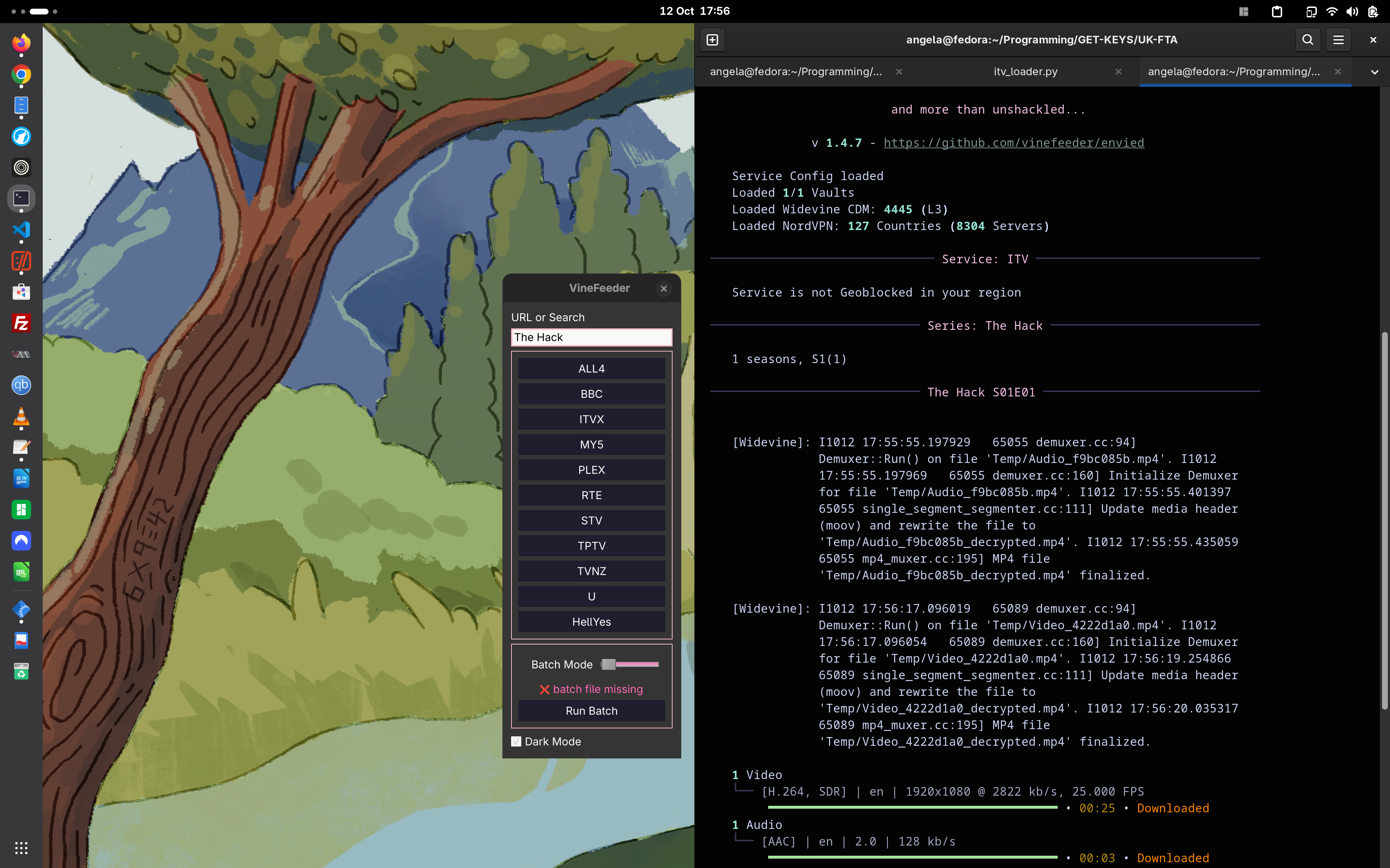

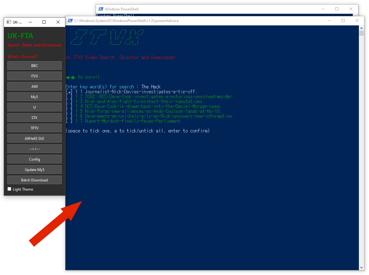

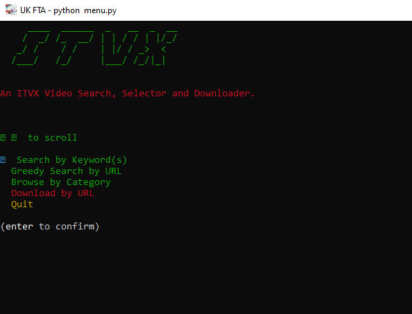

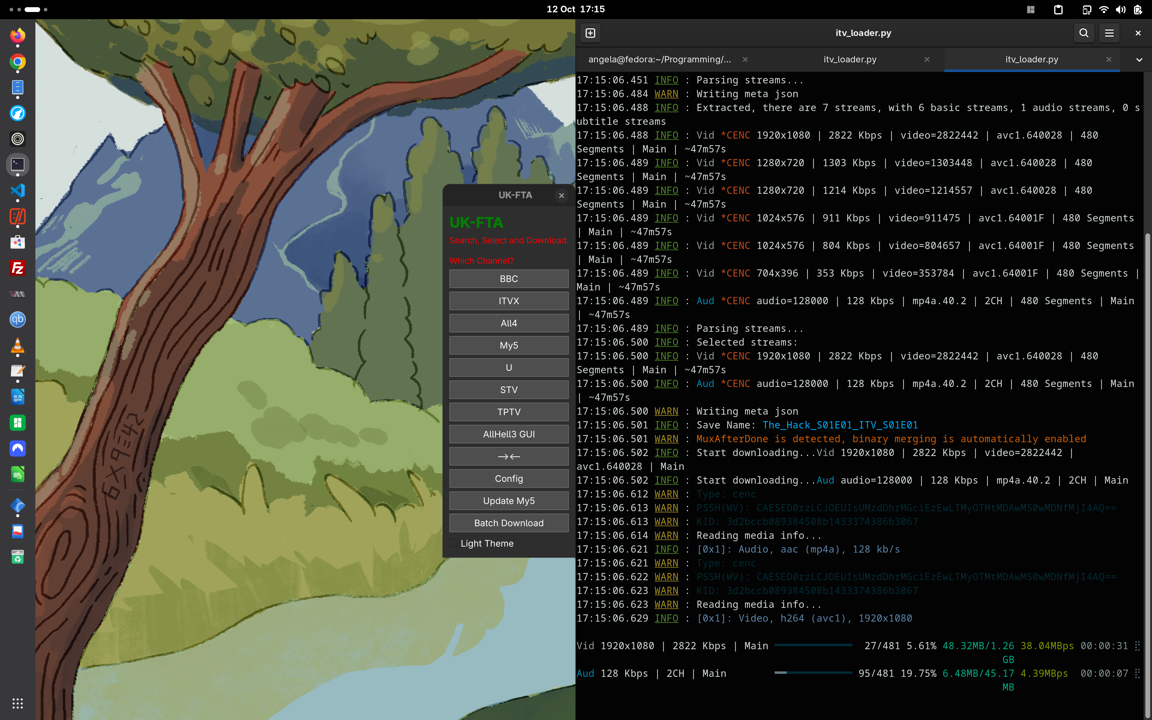

Try expanding the size of your powershell window - you cannot see stuff because it is cut-off. You are also selecting a single item so use the arrow keys to move the caret to your selection and press return
UK-FTA
[Attachment 89157 - Click to enlarge]
[Attachment 89158 - Click to enlarge]
[Attachment 89159 - Click to enlarge]

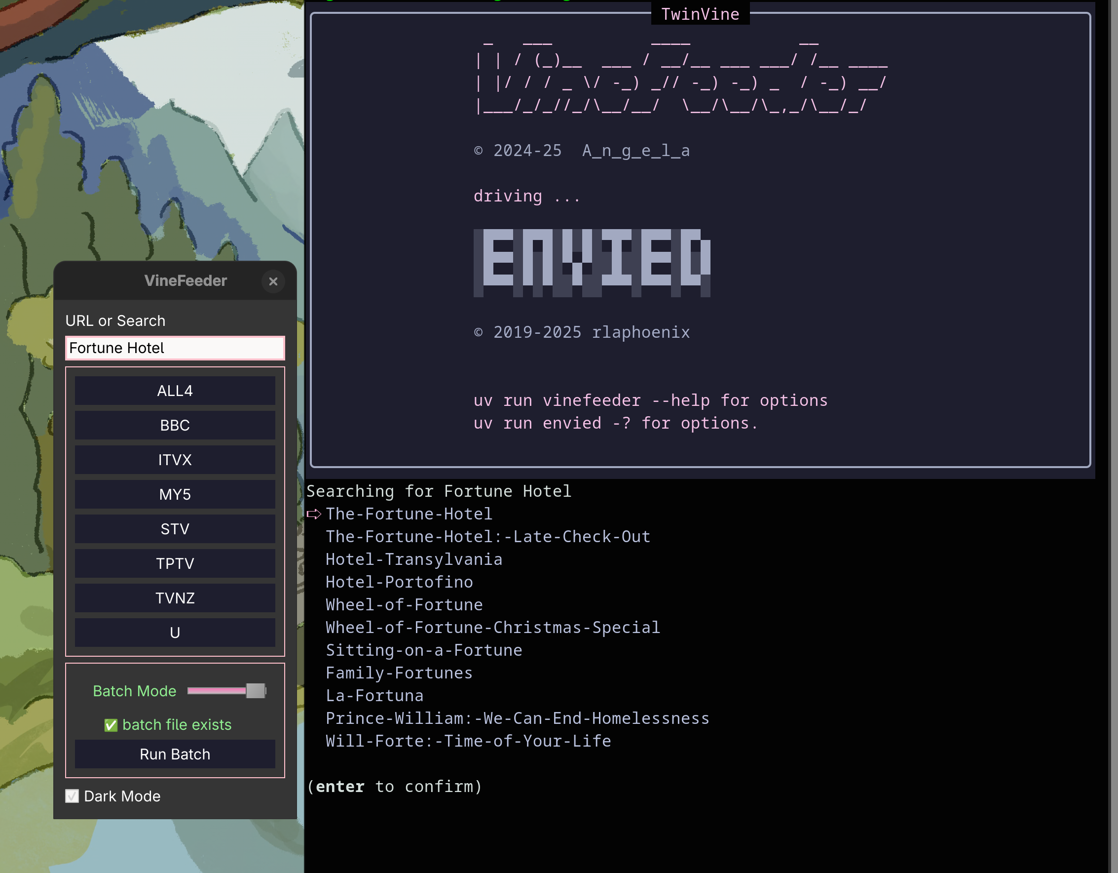

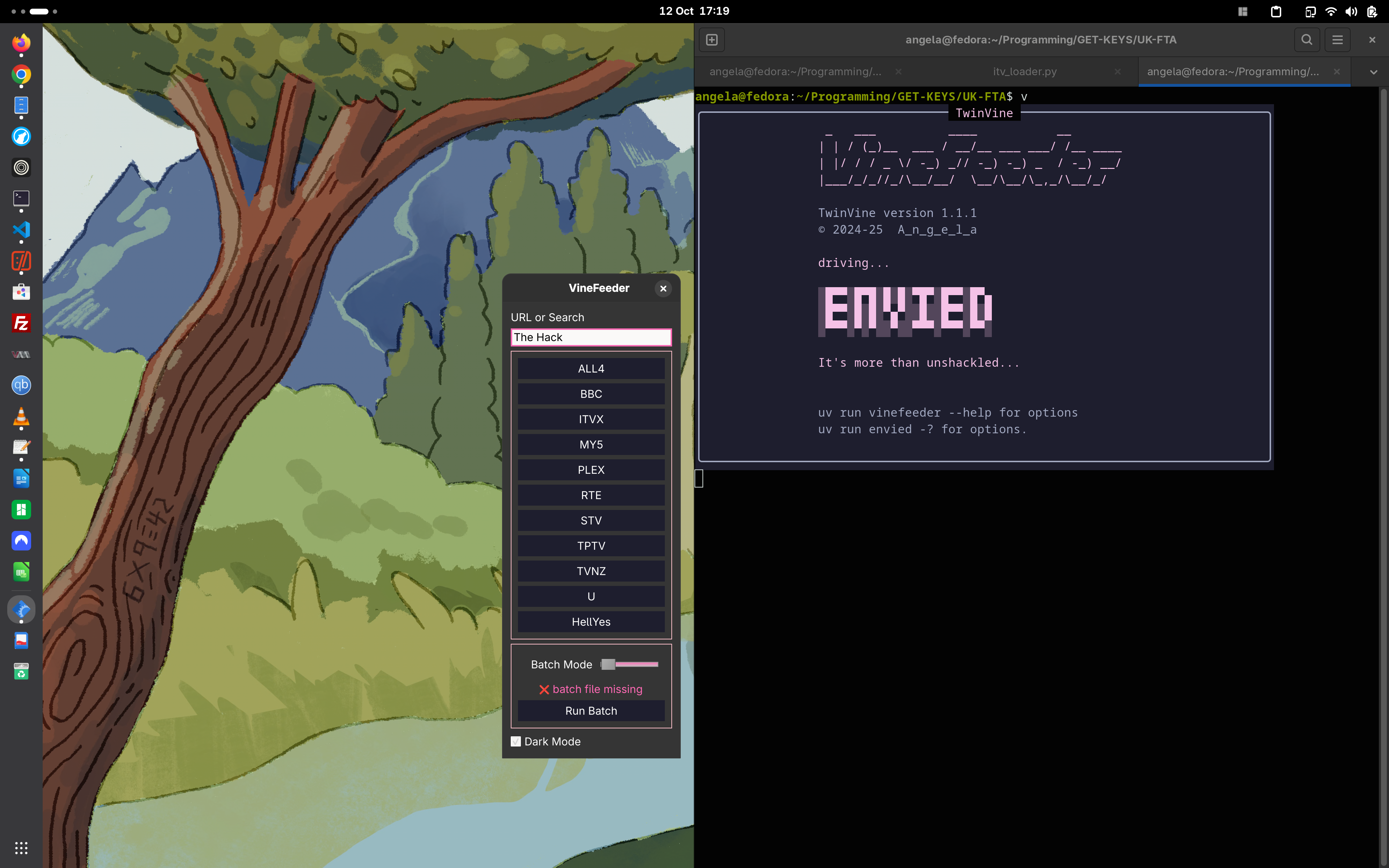

2. TwinVine
Use the search boxas your entry point! As in the following image..and use full titles; 'The Hack' works better than 'hack' - that's ITV not me.

Hi Angela and thank you for responding to my thread. I went through the steps again both with UK-FTA and TwinVine and I am getting the same result – i.e. after the search initially finds results matching with the keyword, when I go to the next step, it cannot find the stream to download.
Something must have got broken during my installation on TwinVine as UK-FTA was working OK before.
Again here is my exact step by step process for both UK-FTA and TwinVine:
1. UK-FTA
Start UK-FTA and select ITVX from the menu using the arrow keys and then Enter
[Attachment 89171 - Click to enlarge]
Select “Search by keyword” from the menu by pressing Enter
[Attachment 89172 - Click to enlarge]
Enter The Hack as search string, press Enter and the search results are displayed as follows:
[Attachment 89173 - Click to enlarge]
With the caret on the first option (correct search result), press Enter. After a few seconds I get the message : “The search yielded no results; try again.” and the UK-FTA closes:
[Attachment 89174 - Click to enlarge]
2. TwinVine
In Windows PowerShell start TwinVine using “uv run vinefeeder”
[Attachment 89175 - Click to enlarge]
Using the mouse click on ITVX in the GUI and in the PowerShell window I get the search options.
[Attachment 89176 - Click to enlarge]
Using the arrow keys, move down to select “Search by keyword(s)”. Enter the search string The Hack, and the search results are displayed as follows:
[Attachment 89177 - Click to enlarge]
With the caret on the first option (correct search result), press Enter. After a few seconds (about double the time it takes for the same step in UK-FTA) I get the message :
Exiting
Ready!
[Attachment 89178 - Click to enlarge]
So something is going wrong in the step between the search (finds the list) and selecting anything from these results for download – I get the same results if I try any other item on the search results list. Any ideas on what is going wrong? -

I've reworked the terminal search routine. https://github.com/vinefeeder/TwinVine If you installed previously using git clone ... then in the TwinVine folder just run
to updateCode:git pull

Hi Angela – apologies for not making myself clear. Let me try and explain more: I am trying to fault find why UK-FTA is failing, even after a fresh install on a different computer I am still experiencing the same issues – for example:
I search for a series and it is found and then it displays the available individual episodes.
I can select an episode for download, however when I click enter to start the download, the PowerShell Window closes.
I see a lot of text posted in the PowerShell window just before it closes but it is too fast to read or capture.
My question was is there anyway to prevent this PowerShell window from automatically closing when the programme is crashing?
The PowerShell window I mean is as shown below – this window opens after clicking on a channel in the GUI. After it crashes only the GUI is displayed along with the original PowerShell window from where I ran the python gui.py command to start UK-FTA.
[Attachment 89459 - Click to enlarge]Last edited by peterjung; 29th Oct 2025 at 21:31.

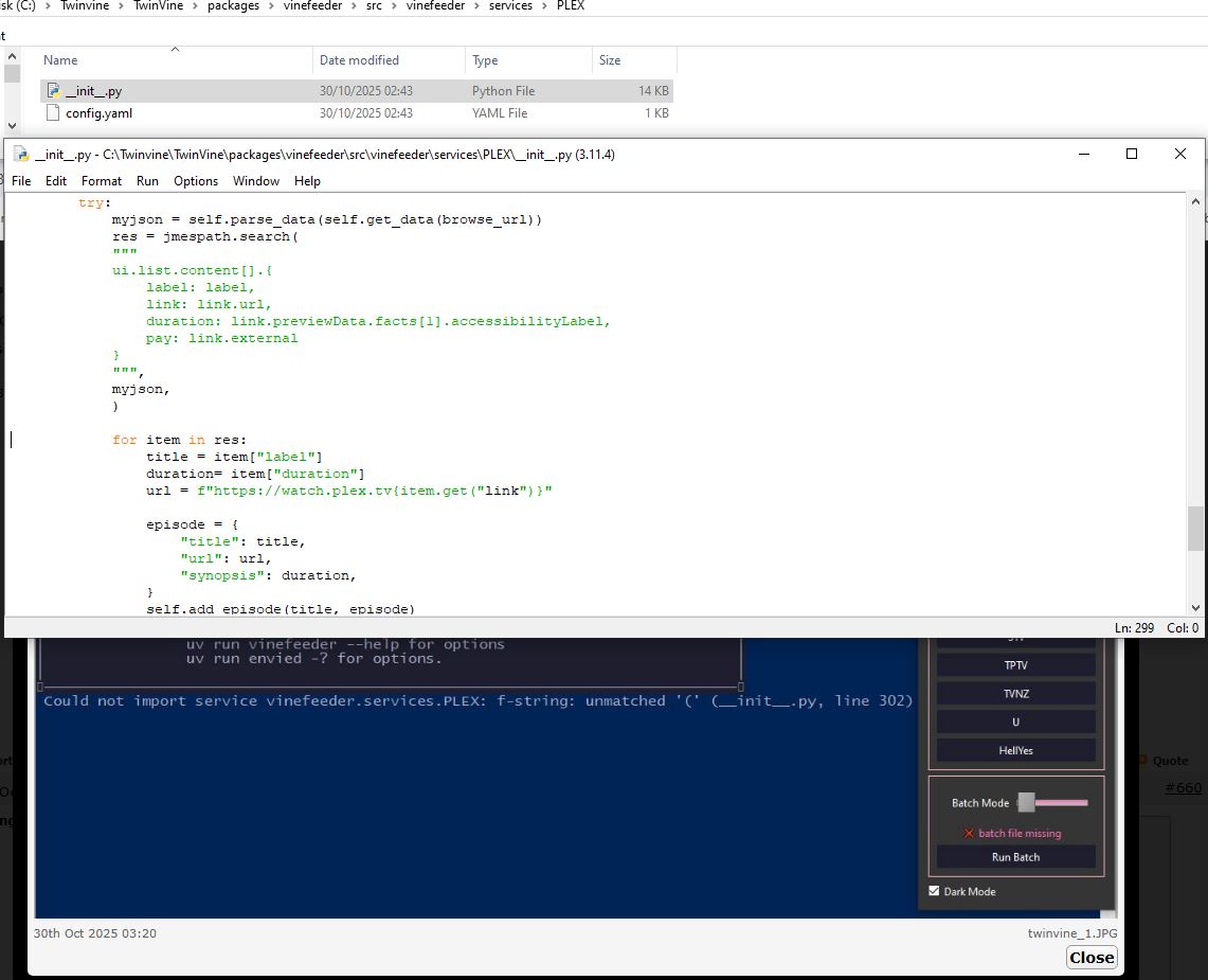

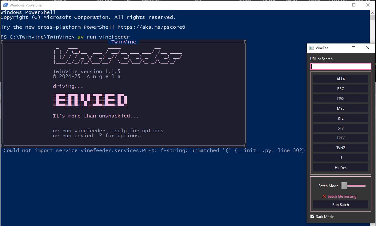

Hi Angela,
I thought I would go with the flow and try and keep up with the latest and greatest. installing twinvine was okay. created a folder on my C drive called Twinvine, and ran your instructions from the cmd prompt. oddly it made another twinvine folder inside. but I can deal with that later. I edited my yaml to add 4od email and password. but (there's always a but) when i ran uv run vinefeeder from powershell i had an unusual error appear. Hoping you could explain what it may mean. please see image:
[Attachment 89460 - Click to enlarge] Thank you for advice and help. And really appreciate your hard work.
a bit more digging and this is as far as i got. (not really sure why i got the error about plex, because I wasn't even searching for anything on plex).
[Attachment 89496 - Click to enlarge]
I have no idea what is wrong with line 302... i doubt if there is anything wrong with line 302,.... everything installed fine with no errors at all. I test a random D/L from 4od and it worked fine apart from saying something about aria2c not being compatible... or words to that effect. but it still downloaded fine.Last edited by LastResort; 30th Oct 2025 at 21:32. Reason: image update

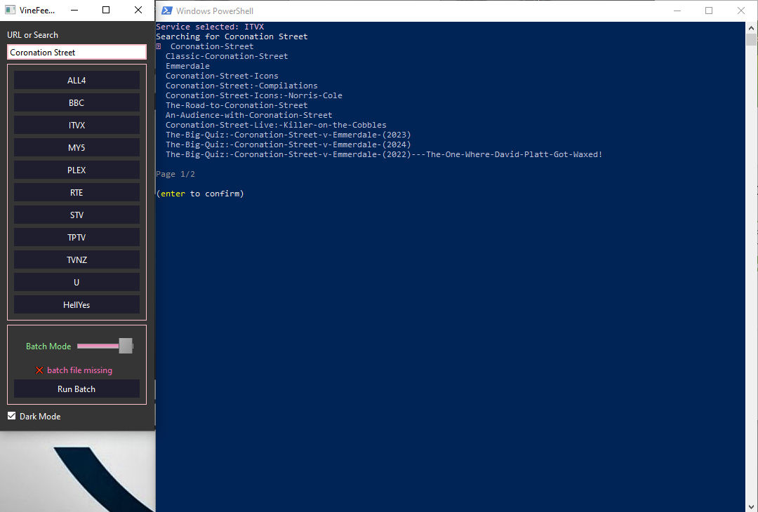

For the record - with ITVX here is what I see:
In GUI:
Make sure Batch Mode is On
In the search box type a keyword - for example Coronation Street and then click the ITVX button:
The various series are listed as below:
[Attachment 89465 - Click to enlarge]
However when I select one - in this case the first option - I get "No valid data at https://www.itv.com/watch/Coronation-Street/1a0694 found"
[Attachment 89466 - Click to enlarge]
This is consistent for anything on ITVX - however as I mentioned the same can be found and downloaded from STV without any issues! Very happy to be back up and running again!
Thanks again for developing and maintaining this great resource!
