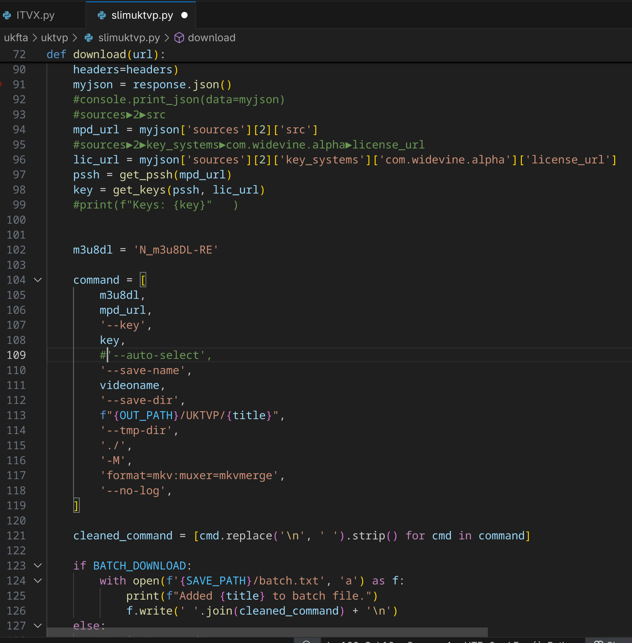

    Originally Posted by vidsrme View Post
    Thanks a lot for the script, I'm downloading S15 of american pickers https://u.co.uk/shows/american-pickers/series-15/ and it auto downloads 1080p which is cool, but is there any way to choose 720p instead?
    My first reaction was to laugh. You can write scripts; you can keep them updated; but you can never satisfy everyone.
    Do this: find the file UK-FTA/ukfta/uktvp/slimuktvp.py and edit it in notepad or gedit, make sure your editor gives you line numbers. Go to line 109 and put a
    # in front of 'auto-select', so it looks like the line in the image
    [Attachment 87635 - Click to enlarge]
    Now when run N_m3u8DL-RE will pause and allow you to select video, audio and subtitle download options.

  14. Originally Posted by A_n_g_e_l_a View Post
    Thanks very much I understand your sentiment about everyone always wanting the best quality (normally me included) but there are certain use cases (this one for example where there are 15+ seasons of a show) where 1080p over 720p makes a big difference over total file size, e.g atm I have over 140 americn pickers episodes and choosing 720p saves me in the region of 50-70gb of space.
