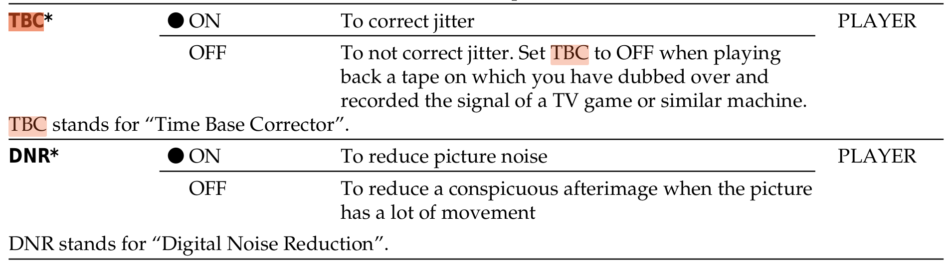

    Edit-2
    On p-131
    TBC on/off
    DNR on/off

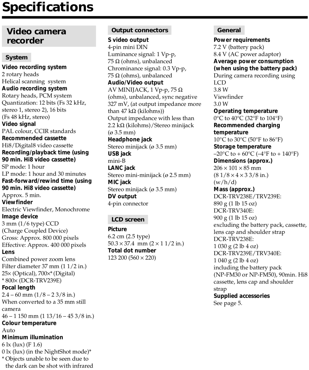

    on p-251
    Specification
    S-video output

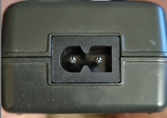

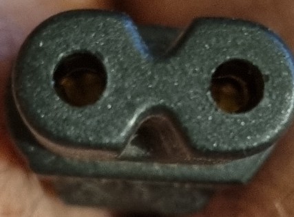

    That camcorder, specs-wise, is just what you need. It has S-Video out, Firewire, a TBC and DNR and plays all 8mm tapes.
    What accessories do I need? Please advise.
    The battery is charged when it is installed on the camcorder. The cable to the camcorder is fixed/attached to the power adapter. The other cable is from the wall socket to the power adapter and it's a standard two-socket lead commonly used for many electrical gadgets such as boom boxes/ghetto blasters and VCRs:
    Adapter-end of mains lead:
    [Attachment 74225 - Click to enlarge]
    Socket on adapter for mains lead:
    [Attachment 74226 - Click to enlarge]
    One end of the adapter comes from Mains power, the other end goes to the camcorder for power and charging.
    So, provided the actual power adapter is supplied and you can get a mains cable with an end as shown above, you'll be good to go.

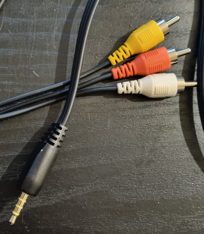

    The other cable you will need is the A/V combo lead, for any analogue video transfers, to get audio out. This model (and some other D8s) have the small tri-pole Red/White/Yellow combo cable:
    [Attachment 74230 - Click to enlarge]
    This one works on my Canon camcorder and also my Sony TRV330 (similar layout to yours), so I assume they are reasonably generic. If you don't get one with your camcorder, you should be able to purchase one.

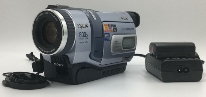

    Hi all,
    While waiting the seller's reply.
    I found another camcorder on ebay;
    Sony Digital Handycam DCR-TRV110E PAL 8mm Video8 Hi8 Digital8 Camera Camcorder
    Price is about 30% cheaper
    Accessories included:
    Camcorder carrying bag
    Battery charger
    Battery
    Remote control
    connecting cables - such as A/V cable etc
    2 unused V8 tapes, still packed
    The camcorder is quite new with original packing box displayed. According to seller's information that the camcorder was owned by his father, only using it about 10 times.
    Which of them is a newer model?
    Please advise. Thanks in advance.
    Regards
