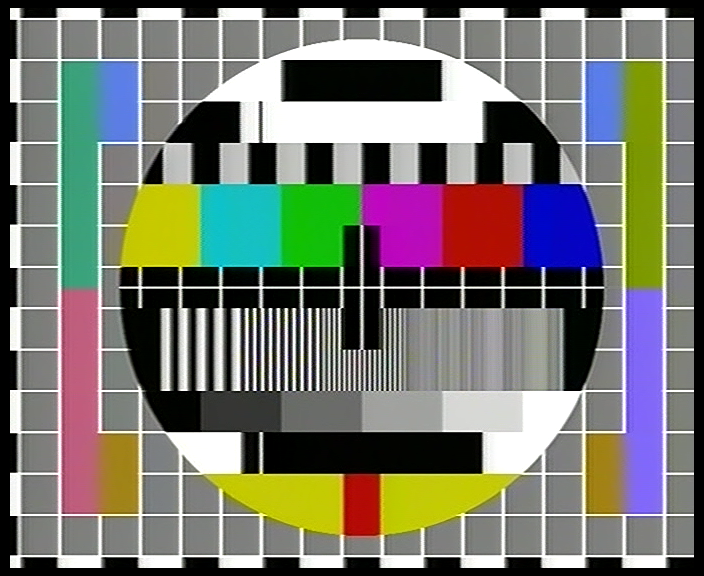

  1. I noticed some noise on the image when capturing VHS. It looks like dot crawl but not quite?
    It happens when:
    -Capturing random tapes to MiniDV via firewire and shielded s-video.
    -DVD player - to VHS - back to DVD combo capture. All by using a thick, shielded SCART RGB cable, i've opened it.
    I can get a better image after filtering, but just would be cool to know why this happens..
    The sample is captured via that scart cable. As you can hear, there's no buzzing sound that unshielded scart cables have.

    That looks about normal for VHS quality especially if the recording VCR is a low end budget VCR using a low grade blank tape.
  3. What do you mean it's low end? The vcr has almost the same quality as a NV-FS1000, at least i didn't notice much of a difference between them. And the crawling happens on lots of tapes.
    I don't mean the noise, which obviously is there on anything analog, but look in the cyan color. There's a similar artifact to dot crawling, just blurrier.
  4. With a bit of post processing:
    I don't think you understood my post. Do you know the original recording VCR is not a low end?
    If you are recording this yourself try S-Video, there is no RGB in VHS, Either composite or Y-C (S-Video). If using SCART you are most likely recording from composite.

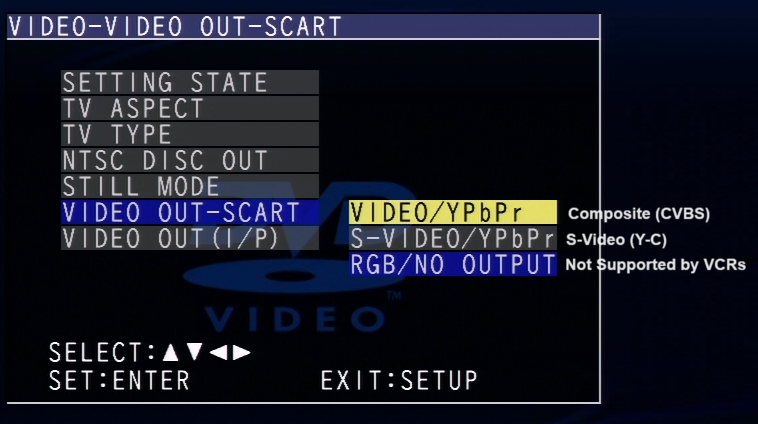

  14. Capturing Memories dellsam34's Avatar
    Jan 2016
    Here is how that menu works, See the screenshot below, When you select the top option you are sending composite out, the second option is S-Video, the third option is not supported by a VCR, Hope this clears up the confusion you have:
    [Attachment 74191 - Click to enlarge]

    Yes. Your sample in post#1 looks like composite. You clearly see the dotcrawl (and rainbows) which is typical for Composite video with poor luma/chroma separation (poor separating filter). Your DVD recorder has most probably a setting for switching a 3D comb filter (or similar naming) ON which will widely eliminate the luma/chroma crosstalk of the composite signal (if you can't use S-video throughout your setup).

    You're still confused, let me try to get through your thick wall of confusion:
    SCART is a multi signal cable, it has 21 pins, Some of them are inputs, others are outputs. SCART can carry composite, S-Video, and component (RGB or YPbPr), In the menu I posted above for your DVD model:
    1- If you select Video, you get composite signal in the SCART cable, the VCR senses composite and records it.
    2- If you select S-Video, you get S-Video signal in the SCART cable, the VCR senses S-Video and records it.
    3- If you choose RGB, the VCR will fall back to composite and records it, because it cannot record any type of component tri-signal, Even your DVD recorder senses the VCR cannot accept it and disables it.
    If you are still confused, I'm afraid that you will never get it. It is what it is sometimes. But just take our word for it, choose option #2.
