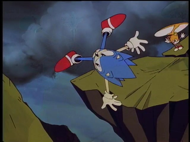

    Hi, I downloaded a video file which seemingly has some frame blending/ghosting. It's very subtle. My general question is, what's the simplest way to remove this? Any help would be appreciated. Thank you for your time.

  4. Here's theory. A source frame from that video:
    [Attachment 74119 - Click to enlarge]
    Subtracting some of the previous frame eliminates a lot of the ghosting (but creates negative ghosting in some other frames):
    [Attachment 74120 - Click to enlarge]

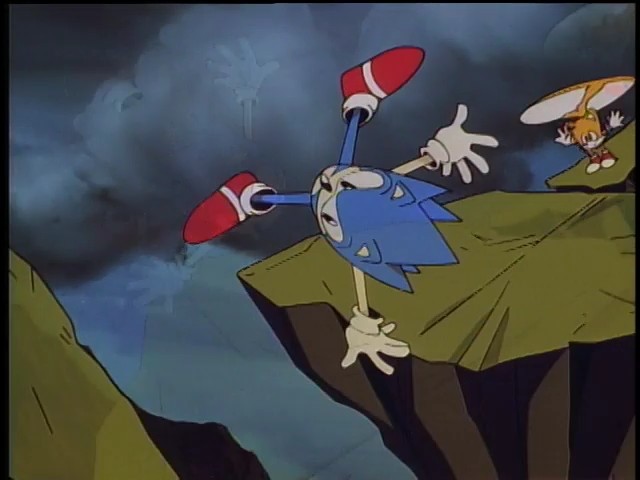

    Following that with a strong temporal filter removes more of the ghosting (and some small details, and may cause some ghosting of its own):
    [Attachment 74121 - Click to enlarge]
    LSmashVideoSource("CLIP.mp4")
    ColorYUV(off_y=-11)
    Overlay(last, Loop(2,0,0).Blur(1.0), mode="subtract", opacity=0.07).ColorYUV(gain_y=10, cont_u=11, cont_v=10)
    ColorYUV(off_y=11)
    SMDegrain(thsad=500, thsadc=500, tr=2, PreFilter=1)
    Unfortunately the blending in your source is not consistent. Some frames are blended and some not. And there are (at least) two different types of blending (the full frame blend in those sample frame, plus some partial frame blending in other frames). It's going to be very hard to remove without causing worse problems. I would look (or wait) for a cleaner source.
