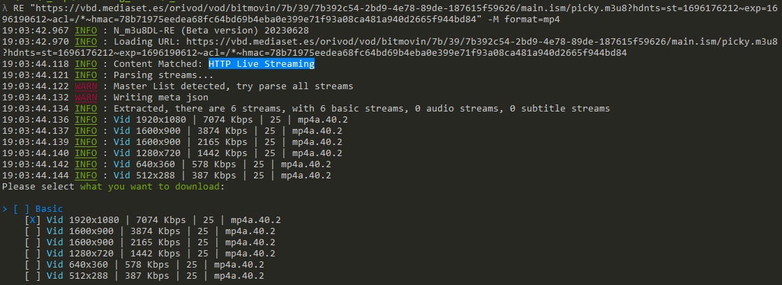

    I put this
    N_m3u8DL-RE "https://vbd.mediaset.es/orivod/vod/bitmovin/7b/39/7b392c54-2bd9-4e78-89de-187615f59626/main.ism/picky.m3u8?hdnts=st=1696176212~exp= 1696190612~acl=/*~hmac=78b71975eedea68fc64bd69b4eba0e399e71f93a08c a481a940d2665f944bd84 -M format=mp4"
    but it doesn't do anything, I get an error. What would the link and command be like so that when you finish downloading the m3u8 I leave it together in an mp4 file?

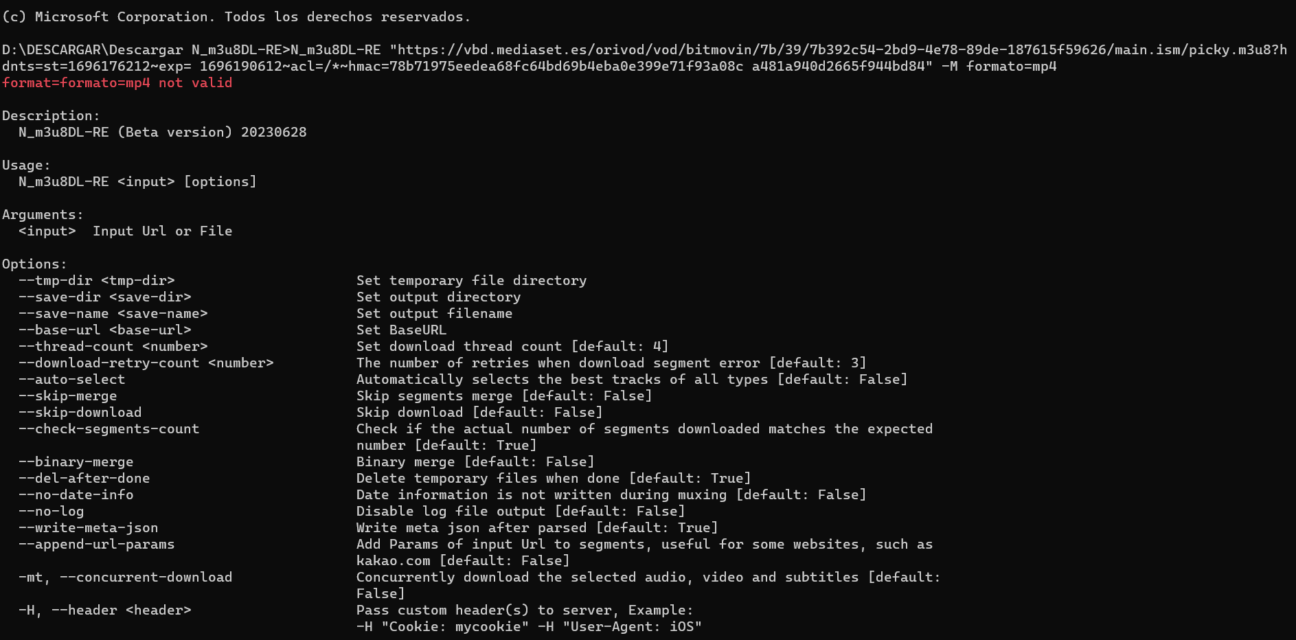

    Well no, he doesn't listen to me. When I enter that I get this error.
    What does the download link matter, if you already have the m3u8?
    What I want is to download it in m3u8 and when it's finished put all the .ts together in an mp4 file, but there is no way.
    [Attachment 74133 - Click to enlarge]
  9. -M format=mp4
    you use wrong syntax -M formato=mp4
    copy and paste into RE my code on post#8
    [Attachment 74134 - Click to enlarge]

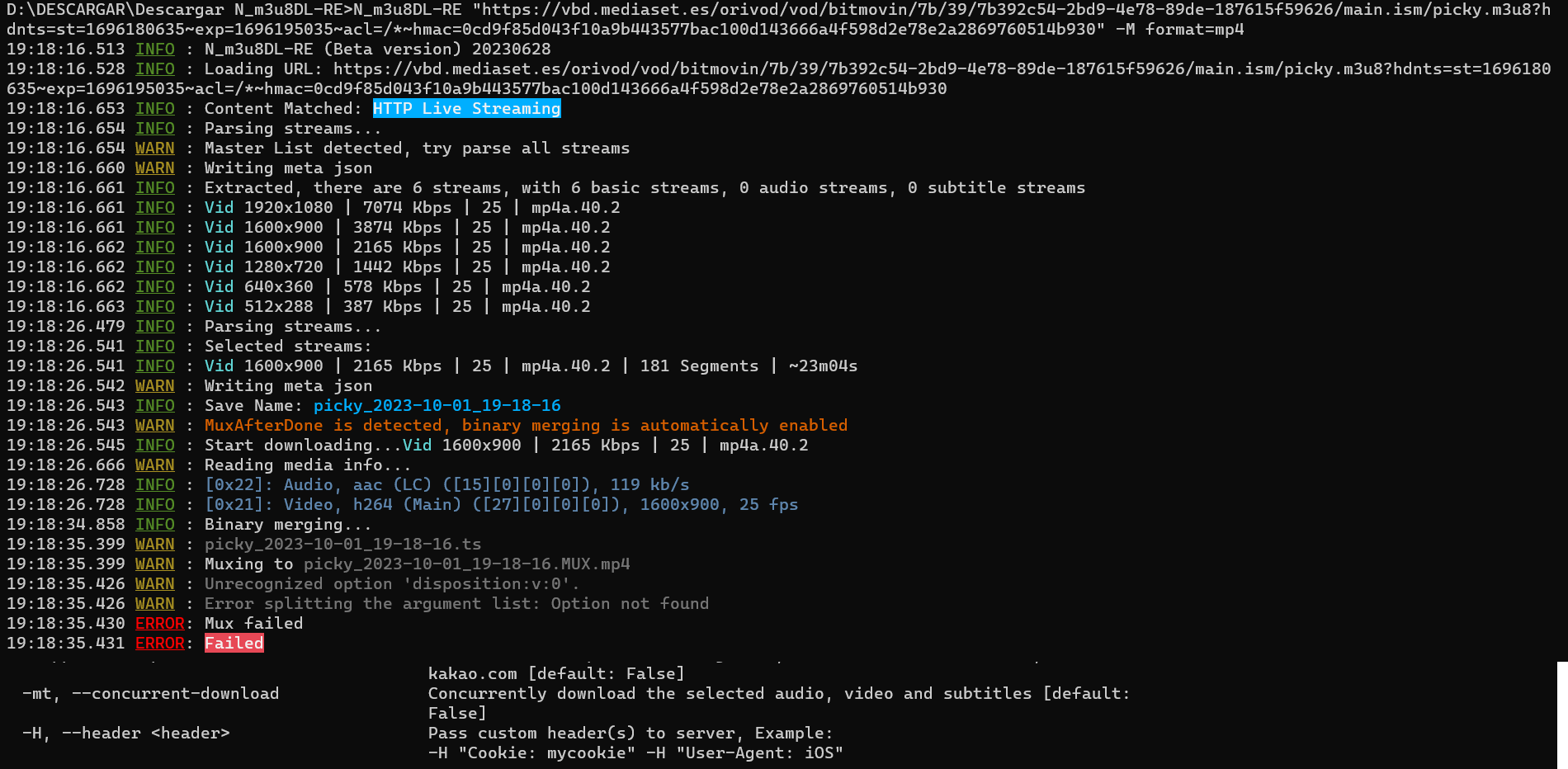

    Now I have achieved it, but it has not converted the file to mp4, it has left it in .ts format
    because? What's wrong now? Thank you
    [Attachment 74135 - Click to enlarge]

    i dont know what wrong? your N_m3u8DL-RE same version as mine, maybe your ffmpeg is old. new one is here- https://www.videohelp.com/software/ffmpeg
    if it still the same so i cant help you more
  13. Originally Posted by iamghost View Post
    Well, it doesn't look like it's FFMPEG.
    I don't know what it could be, but the thing is that it downloads the m3u8 fine, but when you convert it to mp4 it stays in a loop and gives the MUX error

  15. try with
    N_m3u8DL-RE "https://m3u8" --binary-merge
    with this command N_m3u8DL-RE use ffmpeg to join all segments in final .ts video without mp4 container
    if your trouble persist, is cause of ffmpeg
  16. Originally Posted by lomero View Post
    try with
    Indeed, with this command the download and union of the fragments is carried out, giving rise to a single .ts file
    Don't you convert it to mp4 somehow?
  17. no need. all player (like VLC, mpv, potplayer) play .ts file, no problem with this format
    also tv decoder play fine this extension.
    .ts is MPEG Transport Stream
    anyway if you want converter ts to mp4 use simply:
    ffmpeg -i video.ts -map 0 -c copy output.mp4
