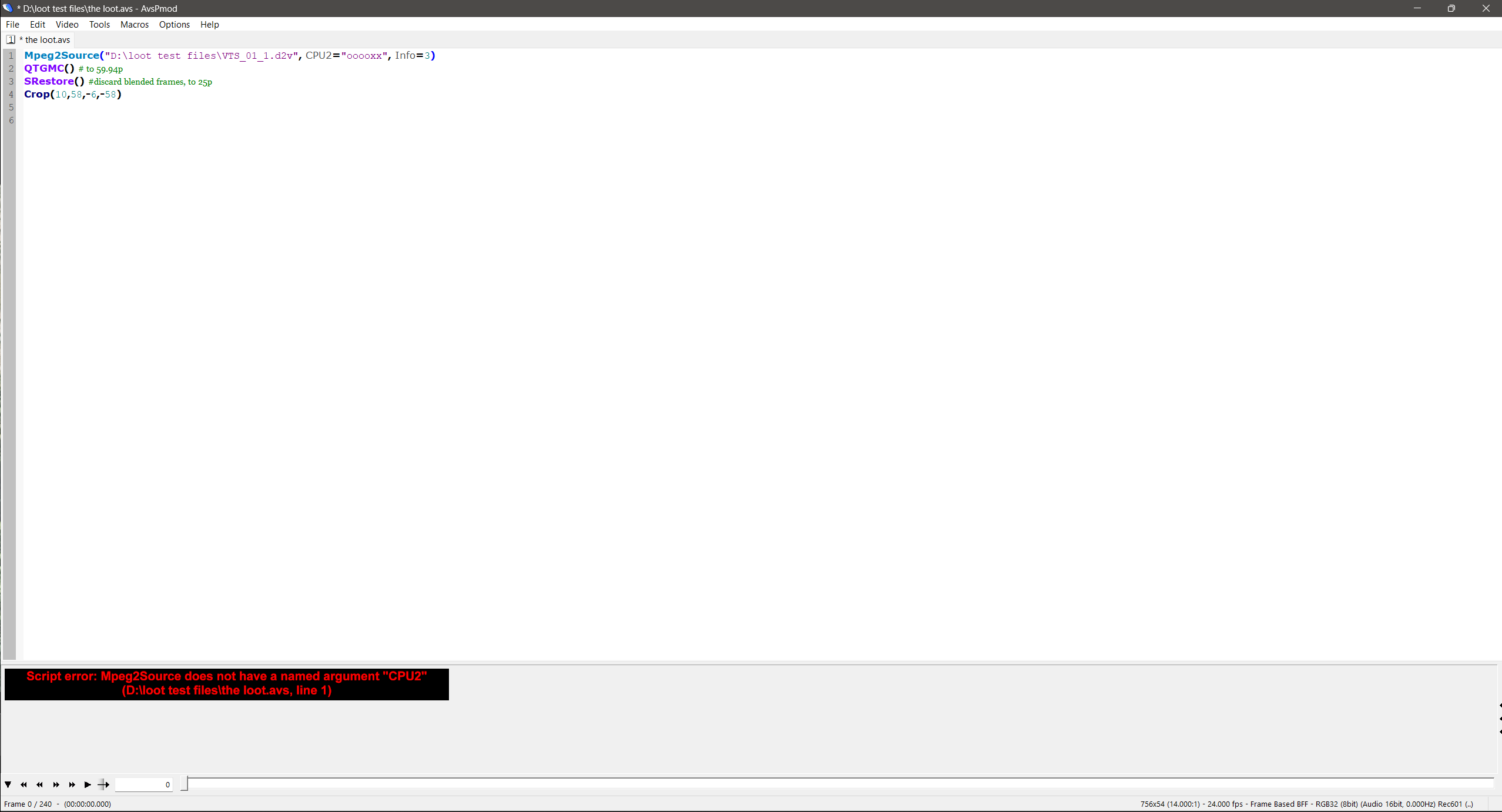

I'm trying to open the vob on avisynth for 1st time and i cant open it on avsPmod.
this is what i get:
[Attachment 74084 - Click to enlarge] -
You have to build the index file with DgIndex. You also need to have the MPEG2Source filter.

Newer builds of MPEG2Source don't include the CPU2 filters. Just delete that argument.
Code:Mpeg2Source("VTS_01_1.d2v", Info=3) -
Okay followed your step and it finally opens up now.Newer builds of MPEG2Source don't include the CPU2 filters. Just delete that argument.

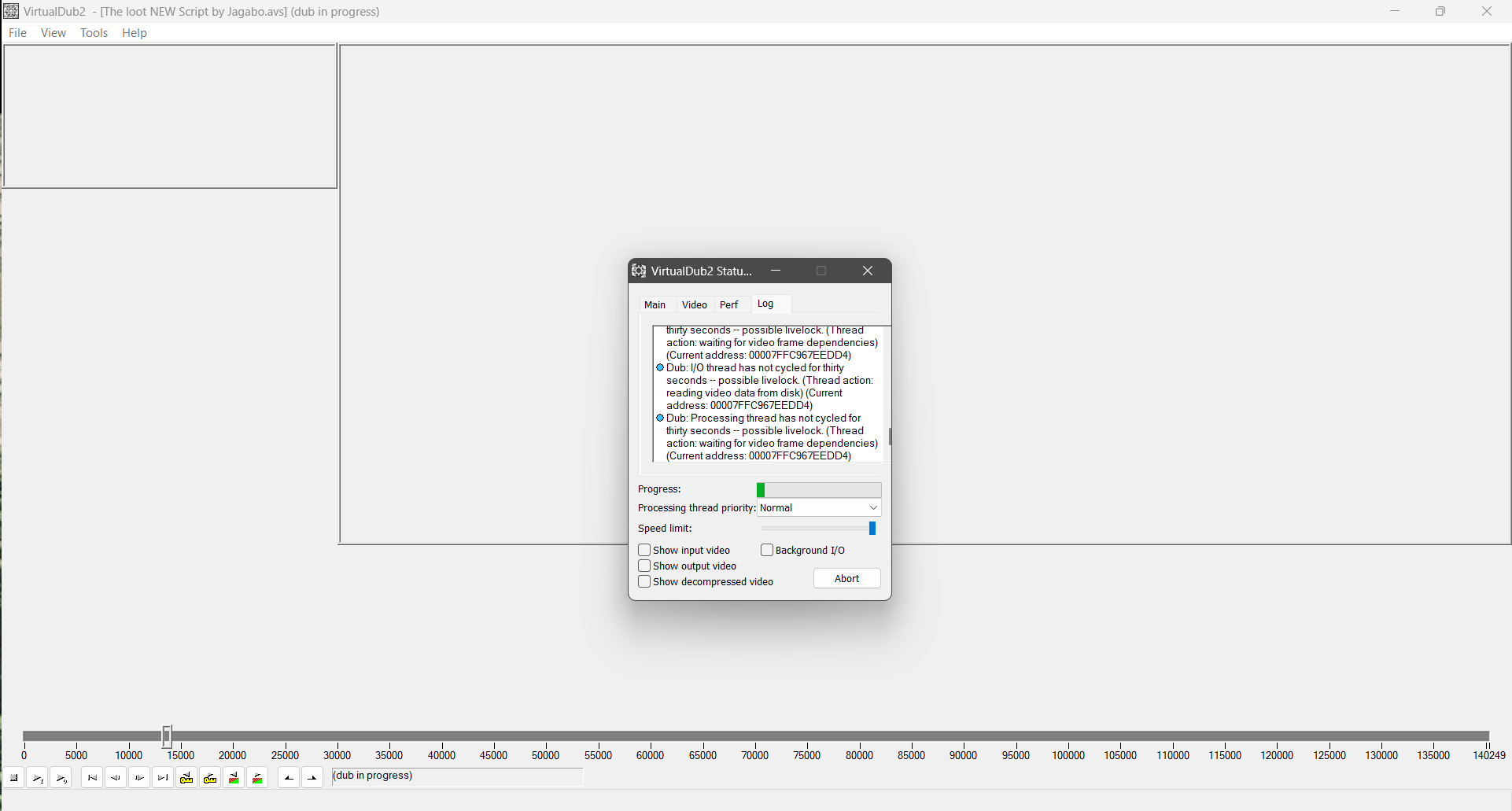

Virtualdub keeps crashing after few minutes into rendering. I cant seem to get this issue fixed. No matter what scripts I use it will crash at some point.
Its same thing Processing thread has not cycled for 30 seconds. Possible livelock.
[Attachment 74104 - Click to enlarge]
Also CPU usage is only 25% when running script on virtualdub 2.Last edited by Akuma786; 30th Sep 2023 at 05:45.

Does it always happen at the same point with a given script? That might indicate a problem with the source. If it happens a different times that might indicate an overheating problem.
By default AviSynth+ runs single threaded. To use more threads add Prefetch(N) to the end of your script. Where N is the number of threads to use. Try the number of cores your CPU has. -

Some other things you can try to diagnose the lockup:
Instead of encoding try File -> Run Video Analysis Pass. That will read through the entire script without encoding anything. If that locks up it indicates an AviSynth problem, not an encoding problem.
Try different audio and video codecs in VirtualDub. Or different encoding programs like the x264 CLI encoder or ffmpeg. See post #13 for an example using ffmpeg.
Monitor your CPU temperatures with Core Temp while encoding; to make sure your CPU isn't overheating.

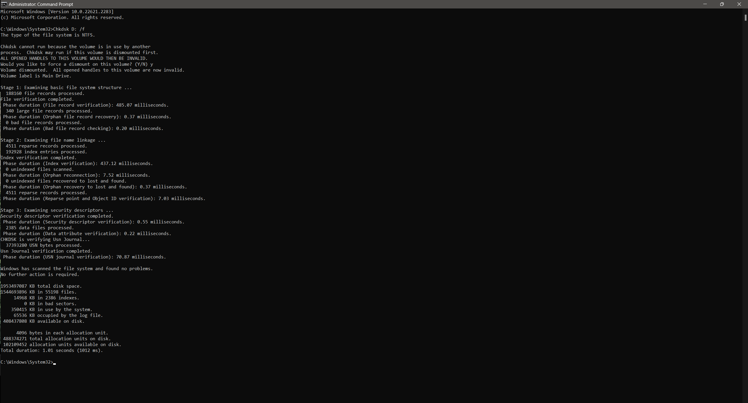

My knowledge of FFMPEG is also very weak. This is what i tried copying your code into command prompt:
[Attachment 74112 - Click to enlarge] -
Oops, get rid of the qsv options on the first line: "-init_hw_device qsv=hw -filter_hw_device hw". And maybe "-hwaccel dxva2" too.
Note that command line is supposed to go in a batch file. Then you drag/drop an AVS script onto the batch file to encode that script.
That means the problem in in AviSynth, not the encoding program. -
Your next step would be to try removing parts of the script until you find what's causing the lockup. The most likely culprits would probably be QTGMC and SRestore.
One culprit for hanging with QTGMC is an old avstp.dll version . If you don't have it in your plugins directory , that' s not the answer. If you do, replace with 1.0.4.1
https://github.com/pinterf/AVSTP/releases
Another culprit is old mvtools2 version. Update to newest one if you haven't already
https://github.com/pinterf/mvtools/releases -
This has fixed the issue I was having with Avisynth. I'm now able to export the script without any issues. Thank you so much guys for all your help.
