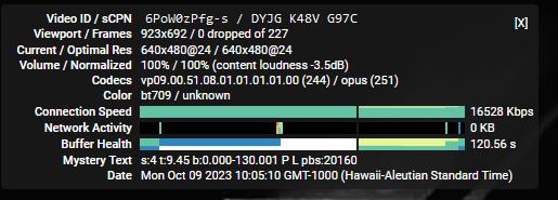

  10. Originally Posted by Alwyn View Post
    I often upload 1920x1440 4:3 at only 6000kbps so that I get VP9 encoding.
    I have VP9 video encoding at 640x480 standard def. Maybe everyone does, but I wouldn't know for sure:

  11. Maybe they encode to h.264 and vp9 if the clip exceeds a certain number of views during a certain period of time, and clips below that threshold don't get vp9 and higher bitrate and less artifacts. Or will get vp9, but not now, but much later. But to upscale SD to 1080p just to get vp9, is too much upscaling and it's not worth it. Upscaling should not be too much, it should be as less as possible.

    Just checked a few videos, some with lots, some with only 1000 or so views, and all of them play in VP9 at any resolution I chose, even at 144p. The only exceptions I could find are older videos (3 years old for example), they play in AVC for me.
    I made public a video just 5 hours ago. It has only 600 views and it's VP9 also.
    I checked my oldest from 9 years ago with 700,000 views and it's AVC.

    I uploaded a 1440x1080 video yesterday. YT encoded it as AVC. 24 hours later, it is still AVC (with no views). If I upload a 1920x1440 video, YT will immediately encode it in VP9.
    So it seems that if you are in the good books with YT (popular channel, Manono 600 hits in 5 hours! Impressive ), you'll get VP9 at lower resolutions than 1440. If you're an unpopular also-ran like me, you need to upload 1440 or greater to get it.

    If your video meets the VP9 criteria, all the variants of that video will be be in VP9, regardless of their size.
