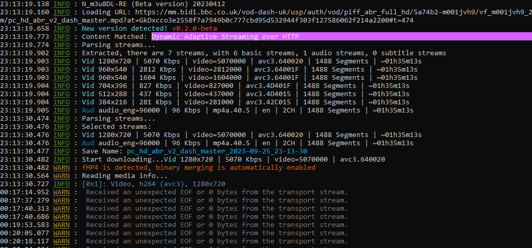

    I tried to download this video (login required to view, I'm willing to give the login details if anyone wants to do it) but I did not succeed.
    I don't live in the UK. I found this .mpd with free browser VPN:
    master.mpd
    https://vod-dash-uk-live.akamaized.net/usp/auth/vod/piff_abr_full_hd/5a74b2-m001jvh9/vf_m001jvh9_2891c145-b7eb-4e9f-a9c2-80c9665ca402.ism/pc_hd_abr_v2_dash_master.mpd?__gda__=1695758081_6a8c9dd2f2b0ad8ef64a08a038e48f55#t=333.7702729021039
    master.m3u8
    https://mm.bidi.bbc.co.uk/vod-hls-uk/usp/auth/vod/piff_abr_full_hd/5a74b2-m001jvh9/vf_m001jvh9_2891c145-b7eb-4e9f-a9c2-80c9665ca402.ism/pc_hd_abr_v2_hls_master.m3u8?at=jPQuMXMNcd997587a634a1ffc3d603d9dfe89ef75ced47c2606436a952a40
    Thanks to the advice of user lomero I downloaded Psiphon.
    I used N_m3u8DL-RE to download the video with Psiphon activated.

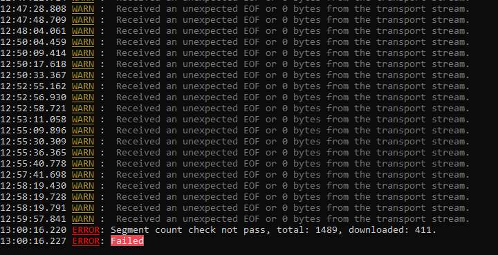

    I was hoping to make it and I tried to download it at 128 kbs speed (UK server Psiphon) but after 13 hours of downloading I received the error shown in the screenshots.
    [Attachment 74044 - Click to enlarge]
    [Attachment 74045 - Click to enlarge]
