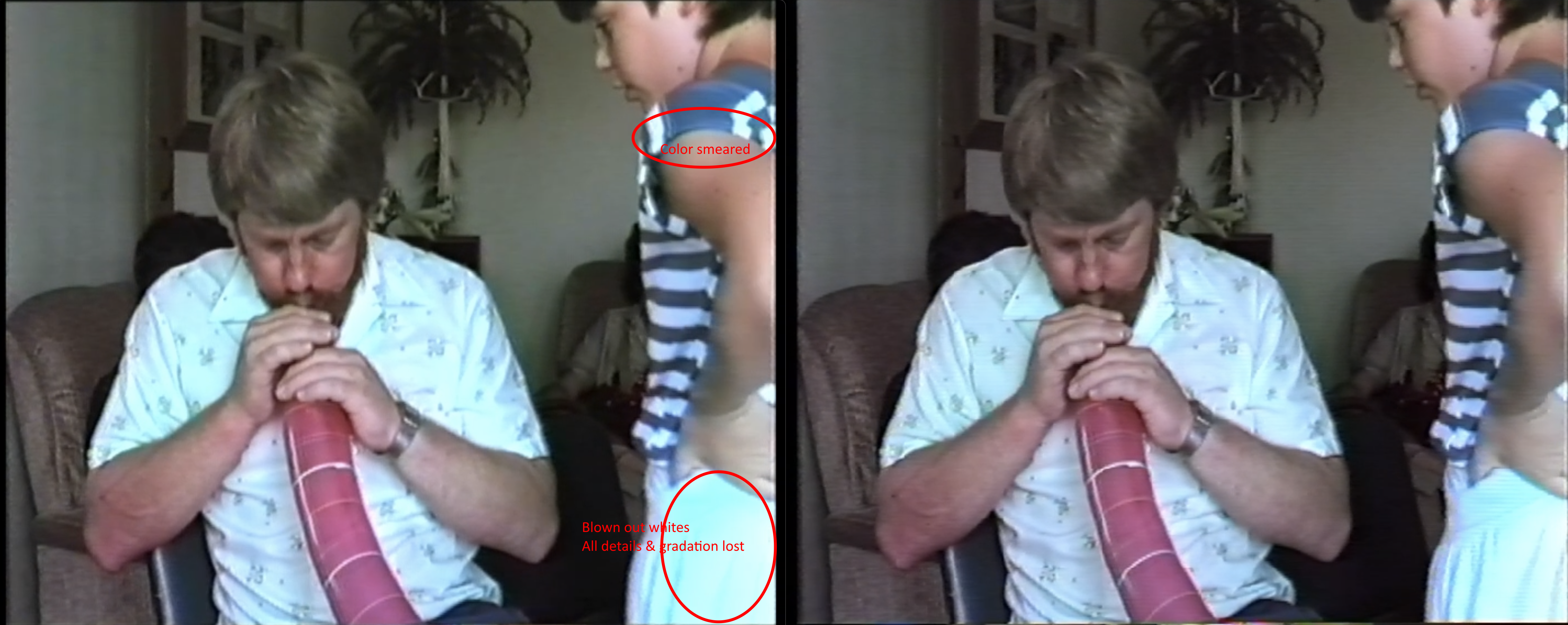

  1. Neither is exciting, left is worse. Do we compare apples with apples at all? Deinterlaced vs interlaced (?). Which deinterlacer .....
    As has been said lossless interlaced captures would be more conclusive.
    Edit:
    And if - as you wrote - the color does not move in line (synchronously) with the luma in motion scenes, there is a good chance that at some step along the processing chain interlaced footage is not processed correctly.

  2. What, you're not excited by balloons? Where's your lust for life?!
    I'm actually grateful you pointed out the colour and the highlights, because I was too busy with all the jagged edges on the right - which to me are far worse than the colour issues - and that's saying something cause I hate colour issues and your colour smearing example is the kind of difference I was expecting going from 4:2:0 to 4:2:2 due to low resolution of VHS and well the rest you already know I guess.
    But if someone put a video on for me, I'd rather watch the left one.
    I will provide some better captures when I get to spend some time on it. Nevertheless the captures I've provided do show the issue quite fine. It's exactly as shown.

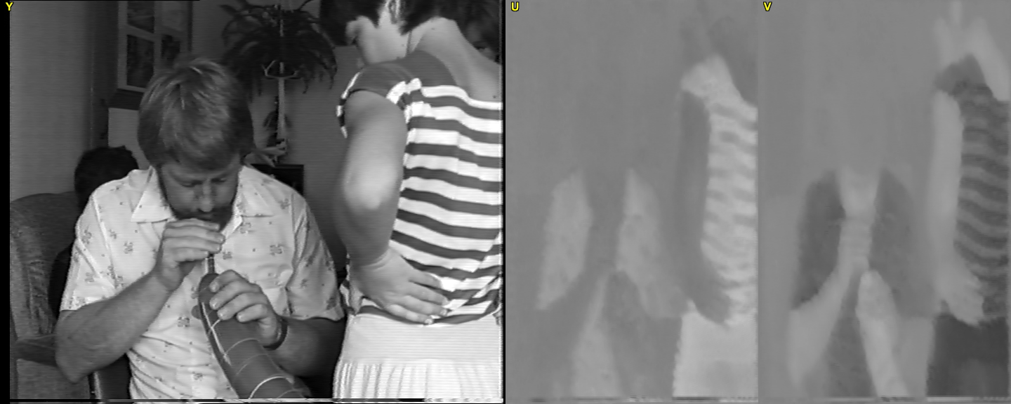

    The horizontal bars in the cyan skirt (and other parts of the frame) are in the luma channel, not the chroma.
    Y, U and V:
    [Attachment 74437 - Click to enlarge]

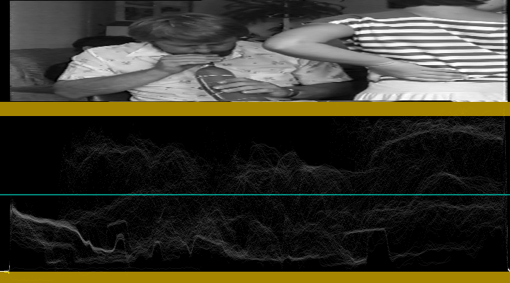

    Those appear to be diagonal hum bars that repeat every 4 scan lines.
    [Attachment 74438 - Click to enlarge]
    GreyScale()
    SeparateRows(4)
    HistogramOnBottom()
    AssumeFPS(10)
    Trim(400, 403)
    This is why one should post video samples, not highly processed screen caps.

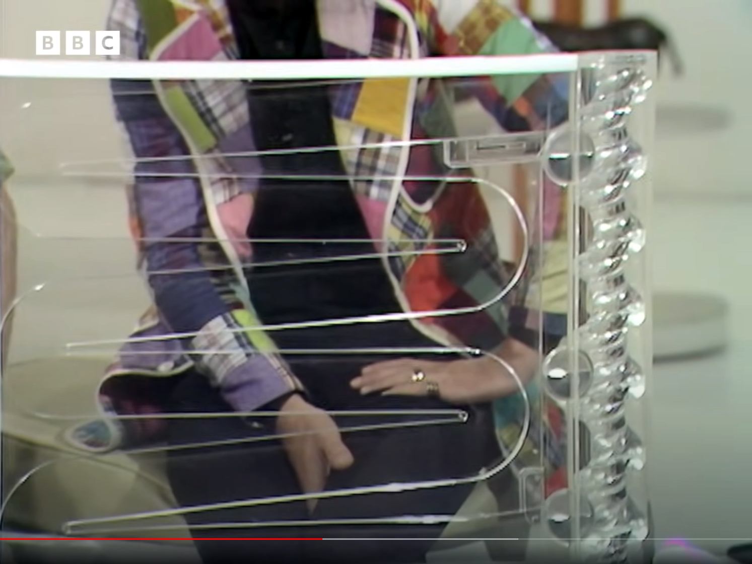

    Here is an old analogue from 1971. Granted, this is likely a 2-inch tape, definitely not VHS. Deinterlacing is not perfect, though.
    Wow, it's pretty impressive though isn't it!
