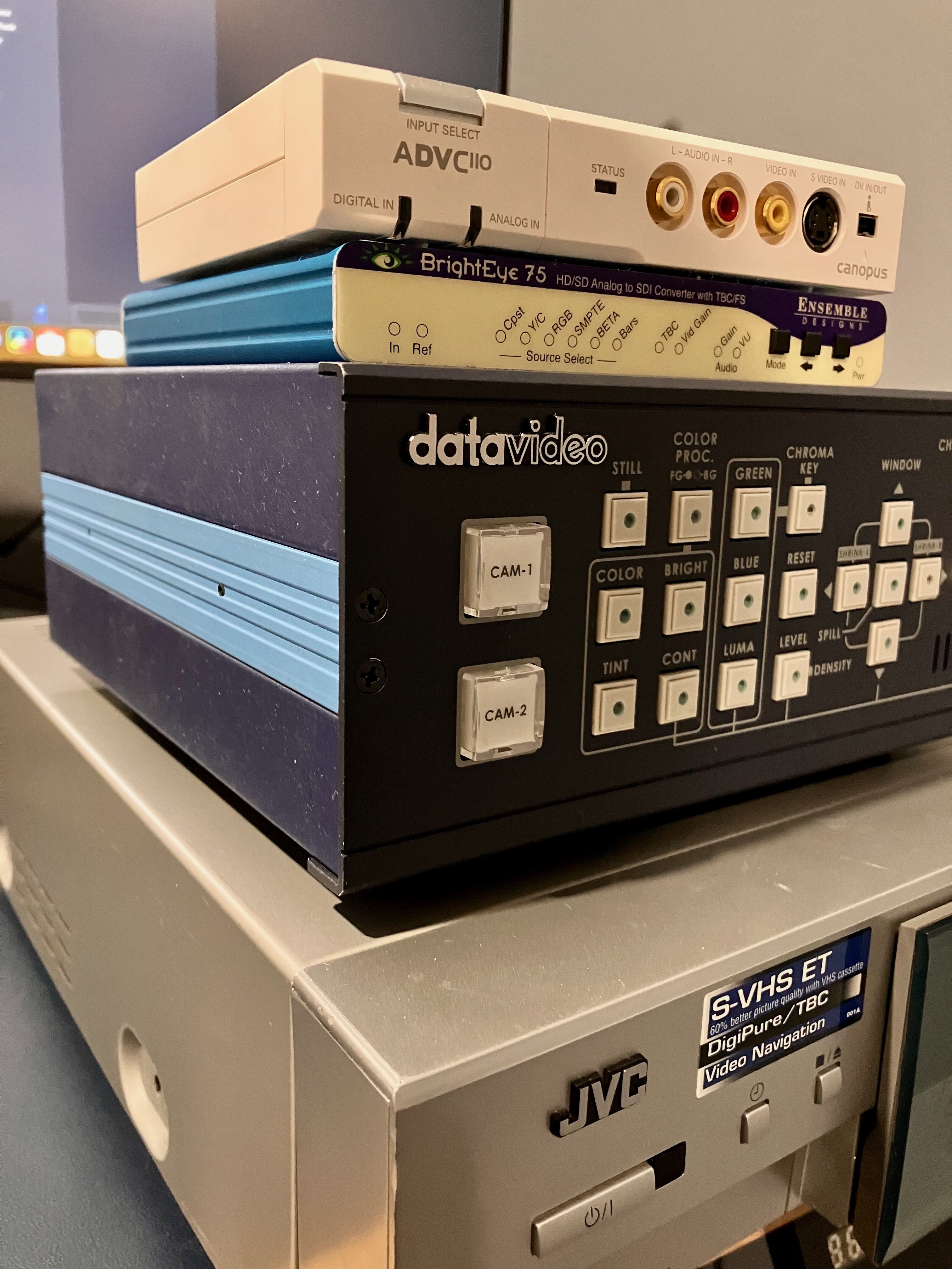

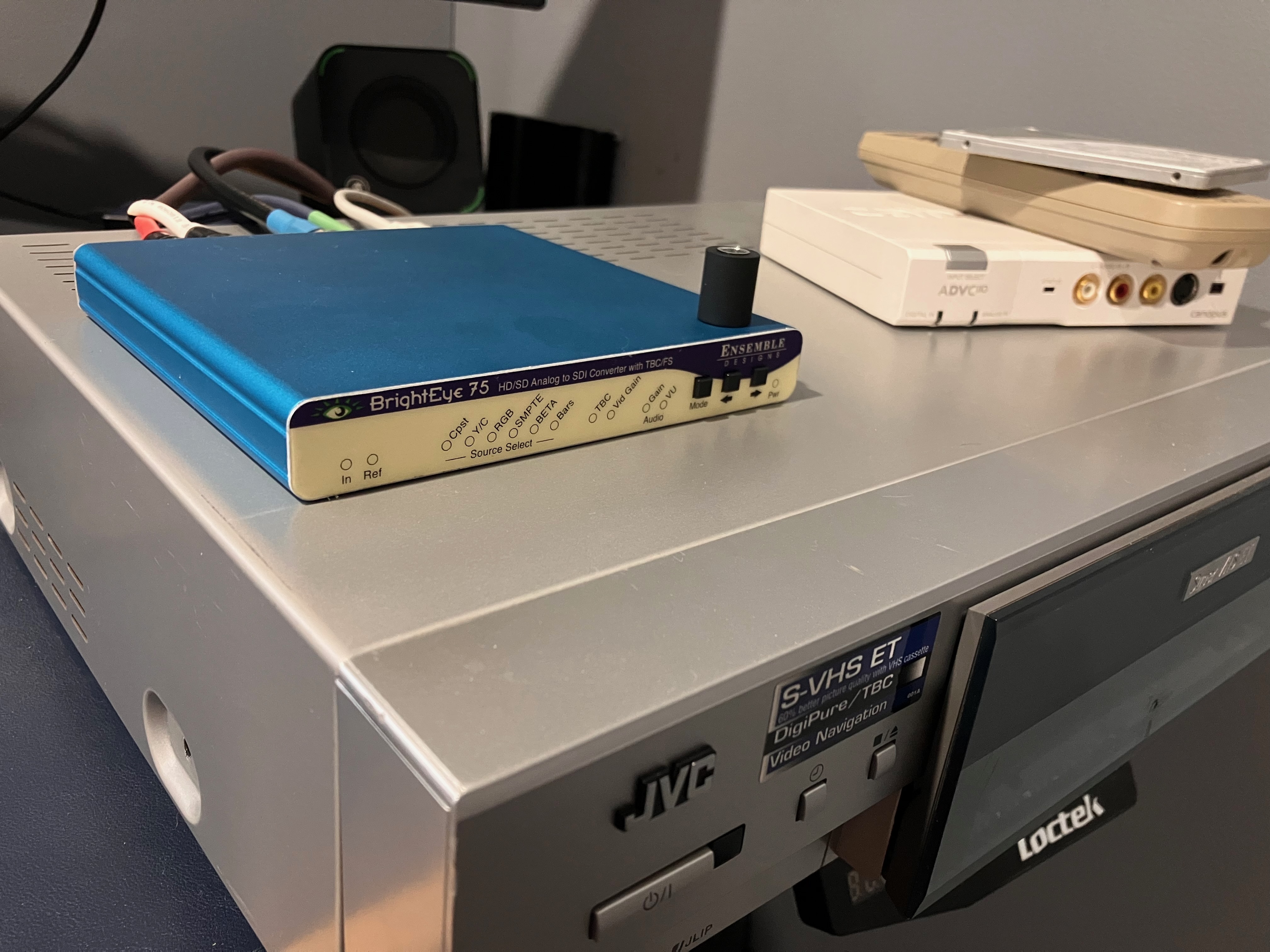

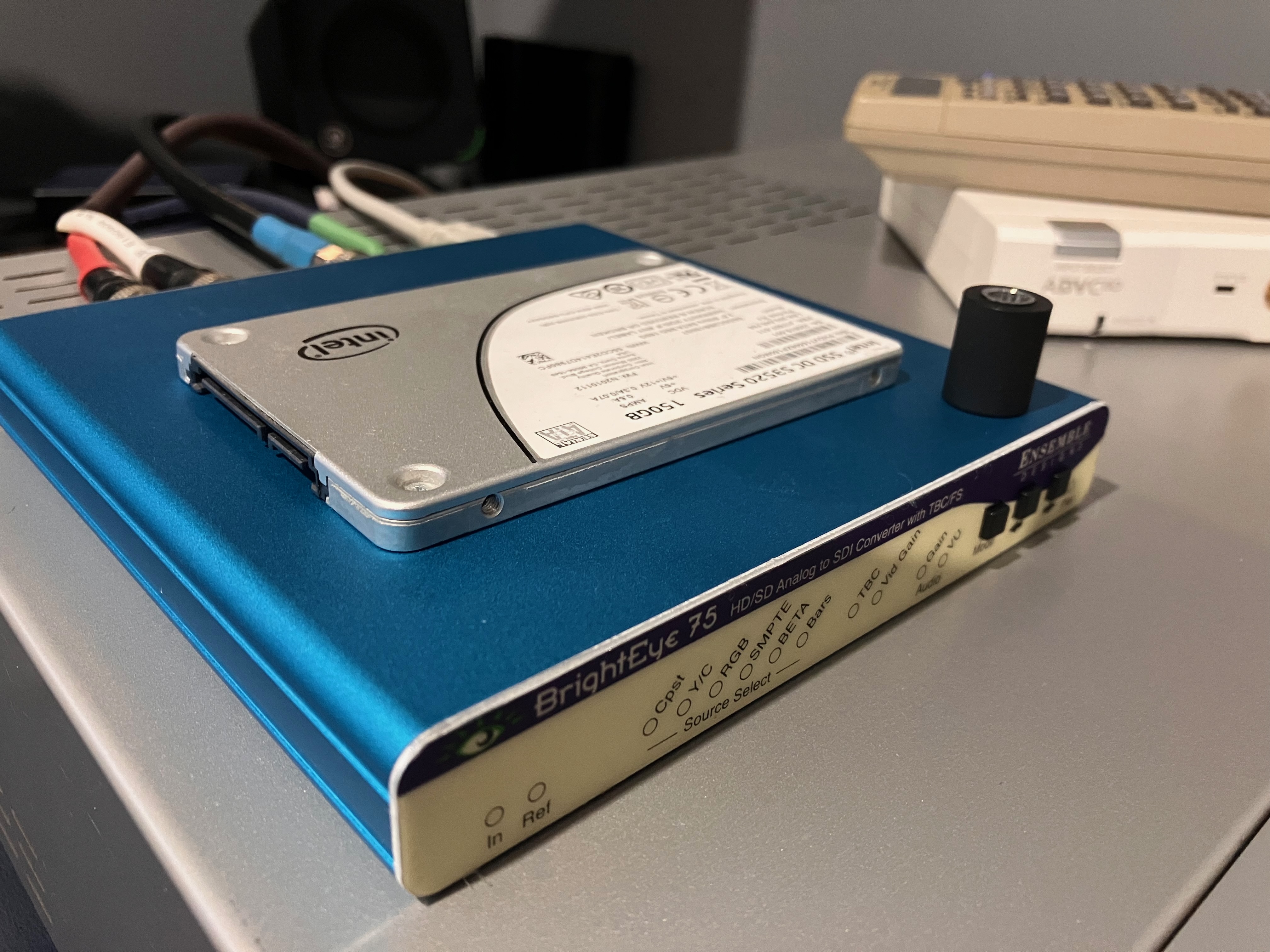

  8. Well, my Brighteye 75 turned up today - actually 3 days ago, but I didn't make it in time to collect. Apparently the shipping was actually more expensive than quoted - though they waived it and I got the money for the extra PSU back as it's now included. Unfortunately I'm still awaiting the courier for the SDI converter, which seemingly due to a paging glitch at the door, failed to deliver this morning. On the weekend I wired up a short S-Video to Y / C cable and an SDI cable and this afternoon a stereo RCA to phoenix connector for the back. I was surprised at just how small it is actually. I mean I've seen the pictures multiple times, but it really is much smaller and thinner than I had realised. It will sit nicely with the other gear I've got. I'm nearly there!
    [Attachment 74363 - Click to enlarge]
    [Attachment 74364 - Click to enlarge]
    May 2005
    Australia-PAL Land
    You're taking a bit of a risk showing that white thing in the background!

    Keep in mind the BE75 gets a little bit warm, so keep some space around its aluminum body, and don't put the SDI interface on top of it as it too gets warm.
    Could you share the Phoenix to RCA mod, I've looked for a pre-made cable but seems like does not exist. I made my own too but I would like to have a factory solution, unfortunately I'm unable to find such cable.
  13. Originally Posted by Alwyn View Post
    Ha, I thought it would get a comment - and I have two of these - the older / earlier one I am yet to try it's 7 pin din connector to find out what it is to solve a discussion I started a while back.

  16. Originally Posted by dellsam34 View Post
    I plugged it in the other day without even running anything through it and yes, it does get warm! I would have thought it would need to at least be processing something!
    Good to know about the SDI unit also - I made short cables on purpose but the absolutely beautiful thing about SDI is you've got essentially unlimited length for our purposes, and cheap without quality loss - I really wish we would just have this in all our consumer gear.
    I was a little disappointed about the phoenix connector, so as an interim all I've done is snip an old RCA cable in half and wire up the back of it via the manual. I can see in the VU meters in the web client that I'm receiving clipping so I know that it's working, but won't really be able to test it until the SDI converter comes along.
    I have phoenix connectors in a bunch of audio gear that's part of some architecture I'm responsible for at work - they're a Bosch branded safety rated system - but it's always wired up by an on site electrician. So while I'm familiar with it, I've never done it. I'm hoping I can replace the back part of it so that it's not a press and release system, but rather a screw down system. Then the cable will be able to mount more securely. Presently it bends at the connection point because I'm not willing to do what I should do until I know I can buy additional plugs for it. When I do, I think I will either heat shrink it right around the plug somehow, perhaps with some internal bracing because it's just not very robust. I think I will also ask one of the electrical guys at work how they do it. Some seem to be cabled straight in and tied to the back, others seem to have a crimping mechanism placed onto the wire first - that's probably what I'll aim for.

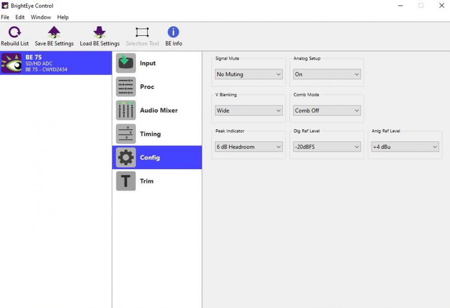

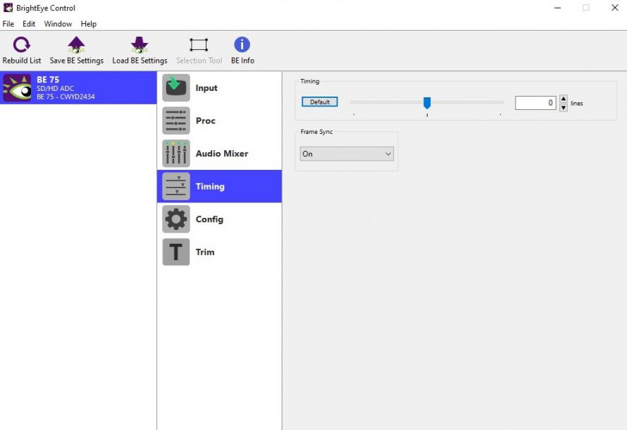

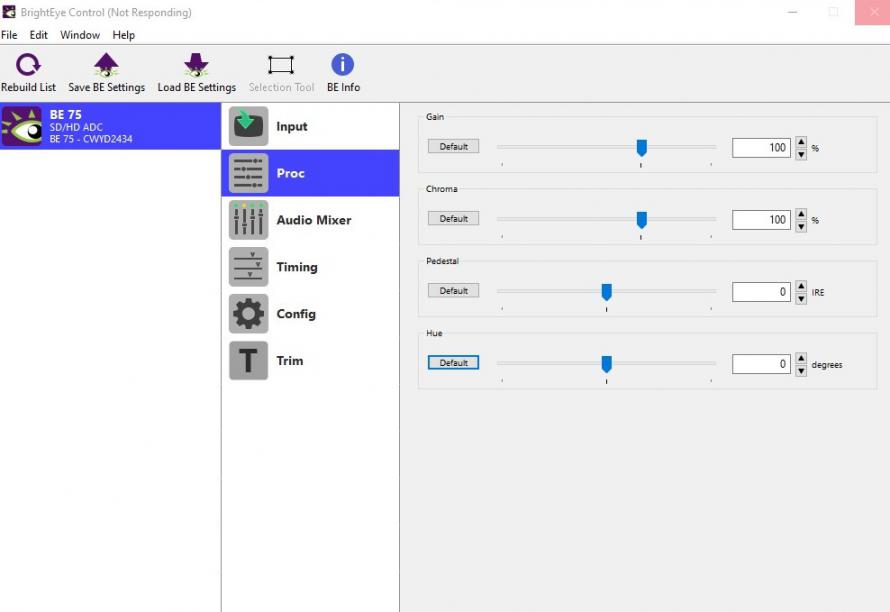

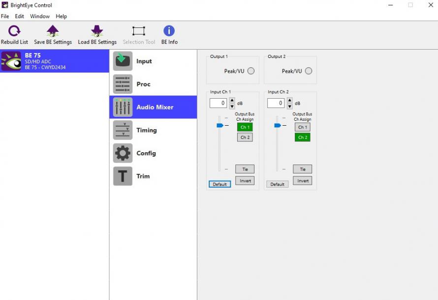

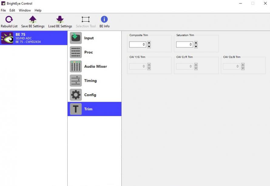

    First make sure the BNC to S-Video is of a high quality, shielded and coaxial, preferably less than 3ft. If you are using SCART chances are it's falling back to composite.
    Setting wise, here are mine, You may need to raise the audio level since its a balanced device by observing MediaExpress gain meters, make sure it's above -20dB, preferably around -5dB if you can:
