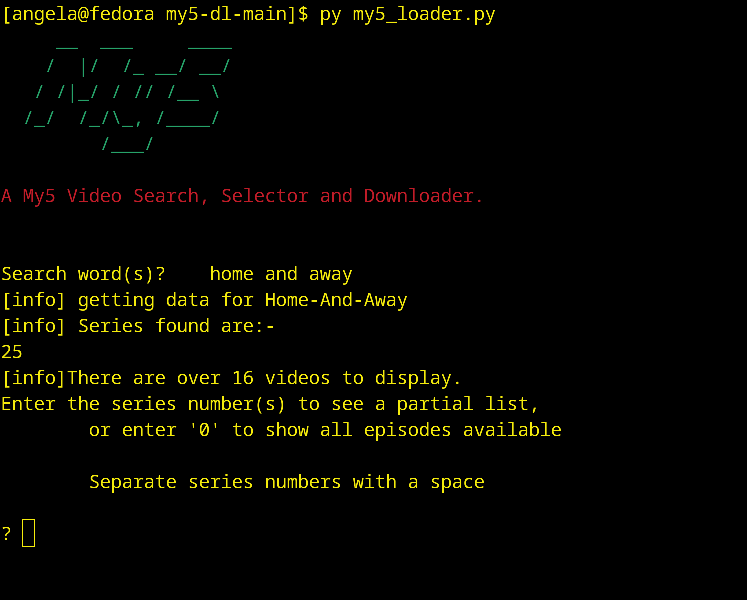

    Here is a my5 loader allowing search and select for single episodes series or multiple series.
    Updated 26/09/2023 https://files.videohelp.com/u/301890/my5_update.zip
    Install Diazole's my5-dl package from https://github.com/Diazole/my5-dl
    Follow instruction on github and make sure you have all Diazole's software running properly.
    Then extract the zip, linked above, INTO the same folder as Diazole's my5-dl.py.
    run pip install -r requirements.txt and then you should be set.

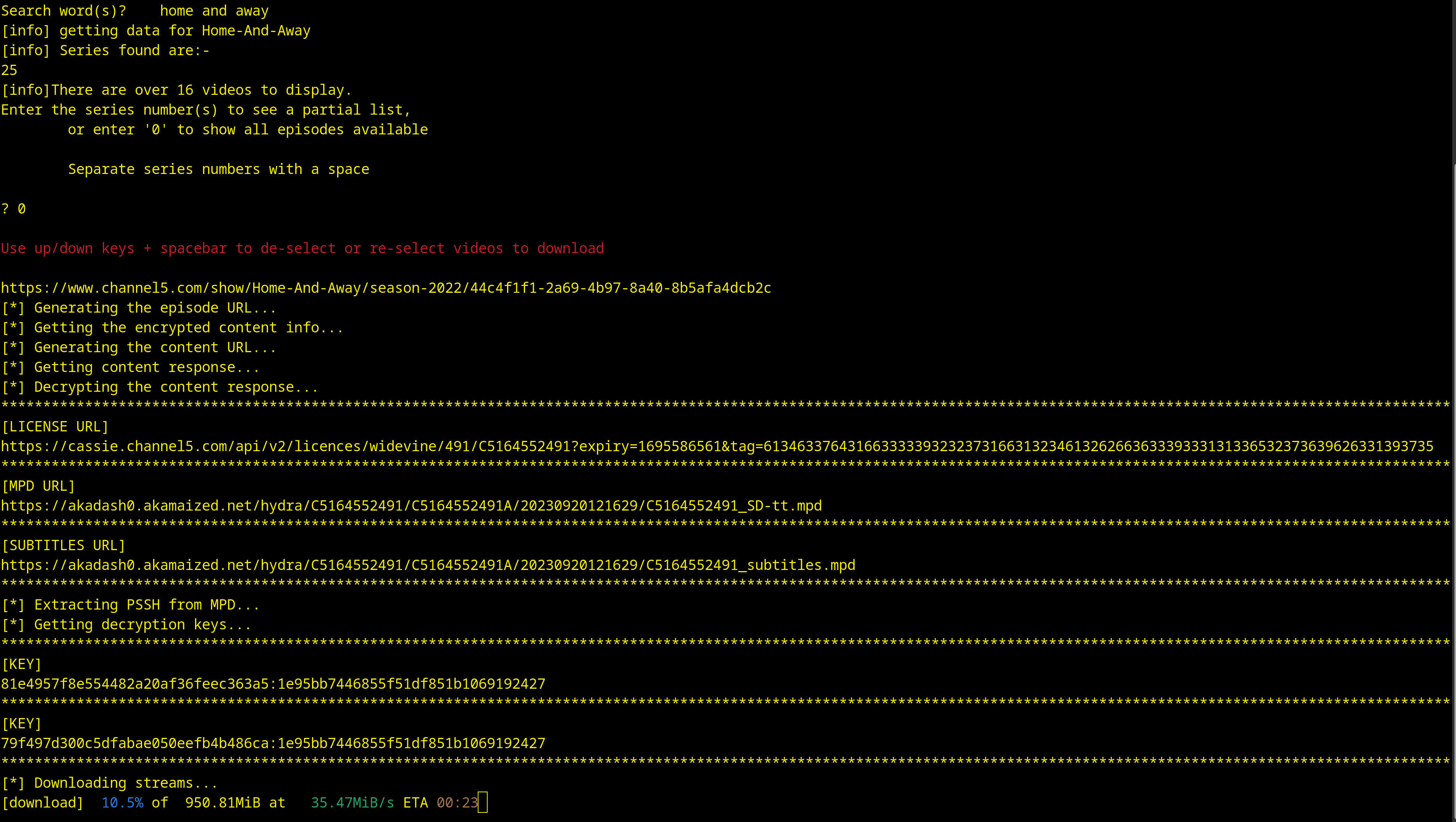

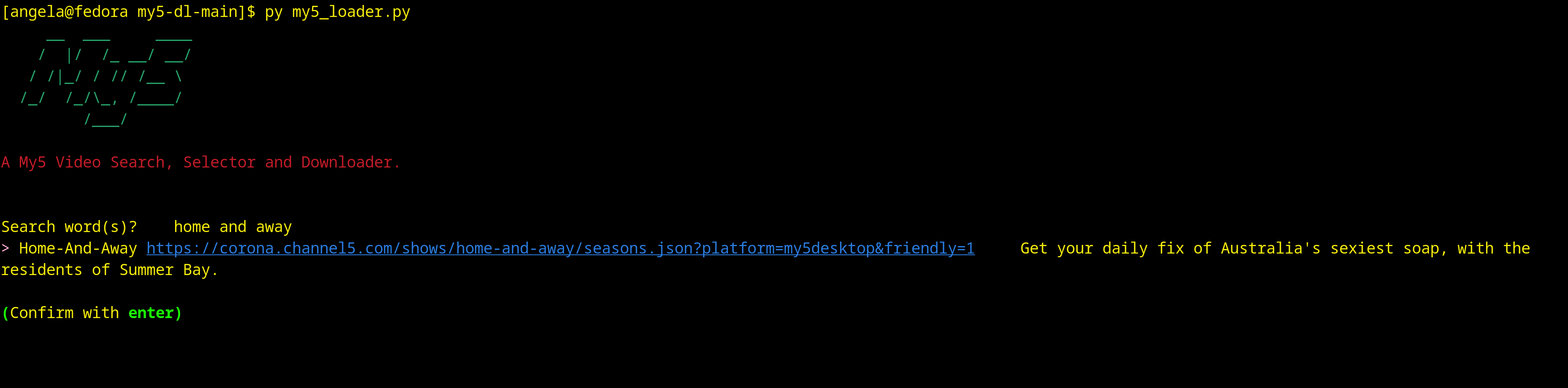

    py my5_loader.py runs the script.
    [Attachment 74015 - Click to enlarge]
    search

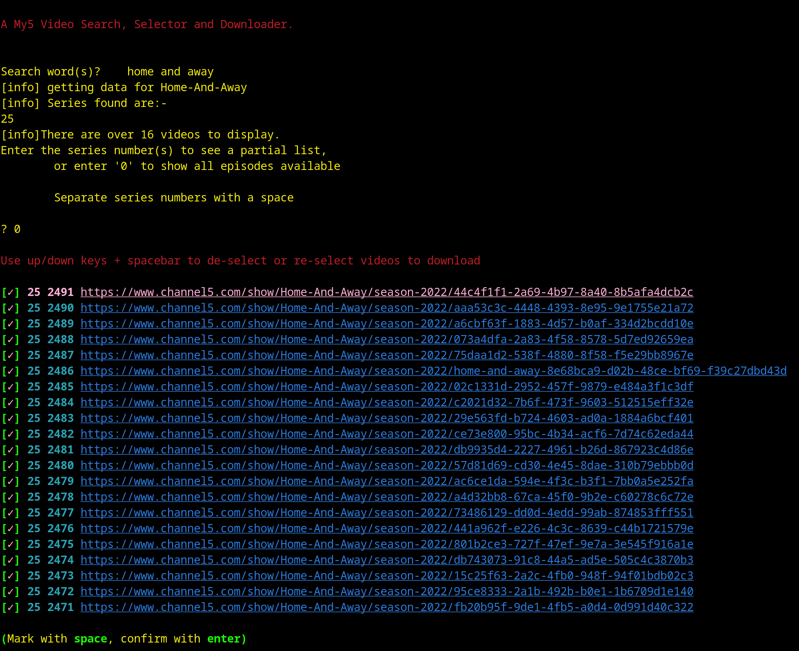

    [Attachment 74016 - Click to enlarge]
    [Attachment 74017 - Click to enlarge]
    select and download ( yes that's series 25 and episode numbers!)
    [Attachment 74018 - Click to enlarge]
    downloading with modified version for Diazole's my5-dl

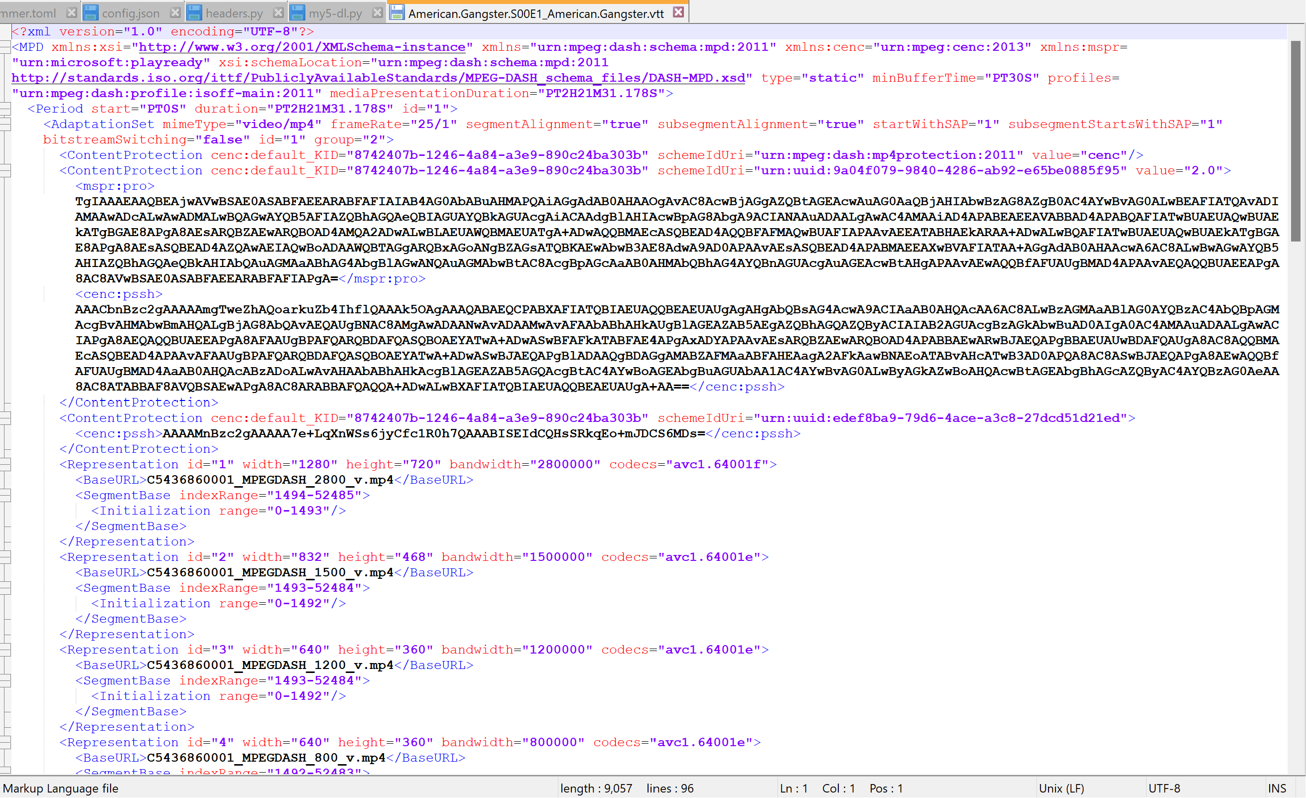

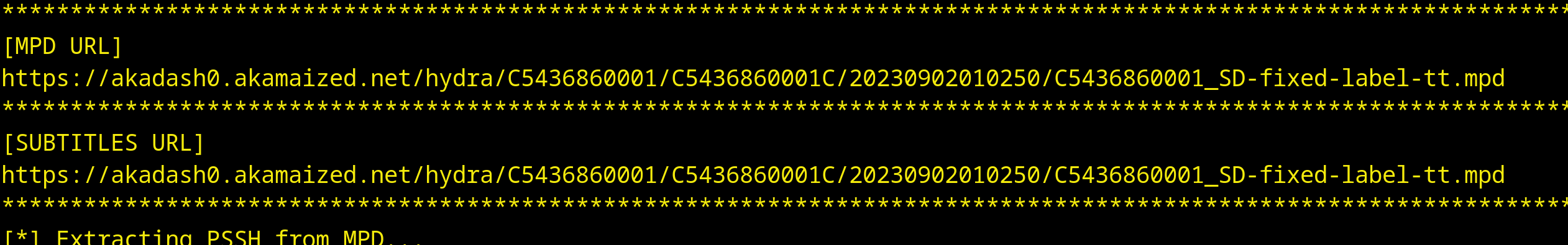

    Found the work around!!
    Diazole's code is picking up the wrong subtitles file - an mpd -
    [Attachment 74035 - Click to enlarge]
    so when that gets muxed in it ruins the download which was all fine up 'til then.

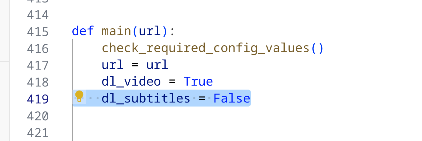

    The work around is to switch off subtitles at the top of the main(url) function.
    [Attachment 74037 - Click to enlarge]
