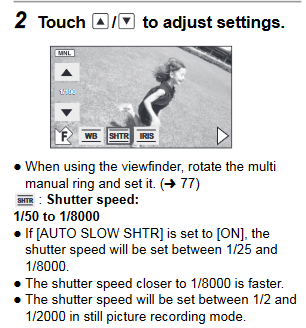

    Added: from the manual:
    Image Attached Images

    There is a comment on page 81 about changing the shutter speed if you're in a 60hz area in bright lights, but that's not frame rate.

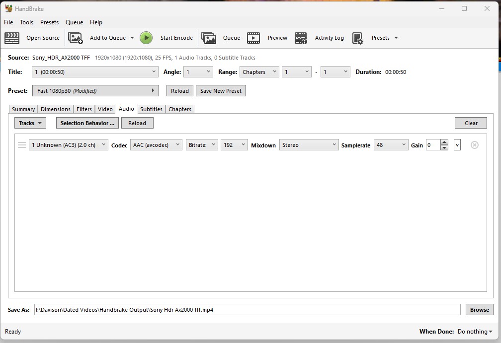

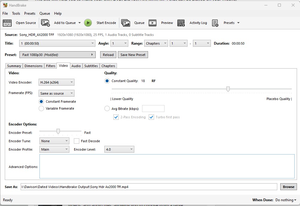

    Handbrake! I'm not an expert at it but this will get you going. HB has it's foibles.
    Before you start: Tools>Preferences>Output Files: choose MP4 as the extension.
    Tabs:
    Filters: nothing to change here. Note the Deinterlacing options, which can be changed if necessary.
    Video Tab:
    [Attachment 73995 - Click to enlarge]
    Video Encoder: up to you. Normally, H264, although H265, a much newer codec, is becoming main-stream. The dropdown has choices depending on your computer. For example, if you have a NVidia graphics card, you can choose H264(NVEnc) for much faster encoding/rendering. I think QSV is for Intel iGPUs (integrated motherboard GPUs such as the UHD 770) but don't quote me.
    Frame Rate: Same as source and set as Constant.
    Quality: A CRF of 18 is a good all-round number. The lower the number, the higher the quality (yes, that makes sense, doesn't it). Alternatively, you can use Average bitrate to finetune the size of your files depending on how they come out quality-wise.
    Audio Tab:
    [Attachment 73997 - Click to enlarge]
    Codec: AAC, Bitrate 192 is a good all-round value for AAC, Samplerate: video is traditionally 48kHz.
    That's it, set the file destination at the bottom and hit Start Encode.
