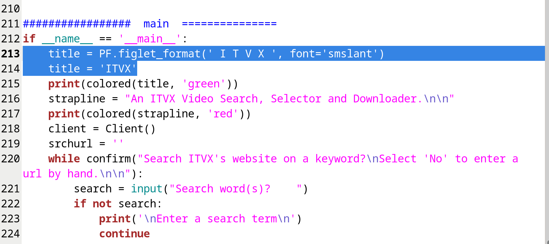

    if you think character encoding is the the issue look through the code and remove the stuff that prints ITVX banner at the start of the program. You say very little of the 'Windows machines' so only very little can be said to help you.
    Try using a windows app called 'Terminal' to run the code.
    edit your code
    [Attachment 75230 - Click to enlarge]
    remove
    title = PF.figlet_format(' I T V X ', font='smslant'
    add
    title = 'ITVX'
    I have tested the code; it runs on windows 10 and 11.

  7. Originally Posted by A_n_g_e_l_a View Post
    edit your code
    remove
    add
    title = 'ITVX'

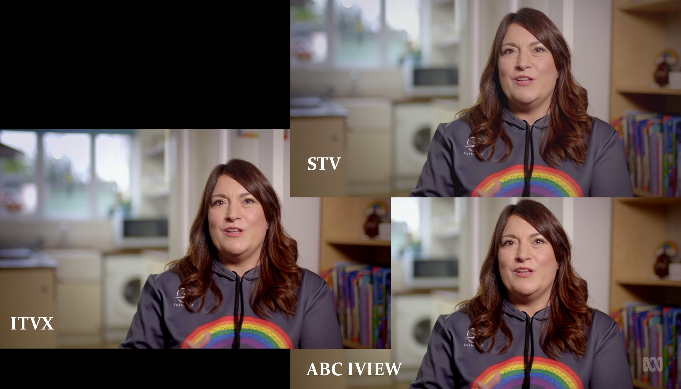

    Indeed. I use yt-dlp to get stuff from STV, but for some reason their videos are "pale" with less vivid colors compared to other platforms. My best guess is lower bitrate for reduced bandwidth usage.
    Check this composite image for comparison. Exact same frame from ITVx video, STV one, and ABC IView. The color is off on the STV one
    [Attachment 76164 - Click to enlarge]
    For series 13 episode 1 of Vera.
    ITV 720p 1931 kbps
    STV 1080p 3713kbps which is close to double the ITV bit-rate.
    Could it be the up-scaling software on your TV/monitor or whatever doing an interpolation that adds to the picture in a manner you like?
    I think STV give me a better picture but it's only a matter of taste. You have the tools to choose whatever suits you best. Happy days!

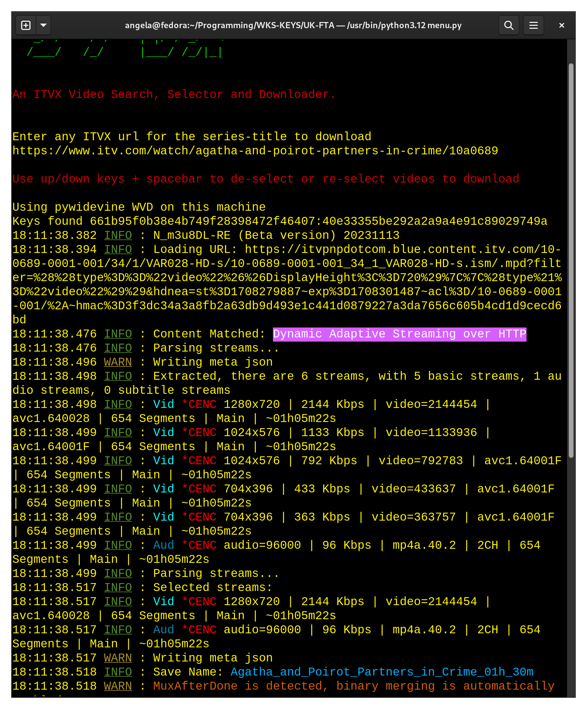

    [Attachment 77114 - Click to enlarge]
    No. It's operator error.

    For some reason for thuis url (https://www.itv.com/watch/agatha-and-poirot-partners-in-crime/10a0689) it is important to run ITVX.py as a surrogate. So be sure to call itv_loader.py and feed that with your itv link url.
