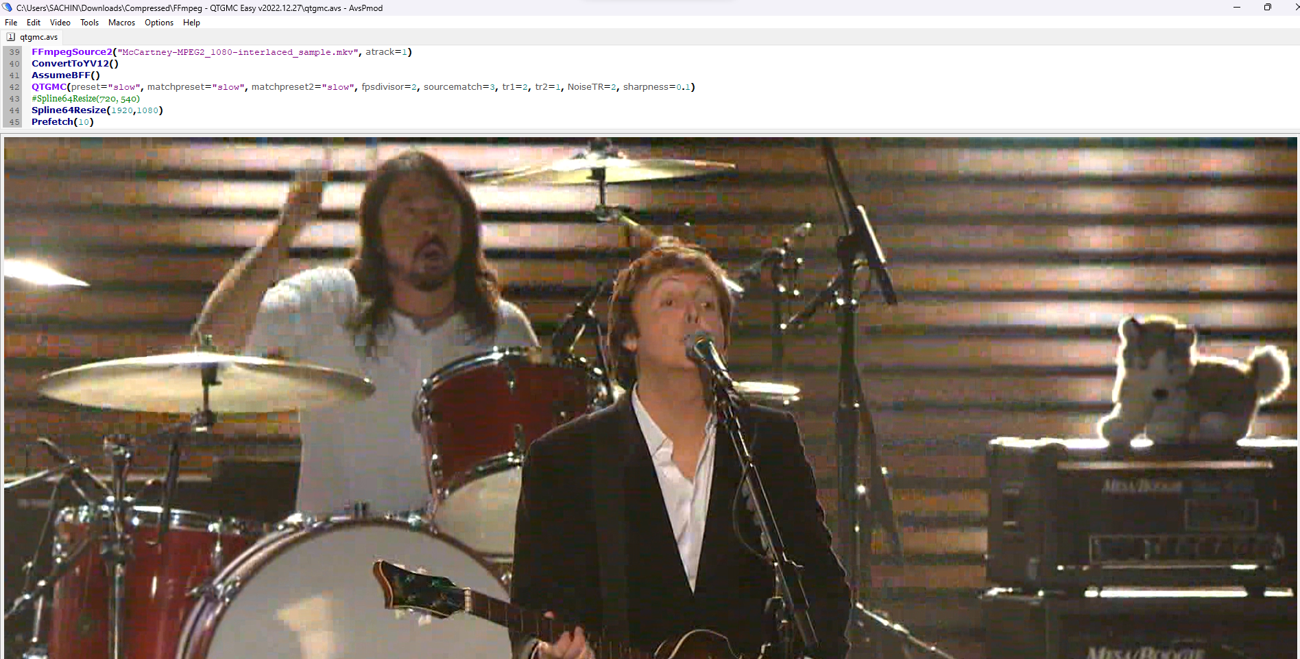

  2. What does your script look like?
  3. SetFilterMTMode("QTGMC", 2)
    FFVideoSource("McCartney-MPEG2_1080-interlaced_sample.mkv")
    ConvertToYV12(interlaced = true)
    AssumeTFF()
    QTGMC(preset="slow", EdiThreads=3, matchpreset="slow", matchpreset2="slow", fpsdivisor=2, sourcematch=3, tr1=2, tr2=1, NoiseTR=2, sharpness=1.2)
    Spline64Resize(1920,1080)
    Prefetch(10)

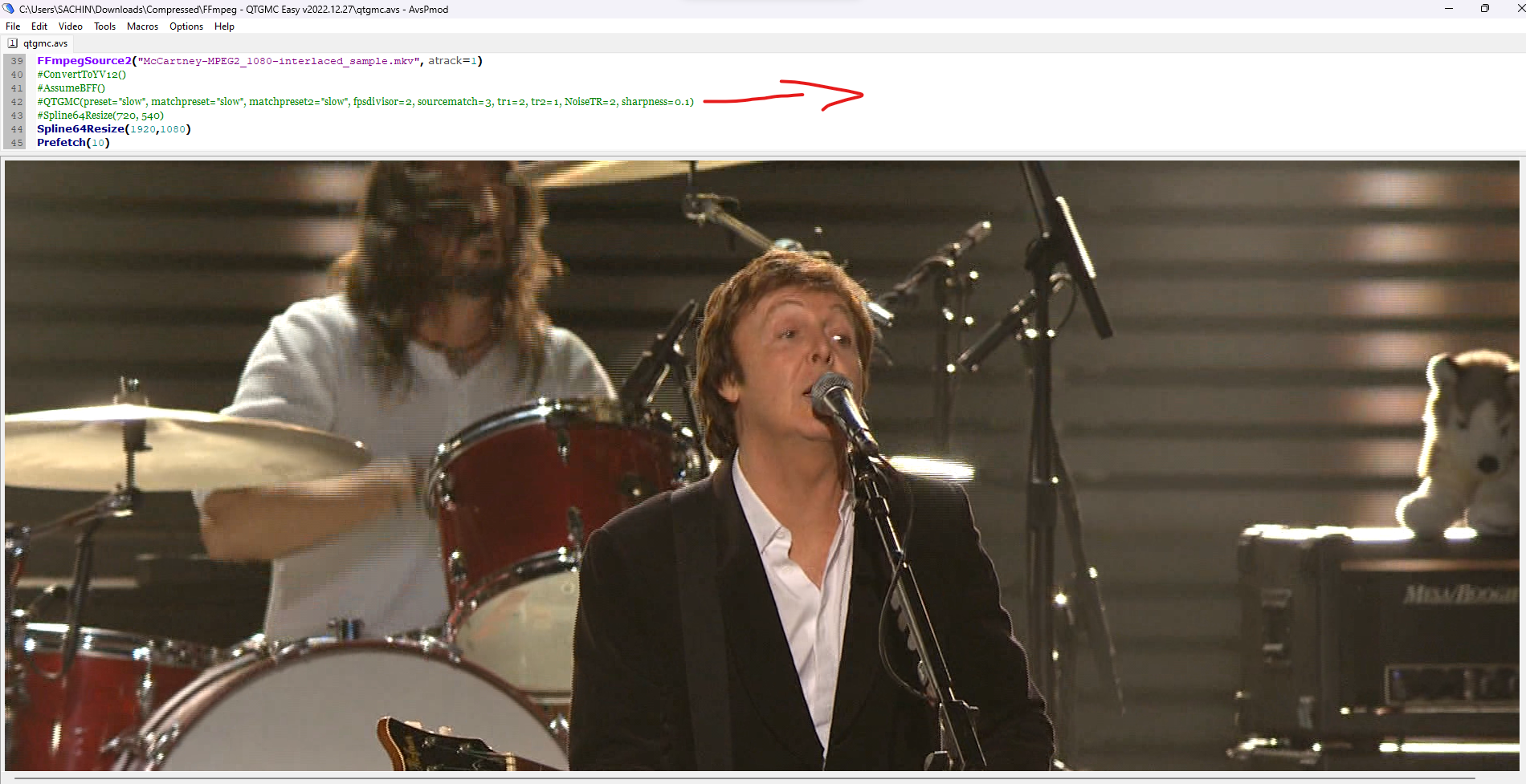

    BUt still not getting the proper result. PLease find the attached copies of the video which i am trying to test QTGMC.

  4. Your before&after show different frames. The 'before' has combing artifacts the 'after' not, so QTGMC does seem to do its job.
    You won't get rid of those ugly transmission and compression artifacts with QTGMC.
    Would need a sample to give good advice on that, but SpotLess, RemoteDirtMC and similar or ai based stuff like BasicVSR++ (<- would require Vapoursynth and a fast NVIDA CPU) might help.

  5. I don't understand what you are trying to say could you please elaborate a little bit.Also, you mean to say that QTGMC is working on my machine. If yes then why the video looks too dirty or ugly as compared to the original video?
  6. The original will have the same artifacts, if you look at the same frames, which you did not.
    QTGMC is a bob deinterlaced, so it takes each field and interpolates each field to a frame, with fpsdivisor=2 you tell it to throw way half of the interpolated frames.
    If in your source, one field might be damaged and the other not (or not as much) and if you now throw away the frames that were interpolated from the more damaged frames the output might seem more damaged, but in truth it is not.
    http://avisynth.nl/index.php/QTGMC
    Try what happens if you remove fpsdivisor=2 and add SelectOdd() below the QTGMC line. (iirc. by default QTGMC fpsdivisor=2 is the same as using SelectEven() after QTGMC)
