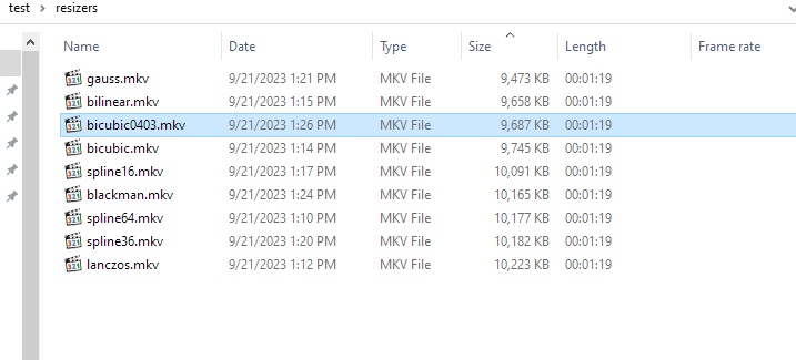

    Here's a small comparison to show different compressibility of the various resize options
  13. Member Skiller's Avatar
    Oct 2013
    Germany
    Those results are perfectly plausible and what is to be expected.
    One needs to pick the best compromise for the given bitrate somewhere between Gauss and Lanczos.
    If you want as few compression artifacts as possible and don't mind the soft picture, go for Gauss.
    If you need a good balance go for one of the recommended Bicubic variants. Bilinear may produce rather obvious scaling artifacts occasionally, especially with small details.
