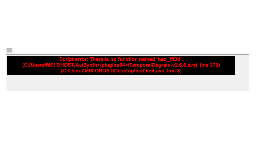

    I'm trying to use the TemporalDegrain2 filter, but I get this script error, what can I do?

  2. Just Google the error, and add "avisynth" to the search term
    "avisynth neo_fft3d"
    https://github.com/HomeOfAviSynthPlusEvolution/neo_FFT3D
  3. Originally Posted by poisondeathray View Post

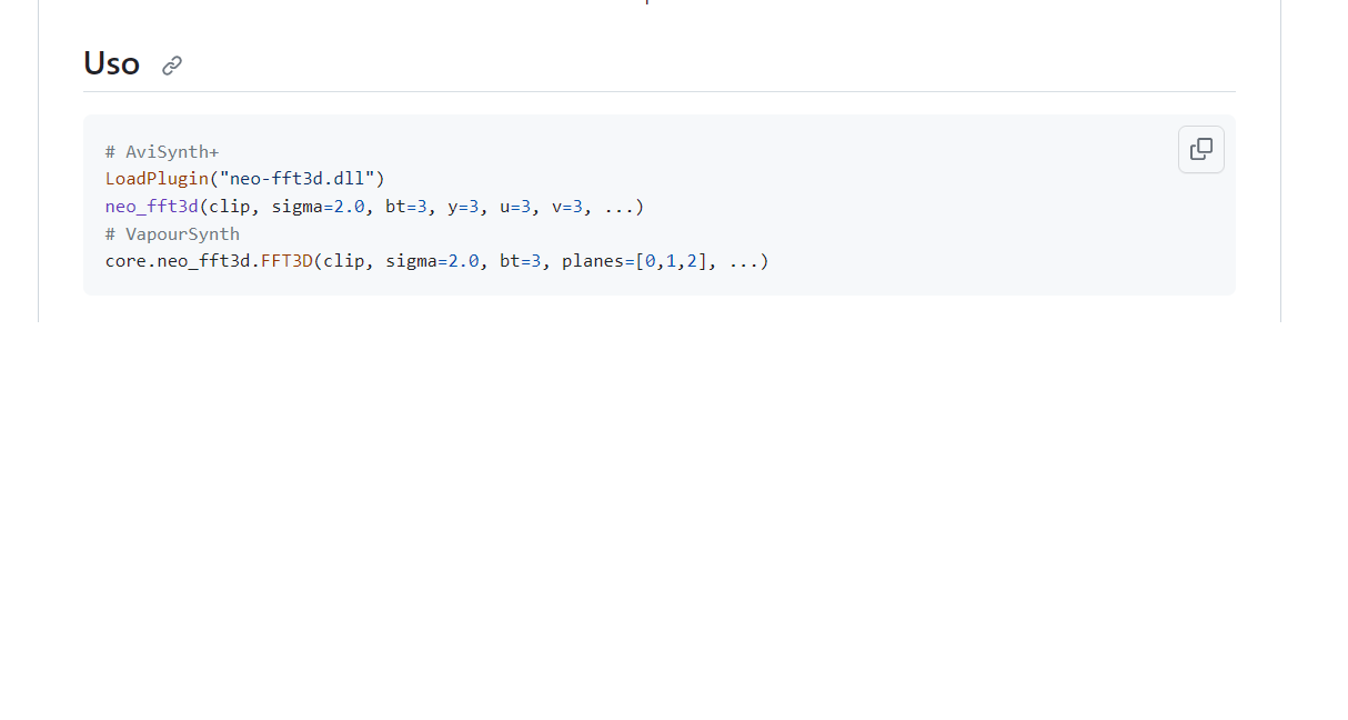

    Sorry but I couldn't understand, to be able to run the filter, do I need to paste this script from the attached image? Because I tried to do this but the same error still appears, could you please explain it to me?

    Mar 2008
    get the package from here:
    https://github.com/HomeOfAviSynthPlusEvolution/neo_FFT3D/releases
    Extract the files and place the 32 and 64 bit dll's in the respective Avisynth plugin folders
  5. Originally Posted by davexnet View Post
    Thanks! =)
