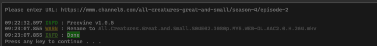

    for CH5 All Creatures Great and Small S04E01,
    it take me complete download, decrypted, Muxing and cleaning files in 1 min 17 sec. im on v1.0.4
    my pc 13th Gen intel(R) Core(TM) i9-13900H (20 CPUs), ~2.6GHz

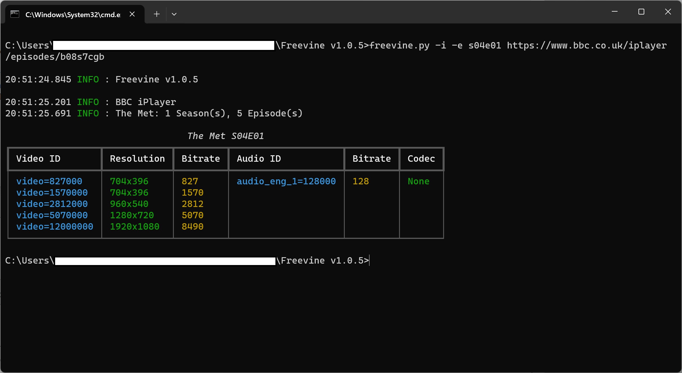

  17. This is very odd,... I'm getting the same error with a prog from the iplayer...
    02:34:41.445 INFO : Freevine v1.0.5
    02:34:41.863 INFO : BBC iPlayer
    02:34:42.949 INFO : The Met S04E05
    path empty or file not exists!
    my second attempt - using the following command - C:\freevine-1.0.0>freevine.py -i -e https://www.bbc.co.uk/programmes/b08s7cgb
    02:38:19.910 INFO : Freevine v1.0.5
    02:38:20.342 INFO : BBC iPlayer
    File "C:\freevine-1.0.0\freevine.py", line 65, in <module>
    main()
    File "C:\Users\xxxxxxxxxx\AppData\Local\Programs\Python \Python311\Lib\site-packages\click\core.py", line 1157, in __call__
    return self.main(*args, **kwargs)
    File "C:\Users\xxxxxxxxxx\AppData\Local\Programs\Python \Python311\Lib\site-packages\click\core.py", line 1078, in main
    rv = self.invoke(ctx)
    File "C:\Users\xxxxxxxxxx\AppData\Local\Programs\Python \Python311\Lib\site-packages\click\core.py", line 1434, in invoke
    return ctx.invoke(self.callback, **ctx.params)
    File "C:\Users\xxxxxxxxxx\AppData\Local\Programs\Python \Python311\Lib\site-packages\click\core.py", line 783, in invoke
    return __callback(*args, **kwargs)
    File "C:\freevine-1.0.0\freevine.py", line 59, in main
    Service(main_config, srvc_api, srvc_config, **kwargs)
    File "C:\freevine-1.0.0\services\bbciplayer\bbciplayer.py", line 47, in __init__
    self.get_options()
    File "C:\freevine-1.0.0\services\bbciplayer\bbciplayer.py", line 332, in get_options
    downloads, title = self.get_episode_from_url(self.episode)
    File "C:\freevine-1.0.0\services\bbciplayer\bbciplayer.py", line 286, in get_episode_from_url
    ).group(1)
    AttributeError: 'NoneType' object has no attribute 'group'
    So I thought i would just try to get a single episode if I cannot get the full season:
    freevine.py -s https://www.bbc.co.uk/iplayer/episode/m001sp70
    C:\freevine-1.0.0>freevine.py -s https://www.bbc.co.uk/iplayer/episode/m001sp70
    02:45:29.841 INFO : Freevine v1.0.5
    02:45:30.133 ERROR : Service is not supported
    C:\freevine-1.0.0>
    next attempt, a search...
    C:\freevine-1.0.0>freevine.py --search BBC "the met"
    02:47:57.783 INFO : Freevine v1.0.5
    BBC iPlayer
    Title: The Met
    Type: programme
    Synopsis: Documentary following the officers of Britain's biggest and busiest police service.
    Link: https://www.bbc.co.uk/iplayer/episodes/b08s7cgb
    okay that works perfect..
    now to try and get the full season:
    freevine.py -c https://www.bbc.co.uk/iplayer/episodes/b08s7cgb (at last, got it to work)

  23. Member
    Dec 2021
    england
    if you add -i on tv series, you will need to add season/episodes number
    [Attachment 75115 - Click to enlarge]
    to download complete season 4
    [Attachment 75116 - Click to enlarge]
