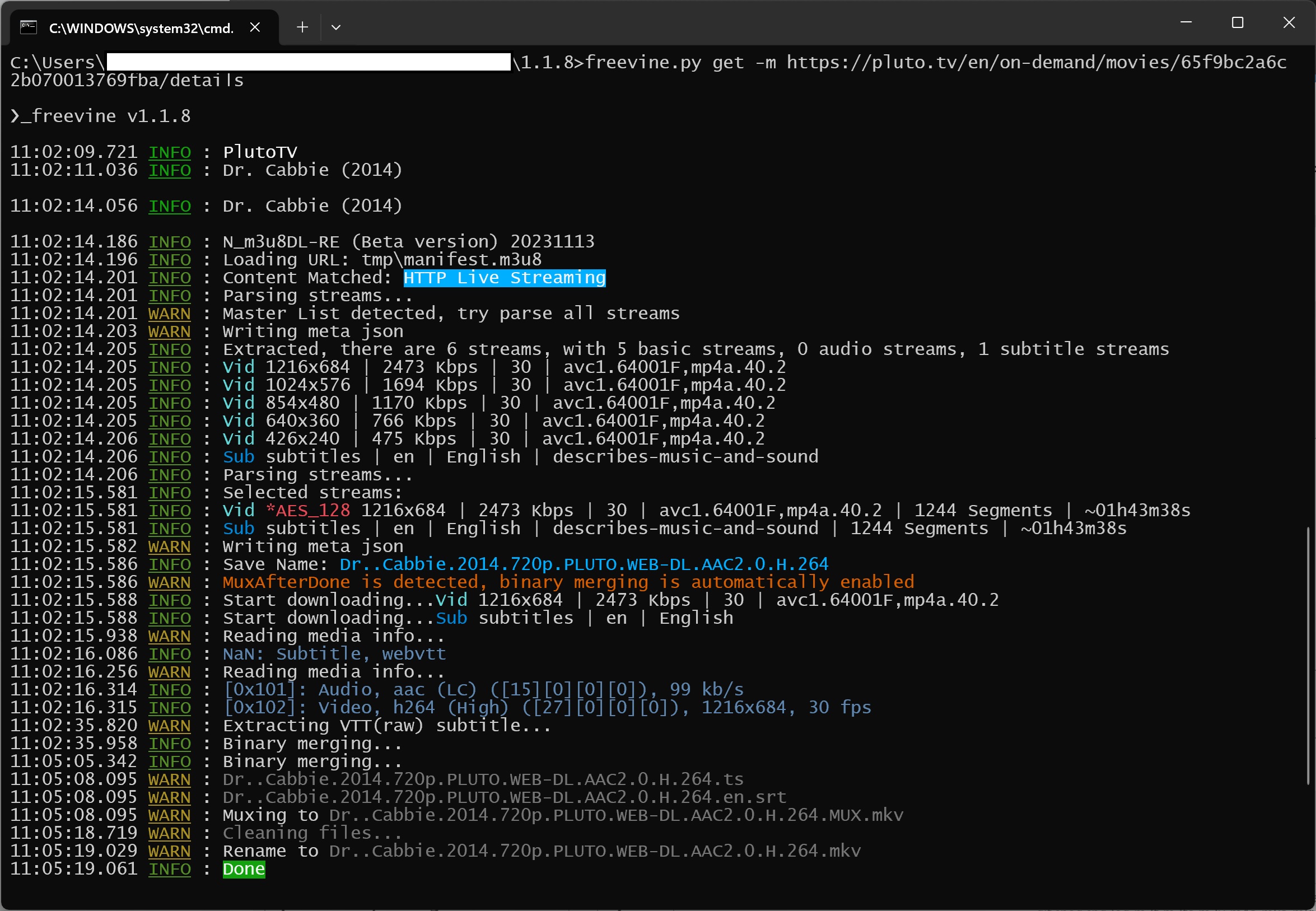

  11. Is anyone having trouble getting movies from PlutoTV:
    Microsoft Windows [Version 10.0.22631.3447]
    (c) Microsoft Corporation. All rights reserved.
    C:\freevine-1.1.8>freevine.py get -i -m https://pluto.tv/on-demand/movies/60d0b4c0e301960013dbbcc1/details
    ❯_freevine v1.1.8
    15:12:56.653 INFO : PlutoTV
    15:13:09.834 INFO : Movies([], key=<function Movies.__init__.<locals>.<lambda> at 0x00000144C2EC4540>)
    15:13:09.834 ERROR : Requested data returned empty. See 'get --help' for more information
    C:\freevine-1.1.8>freevine.py get -i -m freevine.py get -sv res=480 -m https://pluto.tv/on-demand/movies/60d0b4c0e301960013dbbcc1/details
    ❯_freevine v1.1.8
    Usage: freevine.py get [OPTIONS] [URL]
    Try 'freevine.py get --help' for help.
    Error: Got unexpected extra arguments (get https://pluto.tv/on-demand/movies/60d0b4c0e301960013dbbcc1/details)
    C:\freevine-1.1.8>freevine.py get -sv res=480 -m https://pluto.tv/on-demand/movies/60d0b4c0e301960013dbbcc1/details
    ❯_freevine v1.1.8
    15:15:39.371 INFO : PlutoTV
    15:15:52.428 INFO : Movies([], key=<function Movies.__init__.<locals>.<lambda> at 0x00000202137A4720>)
    15:15:52.428 ERROR : Requested data returned empty. See 'get --help' for more information
    C:\freevine-1.1.8>freevine.py get -sv res=432 -m https://pluto.tv/on-demand/movies/60d0b4c0e301960013dbbcc1/details
    ❯_freevine v1.1.8
    15:17:11.862 INFO : PlutoTV
    15:17:24.886 INFO : Movies([], key=<function Movies.__init__.<locals>.<lambda> at 0x000002DF2C584860>)
    15:17:24.890 ERROR : Requested data returned empty. See 'get --help' for more information
    C:\freevine-1.1.8>
    I did have success getting season three and four of "Maude" recently from Pluto TV United States.

    nothing wrong on my side
    C:\Users\Admin\1.1.8>freevine.py get -i -m https://pluto.tv/us/on-demand/movies/60d0b4c0e301960013dbbcc1/details
    ❯_freevine v1.1.8
    21:15:49.204 INFO : PlutoTV
    21:15:50.147 INFO : Ghost (1990)
    21:15:55.123 INFO : Ghost (1990)
    21:15:55.261 INFO : N_m3u8DL-RE (Beta version) 20231113
    21:15:55.271 INFO : Loading URL: http://silo-hybrik.pluto.tv.s3.amazonaws.com/995_Paramount_Pictures_LF/clip/60d0b4bee301960013dbbcbc_Ghost/720p/20220722_121324/hls/0-end/master.m3u8
    21:15:55.579 INFO : Content Matched: HTTP Live Streaming
    21:15:55.580 INFO : Parsing streams...
    21:15:55.580 WARN : Master List detected, try parse all streams
    21:15:55.582 INFO : Extracted, there are 6 streams, with 5 basic streams, 0 audio streams, 1 subtitle streams
    21:15:55.583 INFO : Vid 1280x720 | 2285 Kbps | 30 | avc1.64001f,mp4a.40.2
    21:15:55.583 INFO : Vid 854x480 | 1739 Kbps | 30 | avc1.64001f,mp4a.40.2
    21:15:55.584 INFO : Vid 854x480 | 1142 Kbps | 30 | avc1.64001f,mp4a.40.2
    21:15:55.584 INFO : Vid 640x360 | 741 Kbps | 30 | avc1.64001f,mp4a.40.2

    Dr. Cabbie
    search:
        PlutoTV
        Title: Dr. Cabbie
        Type: movie
        Synopsis: None
        Link: https://pluto.tv/en/on-demand/movies/65f9bc2a6c2b070013769fba/details
    look like your movie url have miss "en"
    download is working
    [Attachment 78879 - Click to enlarge]

    Thank you and I did some experimenting and was able to get "Dr. Cabby" thanks to you pointing out that about the url. I would like to learn more about the search function in freevine.
