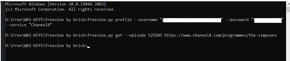

  3. Hi deccavox, nice to see you again and thanks for the assist. I was able to download from itv but with channel4 I got an error "required credentials were not found". That led me to the 'profile' command which I hope was accepted OK (the cmd screen just went straight to a new prompt). The password for channel4 is your email address. I then attempted a download from channel4 but nothing happened except an immediate jump to a new prompt.
    Pic attached. Can anyone suggest what my issue is? Many thanks.
Name:	freevine error2.jpg
  4. you need to be registered with channel4 (4od)... once registered with an email address and username these will be your own personal credentials.
    These are required for your profile.
    https://www.channel4.com/sign-in-or-register

  7. Originally Posted by LastResort View Post
    It looks like two posts above followed the rule except --service "All4"

  11. Originally Posted by Spectrumhsm View Post
    It looks like two posts above followed the rule except --service "All4" [as opposed to "Channel4"]
    This was weird... I re-entered the 'profile' command using "All4" and then tried downloading a Channel4 show. Both times the cmd screen just went straight to awaiting a new command. I then tried to d/l an itv show (which I'd successfully done earlier in the day). Same thing! Suddenly, I can't d/l anything.
    I don't know what made me do it but I opened the freevine.py file with Notepad (which I'd done at the outset and was surprised at how little text it contained!). This time the file was completely blank. How the contents got deleted, I have no idea but after downloading a fresh copy of freevine.py my Channel4 credentials have been acknowledged and I've successfully downloaded a programme from both itv and C4. Happy days. This 'all-in-one' script is very good - well done, stabbedbybrick.
    Out of curiosity, I see from the profile.yaml file: "expiry: 2024-01-10 00:08:29.528000" Does that mean you've to enter credentials every day? Even though you're always logged in at Channel4?
    Thanks, Spectrumhsm, for your assist.

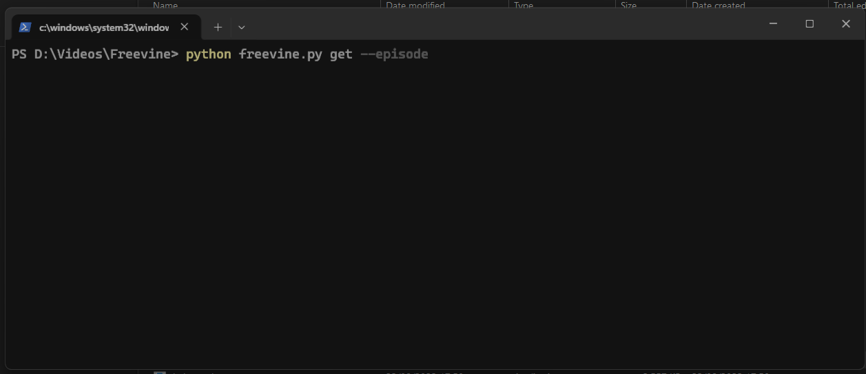

  17. Originally Posted by deccavox View Post
    I know this has nothing to do with freevine in particular, but I'd like to share a little trick I've been using for a few months now. When you're using venv's, especially when you've got lots of them all with different names, I always find it's a PITA to remember the activation script of 'name_of_venv\scripts\activate' and it also takes time to type it.
    So, I created a little batch script to do it (I am Windows). My venv name for freevine is 'fvine_venv':
    Open Notepad, copy into it:
    cmd /k ".\fvine_venv\scripts\activate"
    save it as a bat file (mine's called 'activate_venv.bat') in the folder that your working version of freevine is in.
    Now, to both open a cmd box and activate the venv, simply double click that bat file. Simples
    I tend to keep my venvs inside the folder of each app/script/whatnot, but for Freevine I have a little powershell command which automatically runs the venv and also has "python freevine.py get --episode" typed into the prompt for me so all I need to do is paste the URL of a new episode as that's my general usage, each morning grabbing the previous night's episodes of various things, if you want to try it the batch file I use is:
    @echo off
    cd D:\Videos\freevine\Scripts
    call activate.bat
    start powershell -NoExit -Command "$host.UI.RawUI.FlushInputBuffer(); $shell = New-Object -ComObject 'WScript.Shell'; $shell.SendKeys('python freevine.py get --episode ');"
    Obviously you'd need to change the path to wherever you have Freevine and your venv scripts
    For me it's saved as Run_Freevine.bat and when I double click that it shows:
    [Attachment 76141 - Click to enlarge]
    (the other advantage of this method is for whatever reason it remembers every command you have typed in previously so you can just use the up arrow key to scroll back through previous commands)

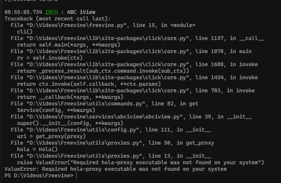

  25. Originally Posted by billybanana View Post
    Next configured the Hola proxy that stabby included as an option from v1.1.0+ and was successfully able to download an episode using the AU proxy with this command
    freevine.py get --episode  s01e01 https://iview.abc.net.au/show/grand-designs-transformations --proxy AU
    Are you using the latest version and have you tried the proxy ?
    I tried pulling the Hola git into the Freevine directory and I tried downloading hola-proxy.windows-amd64.exe but wasn't really sure where to put it so I ended up with:
    [Attachment 76176 - Click to enlarge]
    If there was any instruction how to properly setup and/or use Hola I must have missed it sorry!
  26. Member
    Oct 2023
    Afghanistan
    Rename the file to "hola-proxy.exe" and keep that in your main Freevine directory as you have said. That part of it wasn't crystal clear to me, so I just played around until it recognized the file. You only need that single file BTW not all the GitHub stuff.
  27. Originally Posted by billybanana View Post
    You're a star thank you! Between my three SmartDNS I can usually get everything I need but having the proxy option working is a good backup!

    Yeah, they'll be a part of the next release. Which should be released pretty soon, I think. I still have some improved functionality to add before pushing a new version.
    Nice to hear the cookies are working for you. They can be a great alternative to having to reverse engineer the entire login process.
  29. Originally Posted by billybanana View Post
    Hi Chaps,....
    Seeking some wisdom..
    and in particular ABC iview,....
    I'm in Oz. I use Privado VPN (comes as part of DNSfor4me) to access stuff that gives me issues. Experiment 1, so I connected to the US to deliberately break iView and got the "We apologise, due to rights restrictions this show is currently unavailable outside Australia." as expected.
    I'm still using 1.1.0.... and I have not tried --proxy
    I thought maybe ExpressVPN might be a good vpn to try, but they want money up front and one can trial it for 30 days. That's not really a trial, that's them taking money, for a product that is heavily advertised. Almost every website that I looked at that i thought was nothing to do with ExpressVPN was just another website designed to advertise their product. I asked their "Bot" how I could get my money back if the product did not work, the reply was "easy, just email us". My reply was, "No human, no cash". the 2 that I am tempted to trial are proton or windscribe. but I will try that --proxy first and see what happens.
