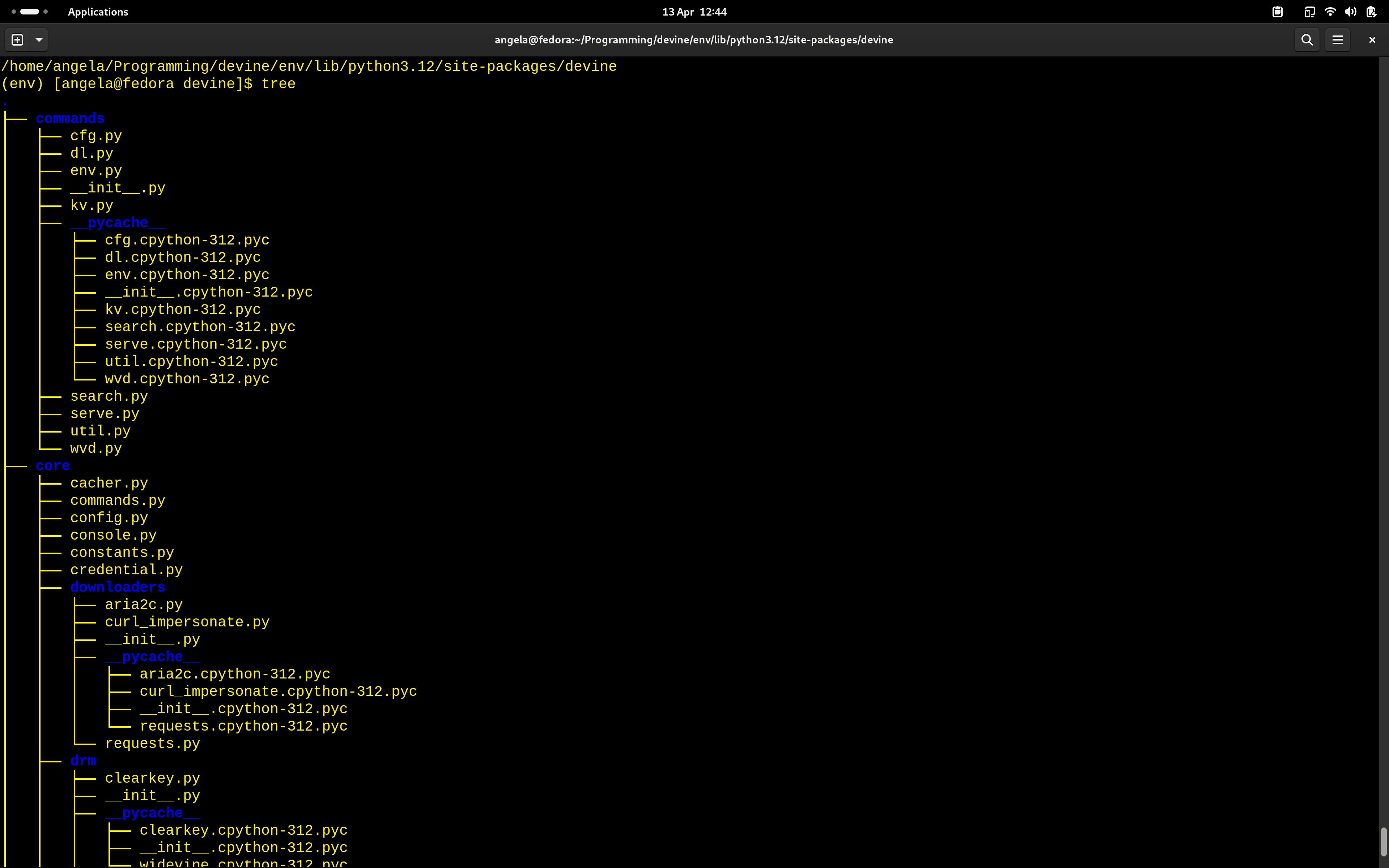

Not quite true. All devine's python code is accessible in the library /home/angela/Programming/devine/env/lib/python3.12/site-packages/devine (in my case)
[Attachment 78355 - Click to enlarge]
So there is nothing to lose with a simple install.

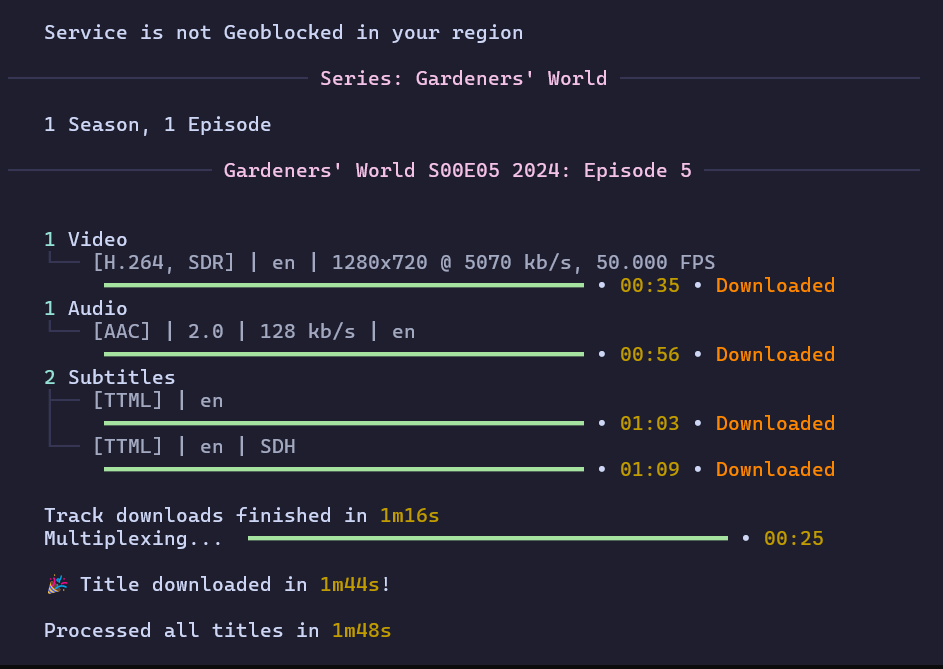

Still facing some issues with devine...
What's wrong here? Have I missed something during setup? The video gets properly decrypted, that's all fine...
Code:(venv) F:\devine>devine dl -q 720 iP https://www.bbc.co.uk/iplayer/episode/m001y5pf/gardeners-world-2024-episode-5 / __ \/ ____/ | / / _/ | / / ____/ / / / / __/ | | / // // |/ / __/ / /_/ / /___ | |/ // // /| / /___ /_____/_____/ |___/___/_/ |_/_____/ ⠀ v3.3.1 Copyright © 2019-2024 rlaphoenix https://github.com/devine-dl/devine Service Config loaded Loaded Cdm Widevine CDM: xxxxxx Loaded 1 Vaults ─────────────────────────────── Service: iP ──────────────────────────────── Service is not Geoblocked in your region ───────────────────────── Series: Gardeners' World ───────────────────────── 1 Season, 1 Episode ───────────────── Gardeners' World S00E05 2024: Episode 5 ────────────────── 1 Video └── [H.264, SDR] | en | 1280x720 @ 5070 kb/s, 50.000 FPS ━━━━━━━━━━━━━━━━━━━━━━━━━━━━━━━━━━━━━━━━ • 20:31 • Downloaded 1 Audio └── [AAC] | 2.0 | 128 kb/s | en ━━━━━━━━━━━━━━━━━━━━━━━━━━━━━━━━━━━━━━━━ • 22:35 • Downloaded 2 Subtitles ├── [TTML] | en │ ━━━━━━━━━━━━━━━━━━━━━━━━━━━━━━━━━━━━━━━━ • 22:43 • Downloaded └── [TTML] | en | SDH ━━━━━━━━━━━━━━━━━━━━━━━━━━━━━━━━━━━━━━━━ • 22:51 • Downloaded Track downloads finished in 22m57s Multiplexing... ⠋ ━━━━━━━━━━━━━━━━━━━━━━━━━━━━━━━━━━━━━━━━ • ╭───────────────────── Traceback (most recent call last) ──────────────────────╮ │ c:\Python310\lib\runpy.py:196 in _run_module_as_main │ │ │ │ 193 │ main_globals = sys.modules["__main__"].__dict__ │ │ 194 │ if alter_argv: │ │ 195 │ │ sys.argv[0] = mod_spec.origin │ │ ❱ 196 │ return _run_code(code, main_globals, None, │ │ 197 │ │ │ │ │ "__main__", mod_spec) │ │ 198 │ │ 199 def run_module(mod_name, init_globals=None, │ │ │ │ c:\Python310\lib\runpy.py:86 in _run_code │ │ │ │ 83 │ │ │ │ │ __loader__ = loader, │ │ 84 │ │ │ │ │ __package__ = pkg_name, │ │ 85 │ │ │ │ │ __spec__ = mod_spec) │ │ ❱ 86 │ exec(code, run_globals) │ │ 87 │ return run_globals │ │ 88 │ │ 89 def _run_module_code(code, init_globals=None, │ │ │ │ in <module>:7 │ │ │ │ F:\devine\venv\lib\site-packages\click\core.py:1157 in __call__ │ │ │ │ F:\devine\venv\lib\site-packages\click\core.py:1078 in main │ │ │ │ F:\devine\venv\lib\site-packages\click\core.py:1688 in invoke │ │ │ │ F:\devine\venv\lib\site-packages\click\core.py:1688 in invoke │ │ │ │ F:\devine\venv\lib\site-packages\click\core.py:1657 in _process_result │ │ │ │ F:\devine\venv\lib\site-packages\click\core.py:783 in invoke │ │ │ │ F:\devine\venv\Lib\site-packages\devine\commands\dl.py:697 in result │ │ │ │ 694 │ │ │ │ │ ): │ │ 695 │ │ │ │ │ │ for task_id, task_tracks in multiplex_tasks: │ │ 696 │ │ │ │ │ │ │ progress.start_task(task_id) # TODO: Need │ │ ❱ 697 │ │ │ │ │ │ │ muxed_path, return_code = task_tracks.mux( │ │ 698 │ │ │ │ │ │ │ │ str(title), │ │ 699 │ │ │ │ │ │ │ │ progress=partial(progress.update, task │ │ 700 │ │ │ │ │ │ │ │ delete=False │ │ │ │ F:\devine\venv\lib\site-packages\devine\core\tracks\tracks.py:367 in mux │ │ │ │ 364 │ │ for st in self.subtitles: │ │ 365 │ │ │ if not st.path or not st.path.exists(): │ │ 366 │ │ │ │ raise ValueError("Text Track must be downloaded before │ │ ❱ 367 │ │ │ events.emit(events.Types.TRACK_MULTIPLEX, track=st) │ │ 368 │ │ │ default = bool(self.audio and is_close_match(st.language, │ │ 369 │ │ │ cl.extend([ │ │ 370 │ │ │ │ "--track-name", f"0:{st.get_track_name() or ''}", │ │ │ │ F:\devine\venv\lib\site-packages\devine\core\events.py:74 in emit │ │ │ │ 71 │ │ │ raise ValueError(f"Event type \"{event_type}\" is invalid") │ │ 72 │ │ │ │ 73 │ │ for callback in self.__subscriptions[event_type] + self.__ephem │ │ ❱ 74 │ │ │ callback(*args, **kwargs) │ │ 75 │ │ │ │ 76 │ │ self.__ephemeral[event_type].clear() │ │ 77 │ │ │ │ F:\devine\venv\Lib\site-packages\devine\commands\dl.py:358 in <lambda> │ │ │ │ 355 │ │ │ │ │ events.subscribe( │ │ 356 │ │ │ │ │ │ events.Types.TRACK_MULTIPLEX, │ │ 357 │ │ │ │ │ │ lambda track: ( │ │ ❱ 358 │ │ │ │ │ │ │ track.strip_hearing_impaired() │ │ 359 │ │ │ │ │ │ ) if track.id == non_sdh_sub.id else None │ │ 360 │ │ │ │ │ ) │ │ 361 │ │ │ │ F:\devine\venv\lib\site-packages\devine\core\tracks\subtitle.py:486 in │ │ strip_hearing_impaired │ │ │ │ 483 │ │ │ │ stdout=subprocess.DEVNULL │ │ 484 │ │ │ ) │ │ 485 │ │ else: │ │ ❱ 486 │ │ │ sub = Subtitles(self.path) │ │ 487 │ │ │ sub.filter( │ │ 488 │ │ │ │ rm_fonts=True, │ │ 489 │ │ │ │ rm_ast=True, │ │ │ │ F:\devine\venv\lib\site-packages\subtitle_filter\libs\subtitle.py:223 in │ │ __init__ │ │ │ │ 220 │ │ │ raise IOError('{} is not a file'.format(fpath)) │ │ 221 │ │ self._fullpath = fpath │ │ 222 │ │ if self.ext not in self.EXTENSIONS: │ │ ❱ 223 │ │ │ raise IOError('{} is not valid subtitle file: {}'.format(s │ │ 224 │ │ self._line_list = self._get_line_list() │ │ 225 │ │ self.subtitles = self._parse_subs() │ │ 226 │ ╰──────────────────────────────────────────────────────────────────────────────╯ OSError: F:\devine\temp\Subtitle_1a1308_stripped.ttml is not valid subtitle file: .ttml
devine dl -q 720 --s-lang en --sub-format srt iP https://www.bbc.co.uk/iplayer/e pisode/m001y5pf/gardeners-world-2024-episode-5

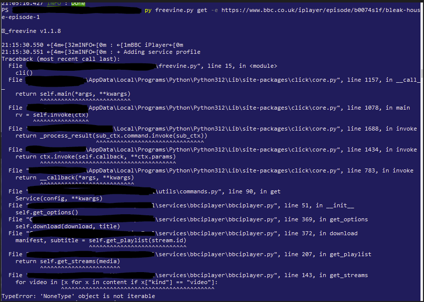

Hi,
Script has been doing me wonders Love it.
I have only come across one issue, I read through the code trying to see whether i could adjust it to fix the issue but had no luck.
I was grabbing Bleak House from BBCiPlayer and I can get every episode bar E01
I had to get the episodes one at a time with individual links - https://www.bbc.co.uk/iplayer/episode/b0074s1g/bleak-house-episode-2
Only E01 fails, and there is an unusual return when using --titles command. I think BBCiPlayer stores this particular series with different 'values'?!?
[Attachment 78413 - Click to enlarge]
If anyone can replicate or better still find a way around this issue, I would love to hear about it

Thanks, get-iplayer worked for me.
This episode is the only one downloaded with a different tool, so it has a larger file size amongst other differences.
I'll admit this bothers my ocd slightly so if anyone is able to get the .mpd or .m3u8 which I can put through N_m3u8DL-RE
https://www.bbc.co.uk/iplayer/episode/b0074s1f/bleak-house-episode-1
I would GREATLY appreciate it -
