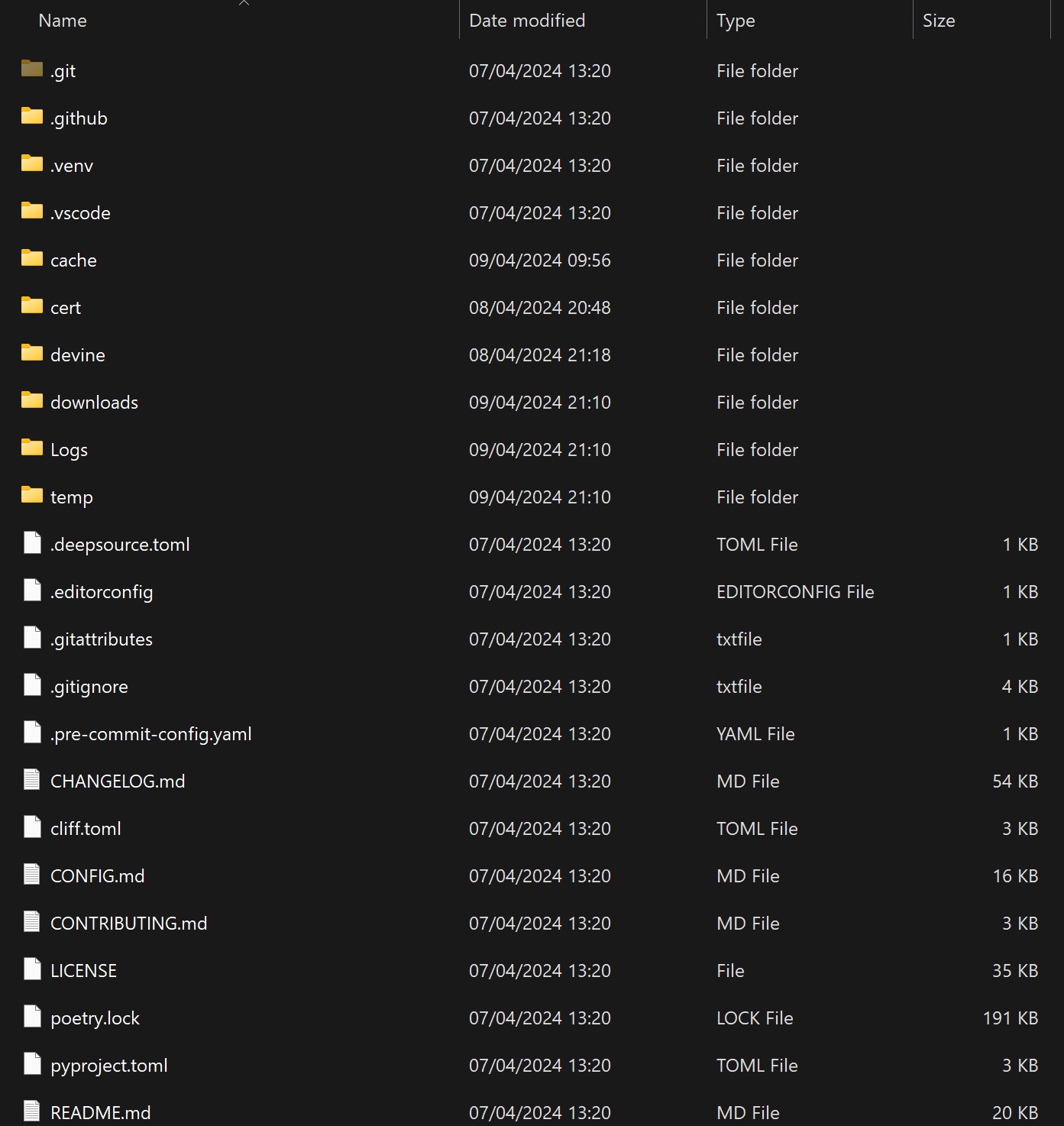

Since you are showing what looks like a full devine distribution, you likely downloaded a zip file and unzipped it. In which case, the suggested method to actually install devine is to do the following:
This will install devine in a virtual environment so any dependencies will not affect any other python projects you have. After those three commands, you should at least be able to type devine and something should execute.Code:poetry config virtualenvs.in-project true poetry install poetry shell
Of course, this is assuming poetry is installed but if you didn't at least have that, it would complain that poetry 'is not recognized as an internal or external command...'. -

2. Download and unzip devine: https://files.videohelp.com/u/301156/devine.zip
Put the devine folder somewhere convenient (I wouldn't recommend having too deep a folder structure).

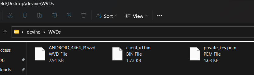

4. Copy/paste your .wvd file from your freevine to .\WVDs folder.
If you don't have a working wvd, see Angela's excellent instructions: https://forum.videohelp.com/threads/411862-Beyond-WKS-KEYS#post2708046

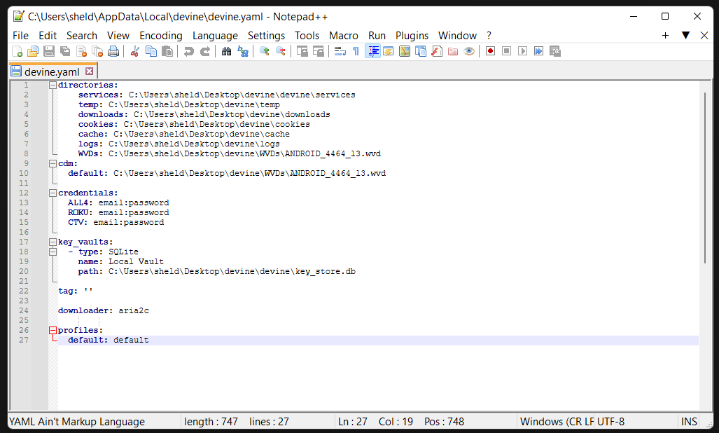

5. In .\devine\devine folder, open devine.yaml in Notepad++ or similar. You need to change settings/paths to suit youir setup. Here's mine:
Where yours may differ: I have put my devine folder in D:\. Swap that to your path setup.Code:directories: services: D:\devine\devine\services temp: D:\devine\temp downloads: D:\devine\downloads cookies: D:\devine\cookies cache: D:\devine\cache logs: D:\devine\Logs WVDs: D:\devine\WVDs\ANDROID_1111_l3.wvd cdm: default: ANDROID_1111_l3 credentials: ALL4: email:password # ROKU: email:password key_vaults: - type: SQLite name: Local Vault path: D:\devine\devine\key_store.db tag: '' downloader: aria2c profiles: default: default services: iP: cert: D:\devine\devine\certs\bbciplayer.pem
My WVDs number is made up, but at least you can get the gist.

4. It is best to put your .wvd in your /users/USER/AppData/Local directory instead of putting in your devine directory. The reason is to not put private user stuff in your devine directory. The best thing is to let devine handle the wvd for you. "devine wvd add WVD_FILE" will put it in the right place.
5. People need to stop reposting that copied/pasted devine.yaml. It's not "WVDs:" It must be "wvds:". lowercase. And the filename should not be included. It only works if it's "wvds: d:\devine\wvds". The only reason why your setup works is because below you say you copied your WVDs folder to /user/USER/AppData/Local/devine anyway. That line in your config file does nothing. It does not change where devine looks for the WVDs but does confuse people who keep copying/pasting this same wrong config.yaml.Last edited by achilles; 13th Apr 2024 at 07:37.
