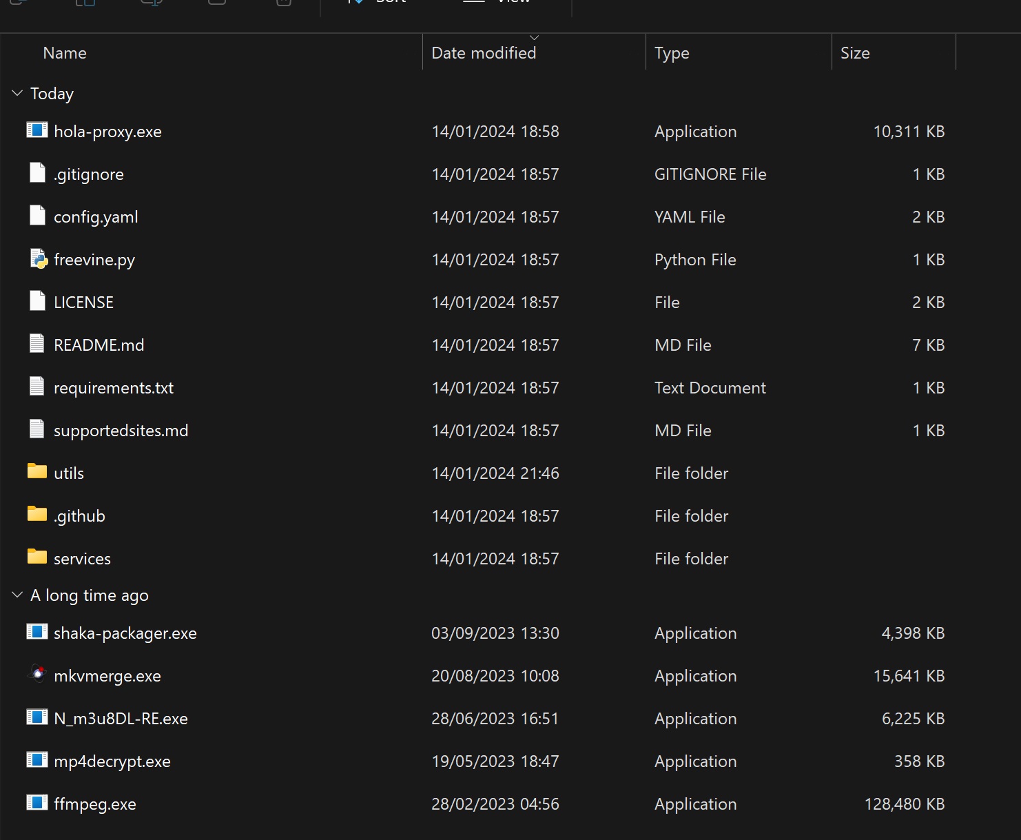

prepared everything,... downloaded hola-proxy.windows-amd64.exe renamed it to hola-proxy.exe (tried freevine script again but it said that hola was not found on my system)... please remember this is all trial and error.... decided to run hola-proxy.exe from v1.1.1 folder,... I now have a cmd window with this inside:
[Attachment 76193 - Click to enlarge]

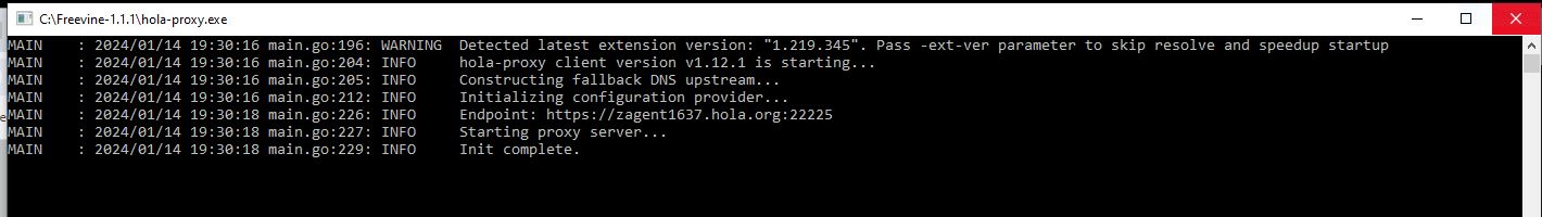

I'm guessing I leave this open and running,.... I also have cyberghost running in the background as well..
My test is going to be this:C:\Freevine-1.1.1>freevine.py get --movie https://iview.abc.net.au/show/search-for-the-palace-letters/video/ZW3711A001S00 --proxy AU
(It worked).... But I don't know if it's because I have cyberghost running using a brisbane location, or if it's because of hola-proxy????
because with cyberghost alone it will not work at all just says I am outside of australia.

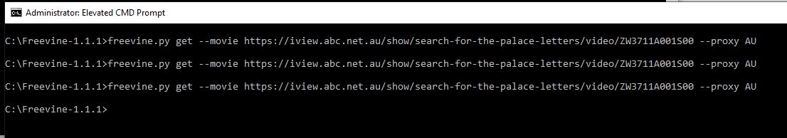

my tests now...
[Attachment 76194 - Click to enlarge]
each line has been run..... and nothing happens.
Never realised, but freevine.py was completely blank. That's why nothing was happening,... I read a few posts back that the same thing happened to someone else.

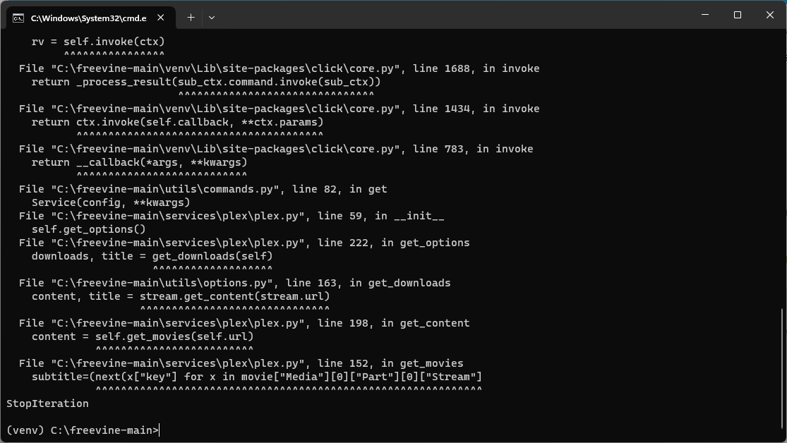

Tried 2 VPNs and 2 different SmartDNS and home internet for AU Plex and getting this error.
any idea
[Attachment 76208 - Click to enlarge]?
And yes, I know the movie is a cheesy pile of shit!(venv) C:\Users\beecl\Downloads\freevine-1.1.2>python freevine.py get -m https://watch.plex.tv/movie/the-slumber-party-massacre

Update: I think this is dependent on movie by movie. Some seem to throw the error where as some don't. What is the reason for this?Last edited by SE14man; 15th Jan 2024 at 01:41.
Apologies for pushing another version so soon, but there were a few issues that had to be fixed.
The "Video quality unavailable. Please select another resolution" has been fixed and things should work correctly now.
@SE14man:
The error's been fixed for Plex. Some movies and shows don't have subtitles, which is why it stopped. Should be working properly now. -

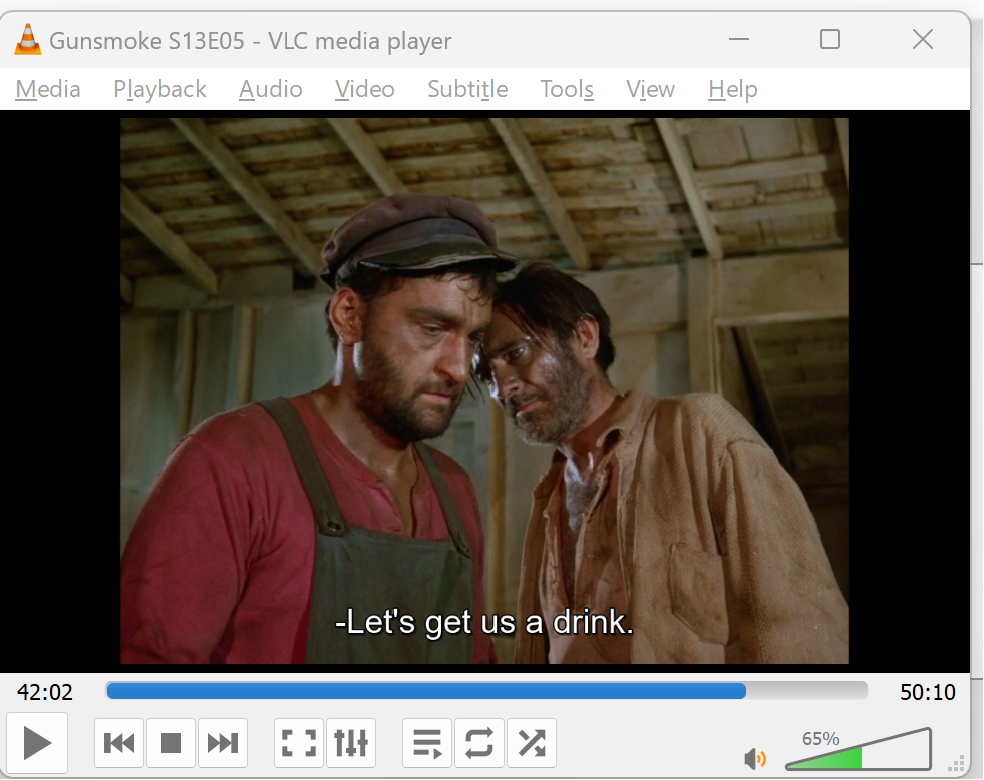

I did run to test:
Shows audio stream.Code:15:07:37.658 WARN : Master List detected, try parse all streams 15:07:37.661 WARN : Writing meta json 15:07:37.663 INFO : Extracted, there are 6 streams, with 5 basic streams, 0 audio streams, 1 subtitle streams 15:07:37.663 INFO : Vid 1280x720 | 2438 Kbps | 30 | avc1.64001f,mp4a.40.2 15:07:37.663 INFO : Vid 854x480 | 1742 Kbps | 30 | avc1.64001f,mp4a.40.2 15:07:37.663 INFO : Vid 854x480 | 1141 Kbps | 30 | avc1.64001f,mp4a.40.2 15:07:37.663 INFO : Vid 640x360 | 739 Kbps | 30 | avc1.64001f,mp4a.40.2 15:07:37.664 INFO : Vid 426x240 | 436 Kbps | 30 | avc1.64001f,mp4a.40.2 15:07:37.664 INFO : Sub subs | en | English 15:07:37.664 INFO : Parsing streams... 15:07:41.993 INFO : Selected streams: 15:07:41.993 INFO : Vid *AES_128 1280x720 | 2438 Kbps | 30 | avc1.64001f,mp4a.40.2 | 603 Segments | ~50m10s 15:07:41.994 INFO : Sub subs | en | English | 603 Segments | ~50m10s 15:07:41.994 WARN : Writing meta json 15:07:42.001 INFO : Save Name: Gunsmoke.S13E05.Vengeance.(Part.2).720p.PLUTO.WEB-DL.AAC2.0.H.264 15:07:42.001 WARN : MuxAfterDone is detected, binary merging is automatically enabled 15:07:42.002 INFO : Start downloading...Vid 1280x720 | 2438 Kbps | 30 | avc1.64001f,mp4a.40.2 15:07:42.002 INFO : Start downloading...Sub subs | en | English 15:07:42.092 WARN : Reading media info... 15:07:42.131 INFO : NaN: Subtitle, webvtt 15:07:42.275 WARN : Reading media info... 15:07:42.332 INFO : [0x100]: Video, h264 (High) ([27][0][0][0]), 1280x720, 30 fps 15:07:42.333 INFO : [0x101]: Audio, aac (LC) ([15][0][0][0]), 96 kb/s 15:07:45.238 WARN : Extracting VTT(raw) subtitle... 15:07:45.407 INFO : Binary merging... 15:07:57.051 INFO : Binary merging... 15:07:58.159 WARN : Gunsmoke.S13E05.Vengeance.(Part.2).720p.PLUTO.WEB-DL.AAC2.0.H.264.ts 15:07:58.160 WARN : Gunsmoke.S13E05.Vengeance.(Part.2).720p.PLUTO.WEB-DL.AAC2.0.H.264.en.srt 15:07:58.160 WARN : Muxing to Gunsmoke.S13E05.Vengeance.(Part.2).720p.PLUTO.WEB-DL.AAC2.0.H.264.MUX.mkv 15:08:11.514 WARN : Cleaning files... 15:08:11.609 WARN : Rename to Gunsmoke.S13E05.Vengeance.(Part.2).720p.PLUTO.WEB-DL.AAC2.0.H.264.mkv 15:08:11.610 INFO : Done
Played the video - looks good - video, audio and the subtitle.
[Attachment 76218 - Click to enlarge] -
Shows audio stream.
[Attachment 76218 - Click to enlarge][/QUOTE]
Spectrumhsm: Thank you for doing this test. I stopped my test when I saw that no audio was downloading and must have overlooked the line you pointed out. I will do a complete test as soon as my Sister is done with her Zoom Meeting. My Internet is DSL and is not all that fast so it is best to let her have her meeting without slowing it down to a crawl on her computer.
I downloaded the video and it turned out just fine. The audio is now in sync with the video. Thank you stabbedbybrick and to you as well.Last edited by Tom Saurus; 15th Jan 2024 at 17:07.
