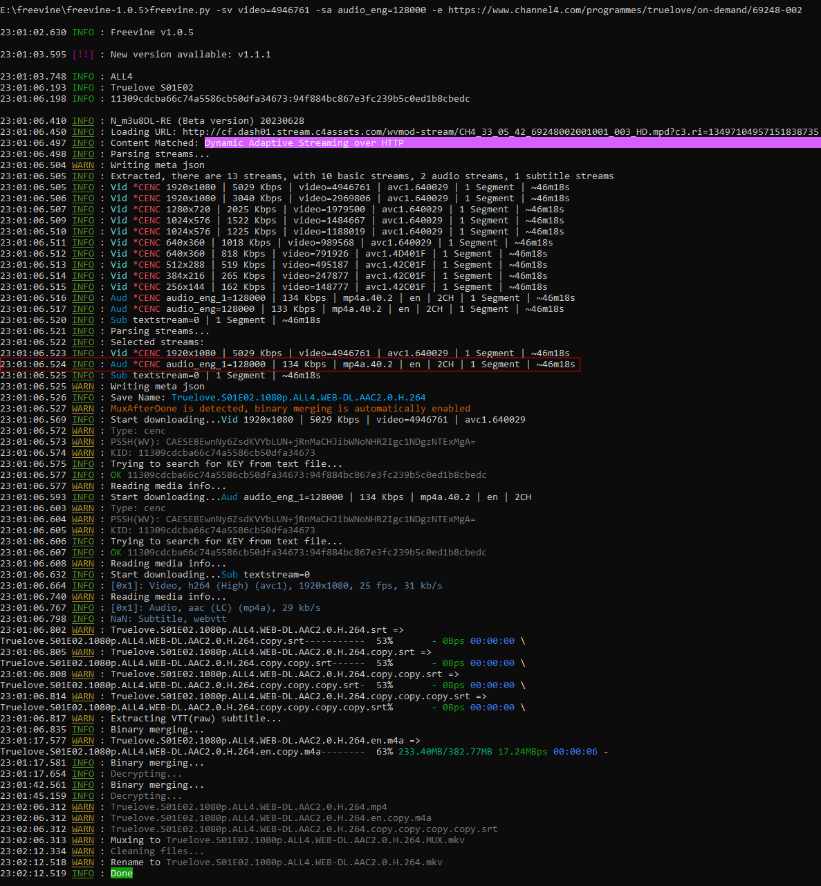

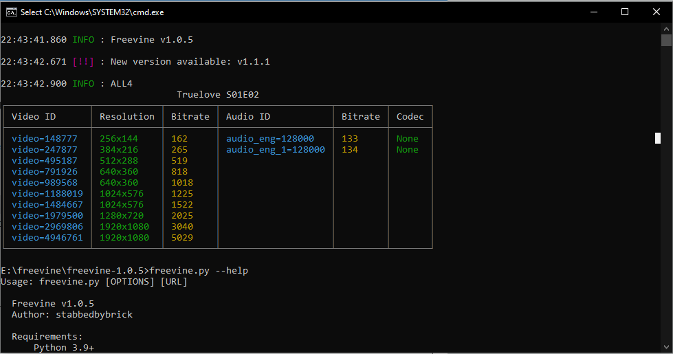

Seem to be having an issue with All4...I only get the AD Audio and not the standard.
The info shows:
[Attachment 75997 - Click to enlarge]
I have tried:
freevine.py -sv video=4946761 -sa audio_eng=128000 -e https://www.channel4.com/programmes/truelove/on-demand/69248-002
However my selection does not work...It pulls down the audio descriptive track still (notice the '_1' on the end). It doesn't seem to take any notice of my specific -sa audio_eng=128000 variable.
[Attachment 75998 - Click to enlarge]
Completely accept I am likely being stupid here
Ah, good call - I had a stray /services/channel4/api.yaml from 1.1.0 that was getting copied over (part of my Dockerbuild also copies keys etc. from the host when building).
I removed all that, and it's now a clean build using nothing but freevine cloned from github, required packages/libs/programs pulled from their respective original distribution sources, and with the only manual configuration being setting service uname/passwd as per the documentation (edit: and copying known working keys into ./utils/wvd/). Now I get:
Which appears to suggest failure of API endpoint auto-selection in my particular case (as mentioned previously, the android endpoint has never worked for me). Setting:Code:❯_freevine v1.1.1 23:46:27.788 INFO : ALL4 23:46:27.788 INFO : + Loading user profile 23:46:27.843 INFO : Cache is empty, aquiring new tokens... 23:46:27.843 INFO : Authenticating with service... 23:46:30.150 INFO : + New tokens placed in cache 23:46:32.987 INFO : Fresh Meat: 5 Season(s), 34 Episode(s) Traceback (most recent call last): File "/root/freevine-main/freevine.py", line 15, in <module> cli() File "/usr/local/lib/python3.10/dist-packages/click/core.py", line 1157, in __call__ return self.main(*args, **kwargs) File "/usr/local/lib/python3.10/dist-packages/click/core.py", line 1078, in main rv = self.invoke(ctx) File "/usr/local/lib/python3.10/dist-packages/click/core.py", line 1688, in invoke return _process_result(sub_ctx.command.invoke(sub_ctx)) File "/usr/local/lib/python3.10/dist-packages/click/core.py", line 1434, in invoke return ctx.invoke(self.callback, **ctx.params) File "/usr/local/lib/python3.10/dist-packages/click/core.py", line 783, in invoke return __callback(*args, **kwargs) File "/root/freevine-main/utils/commands.py", line 81, in get Service(config, **kwargs) File "/root/freevine-main/services/channel4/channel4.py", line 61, in __init__ self.get_options() File "/root/freevine-main/services/channel4/channel4.py", line 362, in get_options self.download(download, title, bearer) File "/root/freevine-main/services/channel4/channel4.py", line 365, in download self.res, manifest, token = self.get_mediainfo(stream.id, self.quality, bearer) File "/root/freevine-main/services/channel4/channel4.py", line 288, in get_mediainfo manifest, token = self.android_playlist(video_id, bearer) File "/root/freevine-main/services/channel4/channel4.py", line 263, in android_playlist raise ConnectionError(f"{r} {r.text}")ConnectionError: <Response [403]> {"code":10302,"message":"Programme playback blocked","description":"This programme is not available in your current location."}in api.yaml makes no difference; I assume that option was removed when the auto-selection code was added?Code:client: "web"
edit: Unrelated issue: UKTVPlay seem to have changed their series or title name fields recently - now files look like this:
in both 1.1.0 and 1.1.1Code:Great.British.Railway.Journeys.S01E16.Great.British.Railway.Journeys.S01E16.Buxton.to.Matlock.1080p.UKTV.WEB-DL.AAC2.0.H.264.mp4
Last edited by alberich_manus; 4th Jan 2024 at 20:27. Reason: Added clarification of details, and the unrelated UKTV title issue
[QUOTE=Sistema;2718587]Seem to be having an issue with All4...I only get the AD Audio and not the standard.
I had a problem with "Birds Of Prey" at TubiTV where it was getting the descriptive audio. I was advised and it worked for me when I applied the following: In the main yaml file go down to the audio settings it should look like this:
# Set audio options. See "N_m3u8DL-RE --morehelp select-audio" for guidance. Default: best
audio:
select: "for=best"
drop: "name=Description"
It may work for you with this issue perhaps not but you could always erase that line if it it didn't. I hope this remedies the situation for you.
"Fresh Meat" is available on TubiTV as well.Last edited by Tom Saurus; 4th Jan 2024 at 19:54.
If the parameters are the same as those accepted by N_m3u8dl-RE, then your problem is that after -sv and -sa you need to set the proper options ("audio_eng" isn't one of them):
In your case this should work:Code:id=REGEX:lang=REGEX:name=REGEX:codec=REGEX:res=REGEX:frame=REGEX segsMin=number:segsMax=number:ch=REGEX:range=REGEX:url=REGEX plistDurMin=hms:plistDurMax=hms:for=FOR
It may seem confusing but "audio_eng=128000" is the whole value here, it's not like "128000" is the value and "audio_eng" the option. And yes, that's on them for making it so confusing.Code:-sv id=video=4946761 -sa id=audio_eng=128000

Is there no way to get the list of stream IDs with newer versions of freevine?
With older versions you'd do, for example:
And it'd spit out the nice table listing the audio and video streams, and their IDs.Code:# python3.11 freevine.py -i -e S03E02 https://gem.cbc.ca/best-in-miniature/s03
The first version I used was 1.10 and it (and now 1.1.1) don't appear to have that functionality.
I can do:
And it'll list the streams, but it doesn't tell you the stream IDs so you can't pass them to N_m3u8DL-RE to extract the ones you want.Code:# python3.11 freevine.py get --info --episode S03E02 https://gem.cbc.ca/best-in-miniature/s03
It will list IDs if there are any, but CBC doesn't have any video IDs. You need to use other regex to specify, like res="".
