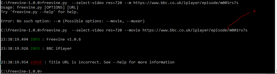

    its not episode
    remove --episode, add -m
  2. So your saying fetch movie... this is what i had returned iamghost..
    [Attachment 75439 - Click to enlarge]
    very odd...
    I got it to work... I find the beeb really aggravating.
    [Attachment 75440 - Click to enlarge]
    Placing the letter "s" as shown and everything is okay.

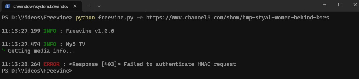

  14. Is anyone else seeing the same issues with MY5 today please?
    Edit: Ignore that, working now, no idea what the issue was, sorry!

  15. @Grimbarian:
    Try again now. The hmac updater hadn't run for a few days for some reason.
  16. Originally Posted by stabbedbybrick View Post
    @Grimbarian:
    Ahh thank you so much! Was convinced I was the problem! Yep as per my edit it's working perfectly now
