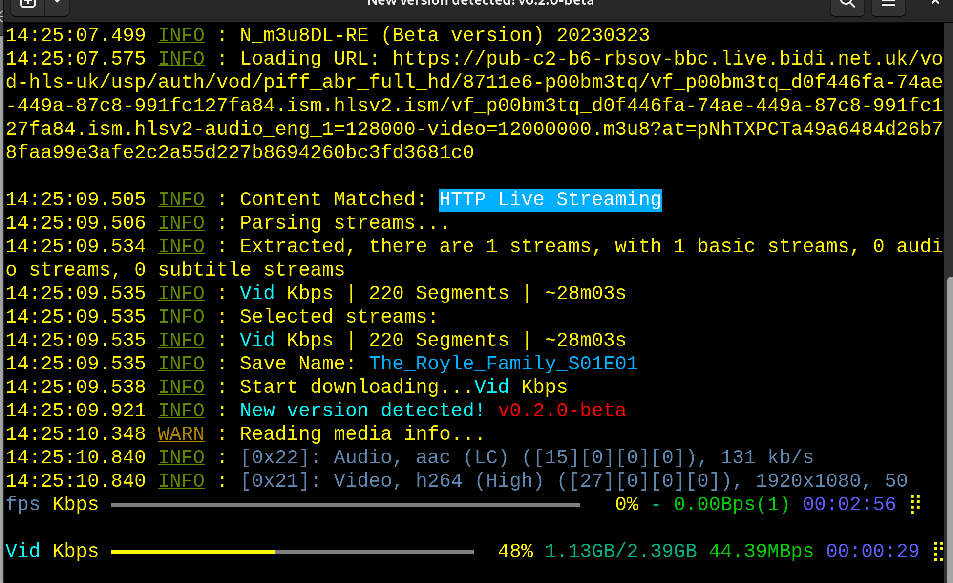

Sorry to keep pulling up issues with iPlayer, but I feel like it is worth reporting them, could be my issues and not the program itself. I am getting this error (I am in the UK by the way, so shouldn't be any geo issues):
While downloading this: https://www.bbc.co.uk/iplayer/episode/p00bm3tp/the-royle-family-series-1-episode-1 (I am pretty sure 1080p isn't available, but it does show) if you need anything else from me please let me knowCode:Segment count check not pass, total: 446, downloaded: 445.
It is.
[Attachment 75297 - Click to enlarge]
but perhaps not from here.Noob Starter Pack. Just download every Widevine mpd! Not kidding!.

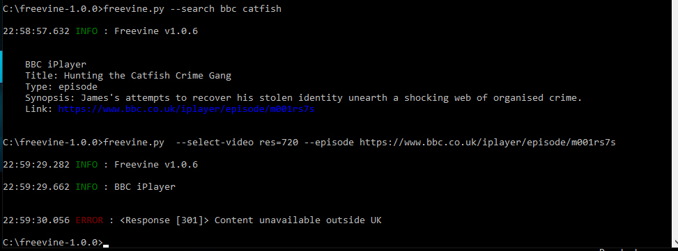

Hi Stabbed,..
A request needed above my knowledge..... A beeb problem.
The image is my search,,... followed by my request.... with the strangest of errors.. (i'm in the uk, and certainly not using a vpn.
[Attachment 75438 - Click to enlarge]
Any advice please.
