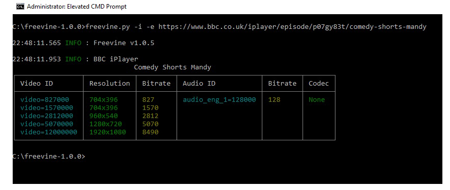

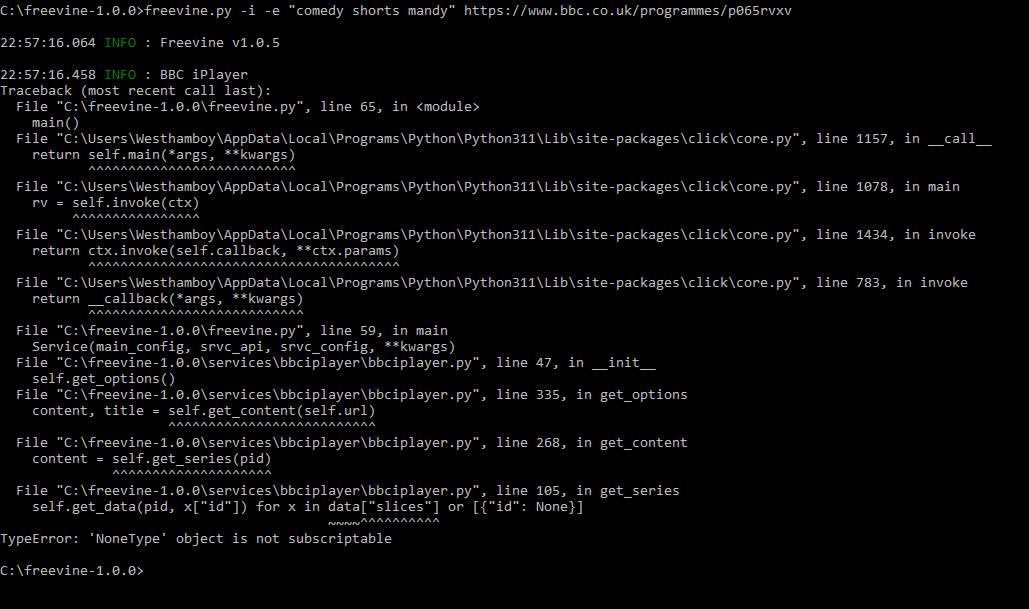

Thank you iamghost,..
freevine.py -i -e https://www.bbc.co.uk/iplayer/episode/p07gy83t/comedy-shorts-mandy (with episode link)
this gave me:
[Attachment 75165 - Click to enlarge]
freevine.py -i -e "comedy shorts mandy" https://www.bbc.co.uk/programmes/p065rvxv
this gave me:
[Attachment 75166 - Click to enlarge]

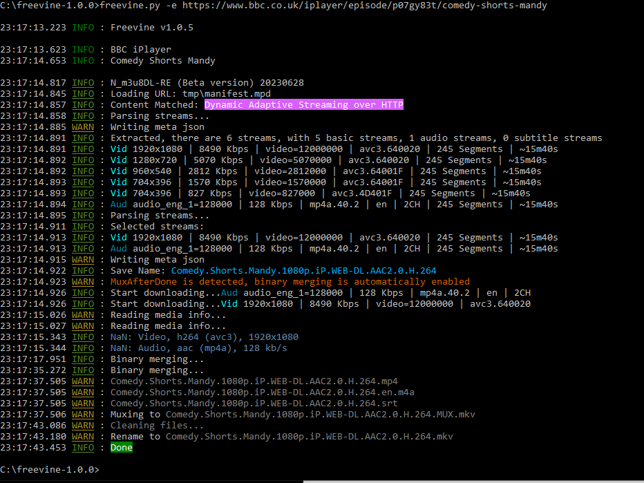

I have found the pid for this very small programme: p07gy83t
Doing a google search for https://www.google.com/search?q=bbc+p07gy83t&oq=bbc+p07gy83t&gs_lcrp=EgZjaHJvbWUyBggAE...hrome&ie=UTF-8
This shows the single episode in question.
Finally got it to work with the following:
C:\freevine-1.0.0>freevine.py -e https://www.bbc.co.uk/iplayer/episode/p07gy83t/comedy-shorts-mandy
[Attachment 75167 - Click to enlarge]Last edited by LastResort; 30th Nov 2023 at 18:23.

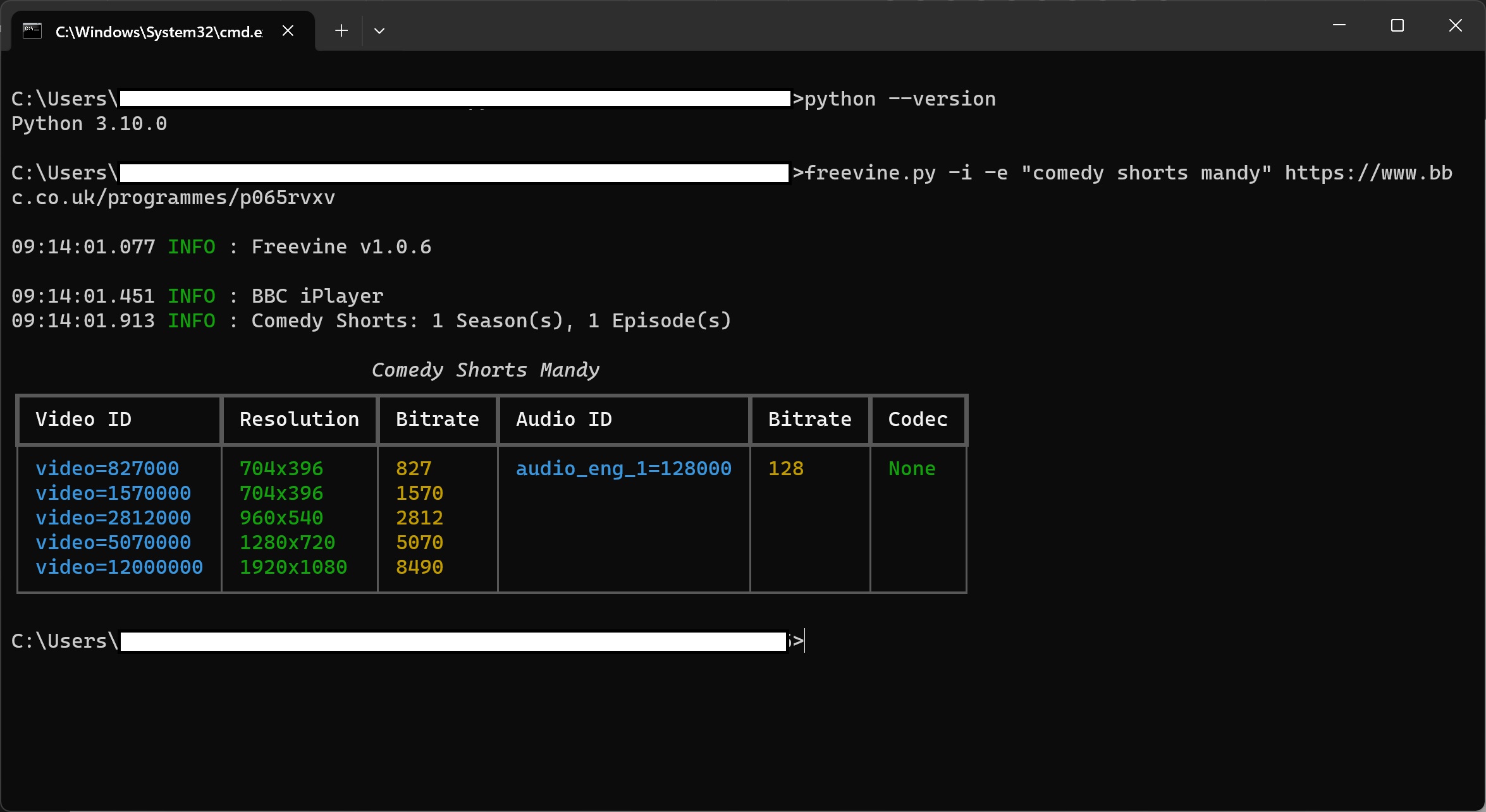

mine work fine
Code:freevine.py -i -e "comedy shorts mandy" https://www.bbc.co.uk/programmes/p065rvxv
[Attachment 75177 - Click to enlarge] -

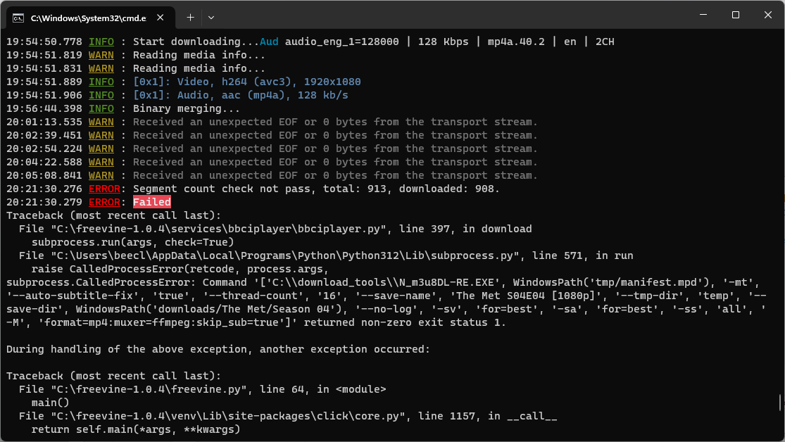

Been getting this same error all day. Lost count of how many times I tried. Seems to be a few episodes on various BBC iPlayer series it doesn't like. Used 3 different VPNs and 2 Smart DNS's and still same error thrown back.
Any ideas?
[Attachment 75229 - Click to enlarge]
(The Met Episode 4 of Series 4 in 1080) -
Worked 1st go for me. I'm using dns4me.net as my smartDNS service.
Code:18:05:52.469 INFO : Binary merging... 18:05:57.727 WARN : The.Met.S04E04.1080p.iP.WEB-DL.AAC2.0.H.264.mp4 18:05:57.728 WARN : The.Met.S04E04.1080p.iP.WEB-DL.AAC2.0.H.264.en.m4a 18:05:57.729 WARN : The.Met.S04E04.1080p.iP.WEB-DL.AAC2.0.H.264.srt 18:05:57.730 WARN : Muxing to The.Met.S04E04.1080p.iP.WEB-DL.AAC2.0.H.264.MUX.mkv 18:05:57.731 DEBUG: D:\Downloads\freevine-1.0.6\mkvmerge.exe: -q --output "downloads\The Met\Season 04\The.Met.S04E04.1080p.iP.WEB-DL.AAC2.0.H.264.MUX.mkv" --no-chapters --language 0:"und" "downloads\The Met\Season 04\The.Met.S04E04.1080p.iP.WEB-DL.AAC2.0.H.264.mp4" --language 0:"eng" --track-name 0:"English" "downloads\The Met\Season 04\The.Met.S04E04.1080p.iP.WEB-DL.AAC2.0.H.264.en.m4a" --language 0:"eng" --track-name 0:"English" "downloads\The Met\Season 04\The.Met.S04E04.1080p.iP.WEB-DL.AAC2.0.H.264.srt" 18:06:08.255 WARN : Cleaning files... 18:06:08.597 WARN : Rename to The.Met.S04E04.1080p.iP.WEB-DL.AAC2.0.H.264.mkv 18:06:08.716 INFO : Done
